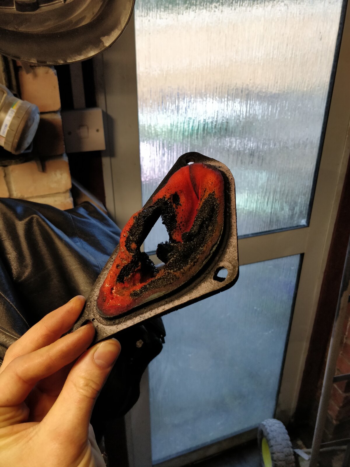

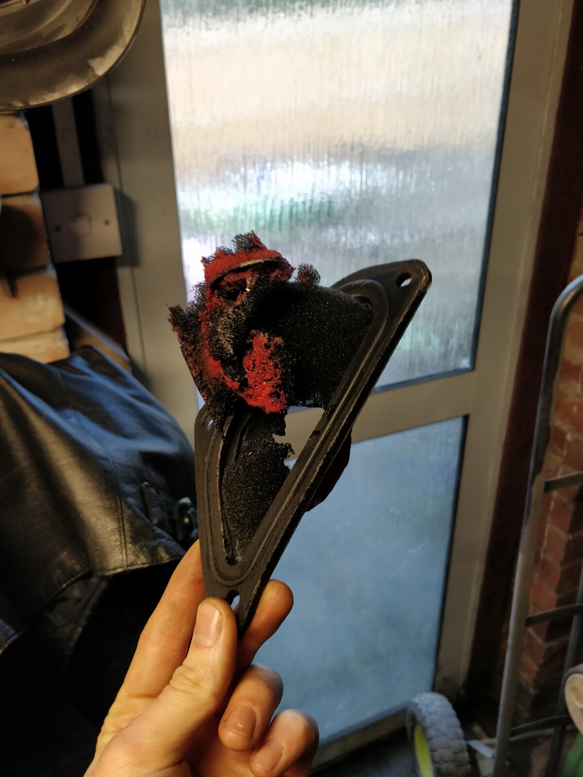

    Literally just put brand new pipercross air filters in, first crank over it backfires through the throttle bodies, blowing them out and melting them.. great day! IMG_20190317_145207.jpg

  11. Not good if they get destroyed that easily - worried what mine might be like after all sorts of backfiring along the road to getting it sorted.
    Just how bad was your backfire???
  12. The bike was cranking for about 10 seconds before it happened so it was probably 50 firing strokes worth of fuel? I knew about it!!, they melted completely
  13. How did you know if they were hidden inside the runners??

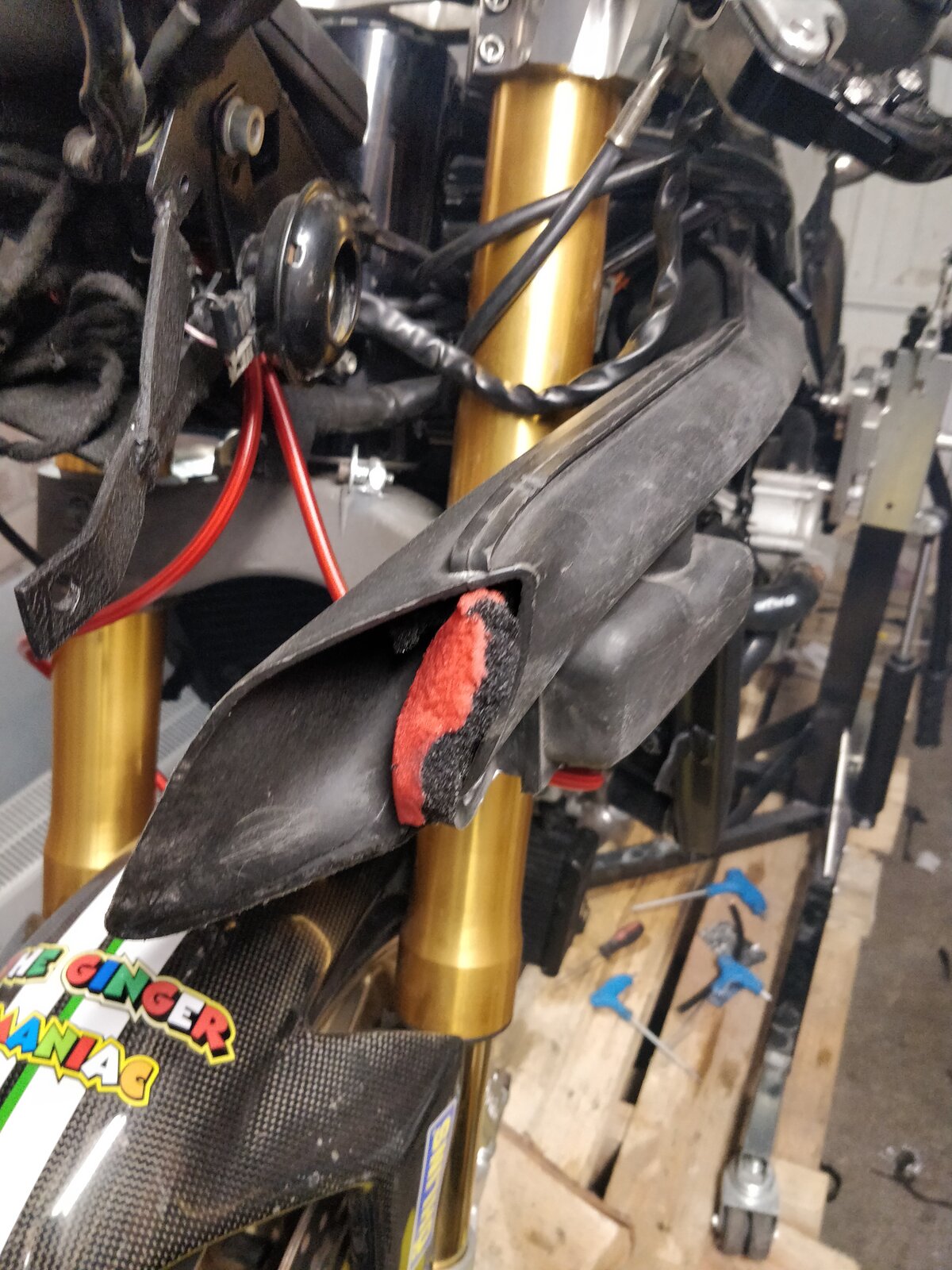

  14. All sorted now! Turns out the starter cable was too close to the crank position sensor and I'm guess it didn't like the emf. Runs like a champ now!
    Annoyed about the filters though....

  16. How come the position or routeing of the cable changed to produce the problem?
    Are you sure you didn’t do something else like tighten/wiggle the battery terminal or earthing point?
    I had very similar symptoms but the position of the cables didn’t change to produce them.

  18. It's not a standard 999, the loom is very different. I tried a new cable routing to make it neater but.. well, that didn't work! Aha
