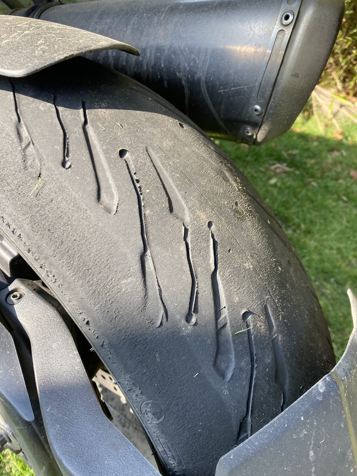

  10. In the last two years I've got through 5 sets of Road 5's, never tried the GT, with each set lasting between 3000 and 3700 miles, thought I'd give the Road 6 a go as they say they'll last a little longer. To make a tyre last longer the compound would need to be changed I'd presume, slightly harder compound maybe? I fit my own tyres and the first thing I noticed was the carcass and the sidewalls are a fair bit stiffer than the Road 5's, this was evident upon fitting. I can almost throw a Road 5 on to the rim, they are so flexible that just a smear of tyre soap and I can get both tyres on without levers, just use my hands and a rubber mallet, if required. The Road 6 took a load more effort, rim protectors and levers were needed.
    Bedded them in for 50 miles then rode like normal. The tyres a good but, they don't give the 'feel' of the R5, you don't get the same feedback from the front tyre when it's cranked over. Still great tyres, not a scary moment has been given. I think the rear will last around 3800 (ish) miles, just a couple of rides left in it, the front has worn better and may even do another rear but, I'll be going back to the R5 as, for me, they just inspire more confidence.

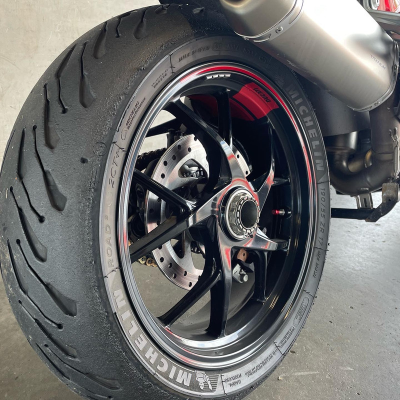

    I don’t bother balancing the rear, need to get some cones made for my balancer, never been an issue.
  16. Use cones with mine, balancer was from Max2H.com.
