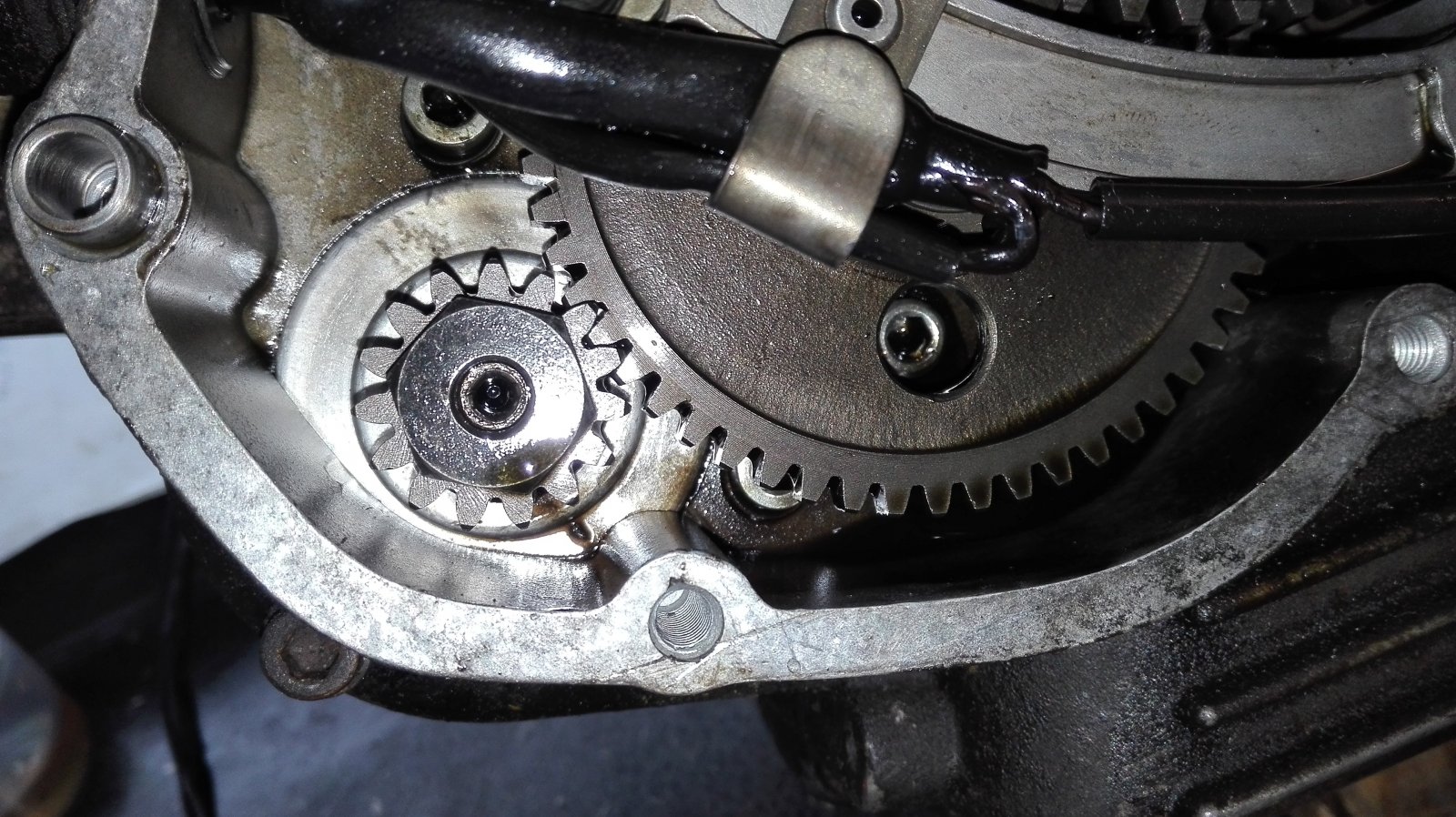

    Today, I thought I'd remove the starter and give it a paint to smarten it up. I was a bit disappointed to find that the starter intermediate pinion doesn't have a hole in it to allow access to the retaining screw behind it. I don't really want to remove the flywheel so that I can remove the intermediate gear so that I can get the screw out. :mad:
  17. This is very surprising. I have never seen an intermediate pinion without a hole for the starter screw. Are you sure? You have to turn the pinion round to find the hole!
    Incidentally, Pantah starters are a bit basic and need more than a coat of paint. The plain bush at the carbon brush end could do with a clean and a bit of grease (which is the only lubrication it is ever going to see). The commutator may well be full of carbon dust. The earthing connection screws are pretty feeble, and you might be able to replace them with more robust ones. Then give it a coat of black paint. Pantah starters are not the same as later Ducati models and cannot be interchanged.
  18. Well it's got holes Pete, but none of them seem to line up with the starter motor screw. Thanks for your advice on the starter, sounds like it would definitely be better taken off.
  19. IMG_20160404_103113.jpg Well the starter is off and I did have take off the flywheel and intermediate gear.
    As you can see from this photo the starter motor screw is directly behind the gear teeth, so no chance of getting it through a hole. So I'd better make sure the starter is good as I don't want to have to do that too often.
