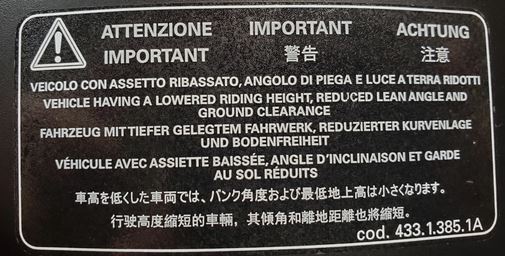

    There seems to be a lot of conjecture about the low version with some riders mentioning that even the dealers are confused or unaware of the model. I have read elsewhere that all 2016 models were the low version. I have a feeling that this isn't true. Part of the problem is trying to determine if you have one or not. My understanding is that the VIN will not help you. On my model, which was sold in Canada, it has a sticker mentioning that it is lowered.
    But from the multiple languages on the sticker, it would appear to have been sold in numerous countries.

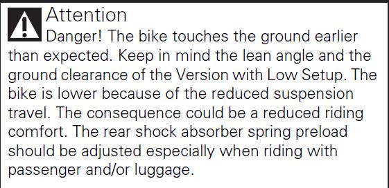

    The owner's manual i downloaded only has a precautionary mention of it.

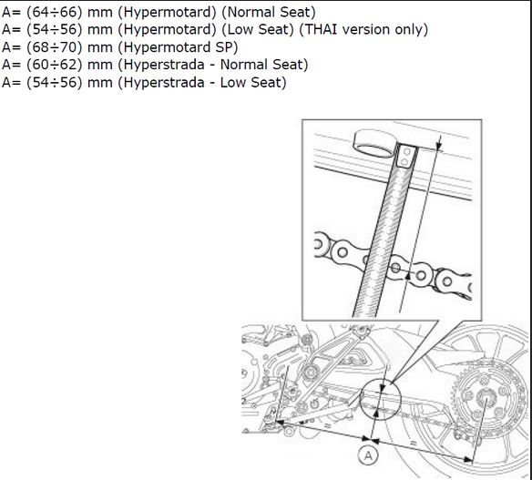

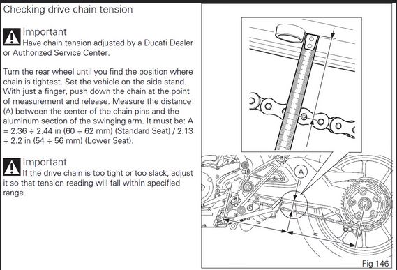

    However in the same owners manual, it does indicate a 'lower seat' model in the chain tension section.

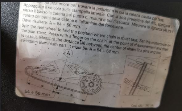

    The sticker attached to my swing arm indicates the tension desired which is the second and most conclusive indicator that I have a low model. The sticker matches the spec in the owner's manual.
    However, the service manual seems to identify that a low version Hyperstrada and a Thai model Hypermotard have the same specs. This I find somewhat confusing in that it implies that all Thai models are low versions and if so, why is it only specifically Thai models? What about other countries? Or maybe I'm easily confused and I'm overthinking things as I've had a very large coffee on an empty stomach. Anyone that can answer these questions, please feel free to do so.

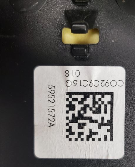

    The last indicator of having a low version is the seat which has a part number of 59521572A. But this is not wholly indicative that you have a low version, just a low seat.

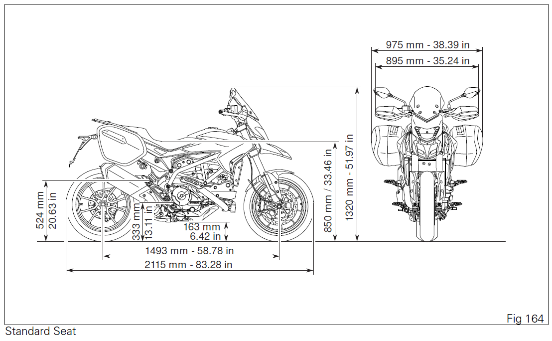

    I had something pointed out to me the other day much to my chagrin. The owners manual for a 2016 model gives specs to help you determine which model you have. Here's the differences.
