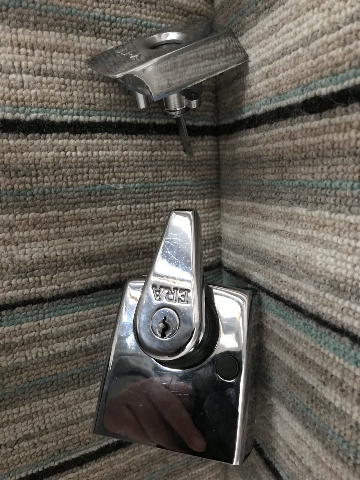

    Today replaced my front door lock with a like for like , an ERA 1930-37-1
    Nearly everything is fine, should be as it’s a like for like replacement. Now not sure how to explain this , but when putting the inside bit onto the door, and getting the flat metal bar in that come from the front cylinder in so all fits snug we can only get it on if the key is literally upside down. This means you cannot take the key out of the front cylinder, the key needs to be positioned 180 degrees to get the key out, but then we cannot get the back unit bit on properly?? Driving us mad and as not working loathed to call out a locksmith. Could be a faulty lock but it’s probably something very simple. Ofcourse my wife says it’s all my fault.

  3. I’ve had similar when fitting locks.
    Obviously the tabbed bar that passes through the door is 180 degrees out.
    If the end is cut at an angle and a tad too snuggly it might stop the inside going back on.
    If the tabbed bar is sufficiently long, you could try trimming 5 mm off at a time and see if that works?

  7. thanks for the hint. I’m still baffled as this is a like for like replacement. The tabbed bar is the same length as the old one, the lock is the same as the old one. But I do feel you’re headed in the right direction.
  8. Another thought just occurred to me.
    When you reassemble, use a long thin screwdriver to stop the bar sagging and catching.
    Best of luck
  9. Surely just rotate the cylinder lock anti / clockwise with the key first before you insert it into the nightlatch.:thinkingface:
  10. That seems to be the crux of the problem.
    The back plate fits one way, but turn it 180 and suddenly it doesn’t?

  12. 441C7325-59FA-450F-87D6-E0A972FE803E.jpeg As I mentioned I am replacing like for like locks. So if I use the old external bit with the new internal bit it works fine, but the exterior key is different to the internal key then. So it has to be something to do with the new external bit
  13. This is a straightforward exercise and it should be child's play,so maybe you do have a technical issue.
  14. All sorted. Thought I would have one last go before sending it back . I just needed to turn the key in the barrel about 720o and hey presto it’s on and working. Ofcourse it’s all my (wife’s )fault, who barged in and took over after my first failed attempt...ring any bells!!
