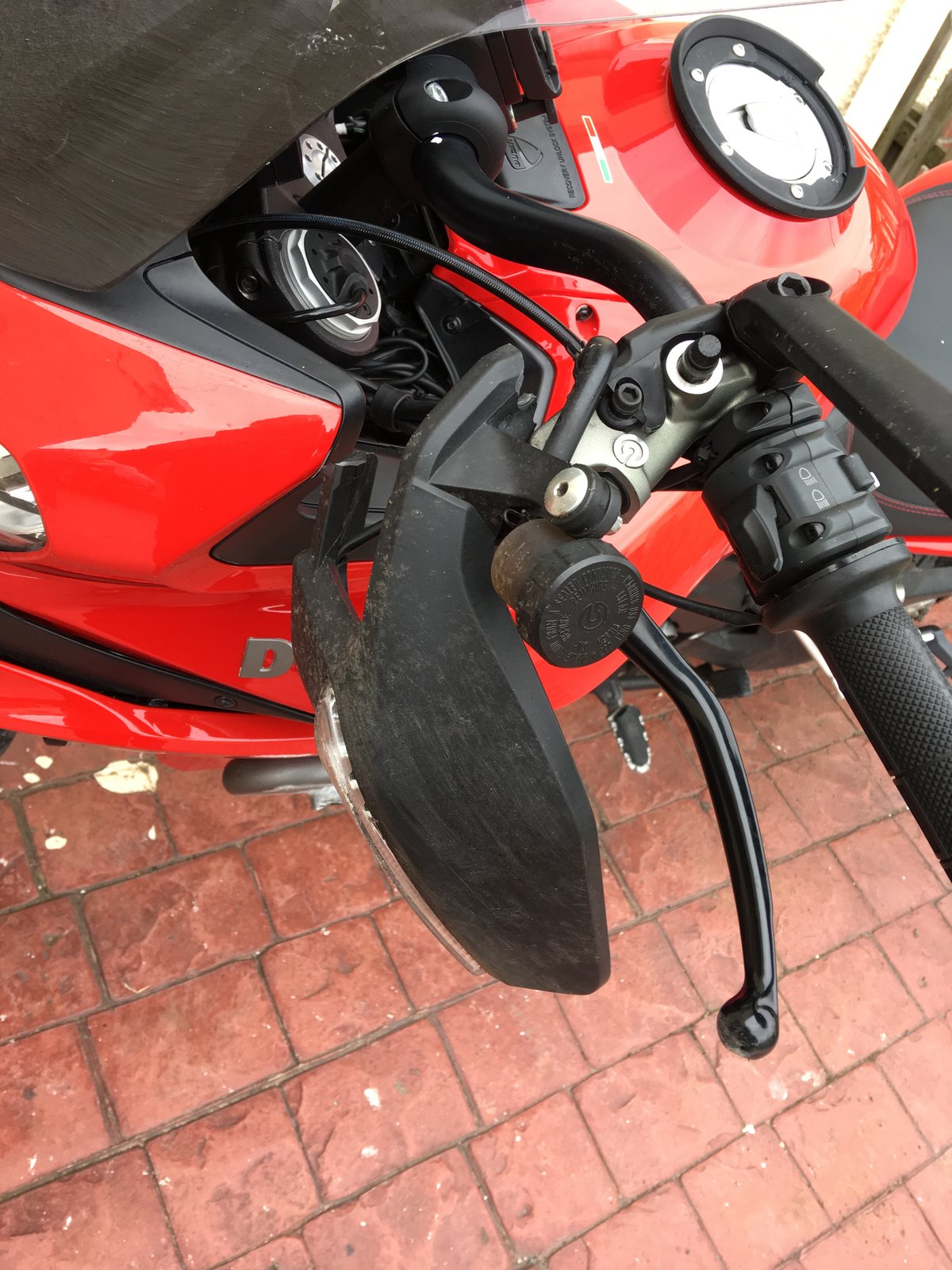

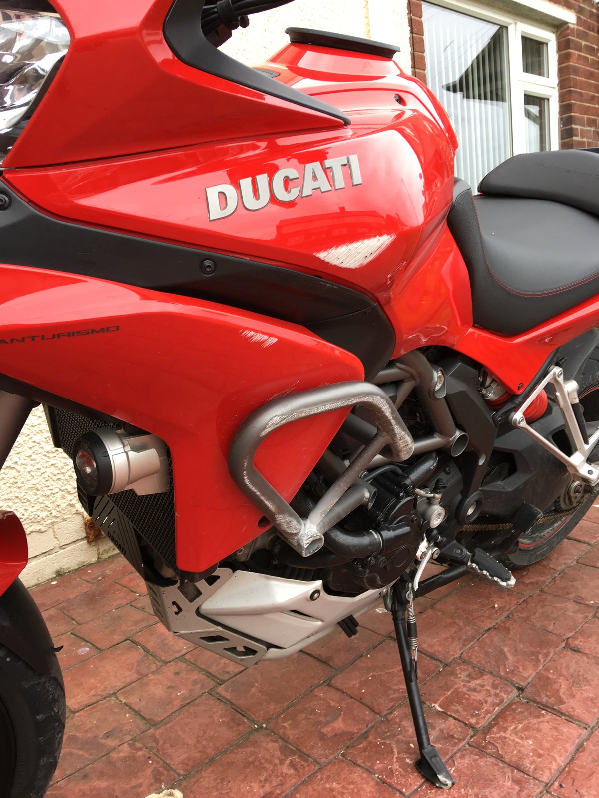

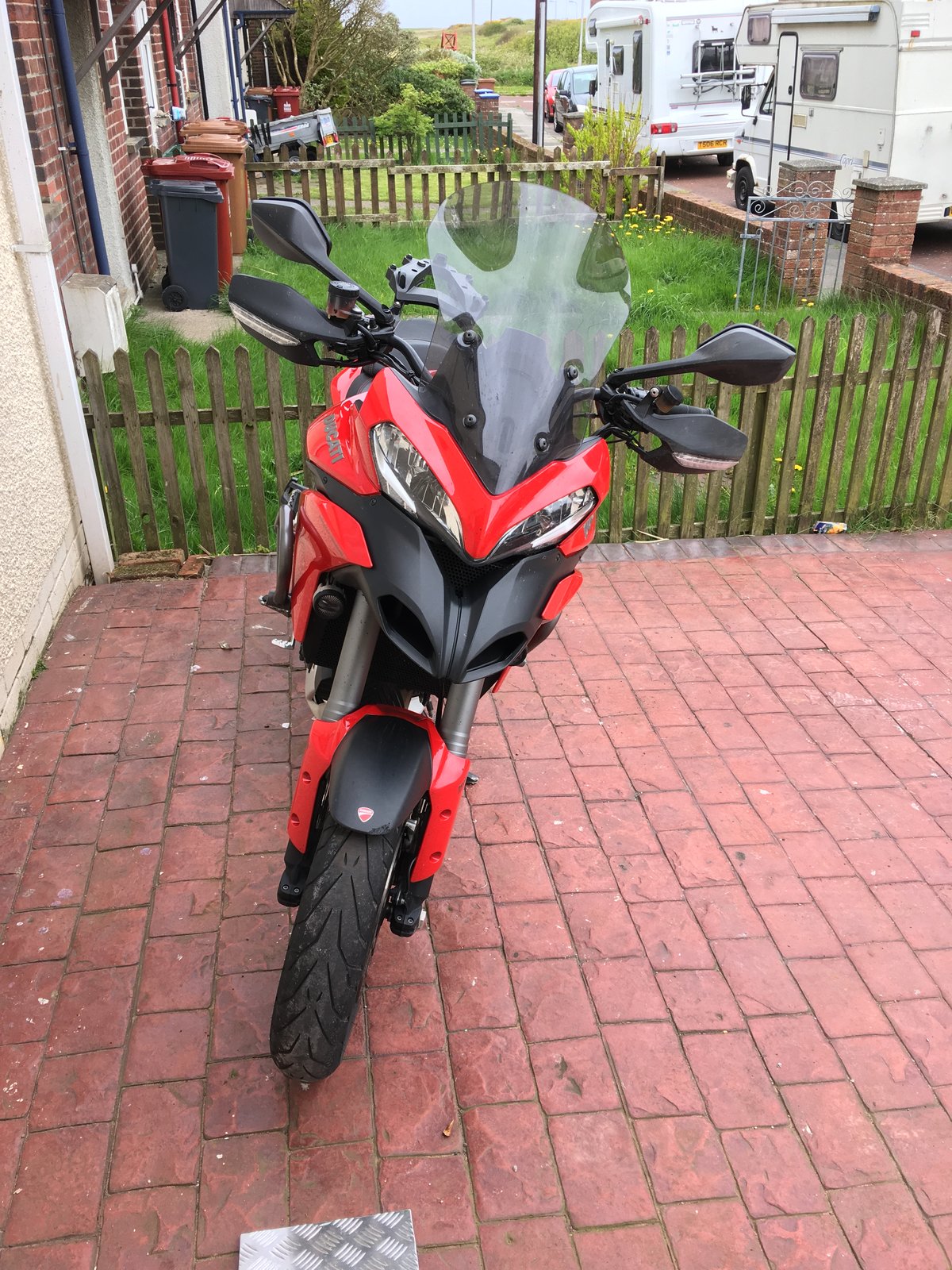

    Long time since I've been here, Aint see my bike for almost 7 months, it's been for repairs after a minor off, mostly panel damage and Handel bar end.

  4. Left hand side of tank. Remove the side panel and you'll see they have a rubber pipe going to each one from it's respective inlet manifold. Plug in wiring connector and a single screw holding each one in place. You can defo do one of them from there

  6. I fitted the one under the little panel on left below tank took bout 20 mins and light went straight out soon as started not had problem since and yes cost bout 70 quid think that one the horizontal mapmsensor the other is vertical map sensor
