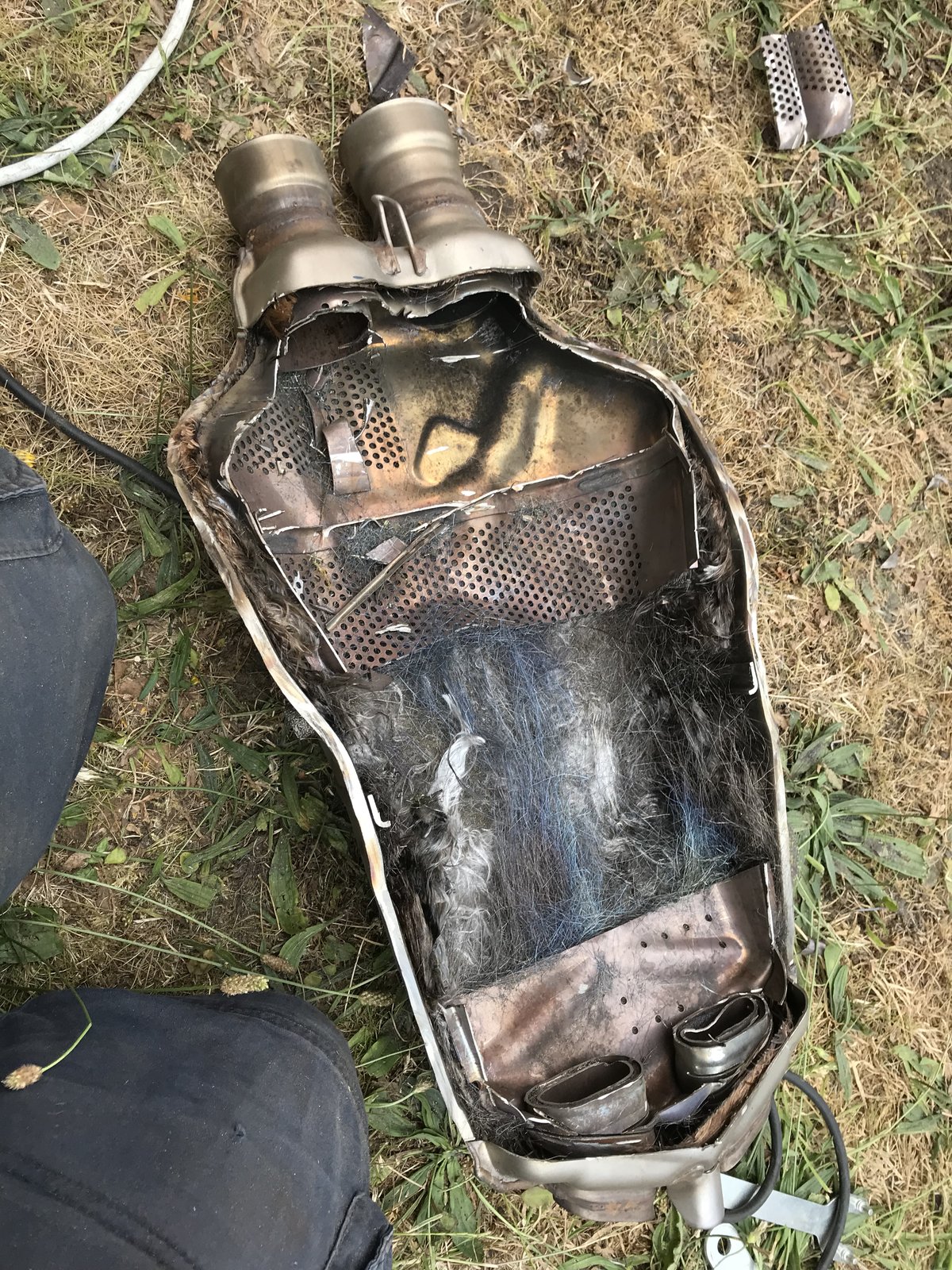

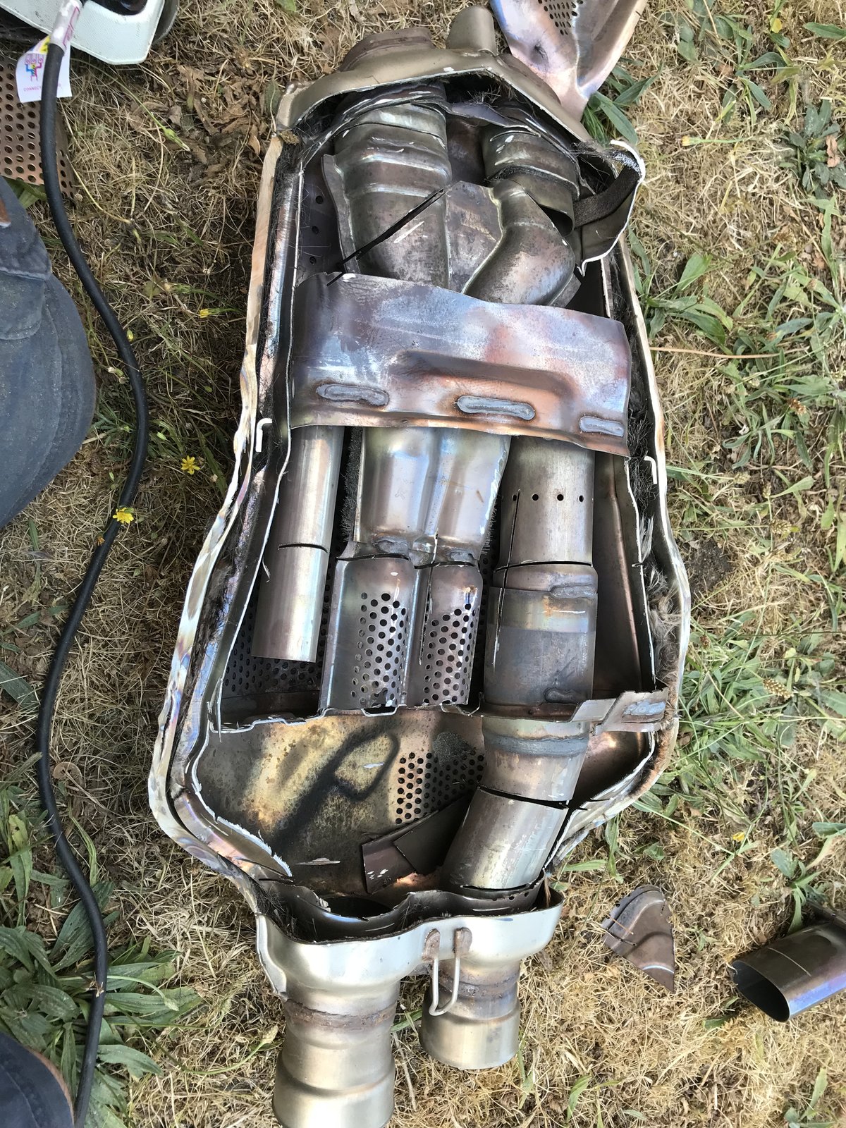

    End can is more tricky, loads of crap in there to cut out, WEAR A GOOD MASK AND GOGGLES. There are a few threads about on how people go about it. Some chopped the whole top off along the welds and gutted the lot. They made up new exit tubes to make them same size as the proper race cans. This will make the bike a lot louder.
    I cut a square off the top of the can with a .8mm disc and left the exit tubes OEM. I gutted as much as I could but it's a bitch to get in there. If I did again I'd just pass to a welder to gut. I got 3 lengths of perforated exhaust tubing, 65, 55, 45 mms (ish, would need to check) and had the welder make 2 tubes in diminishing diameters to go from the entrance to exit holes. Then wrapped them in exhaust waddling and stuffed the gaps. Bike is around 100 db so ok on most TDs, which is what I was aiming for. 0 weight saving. Sounds a lot better. Looks completely OEM so no MOT issues.
