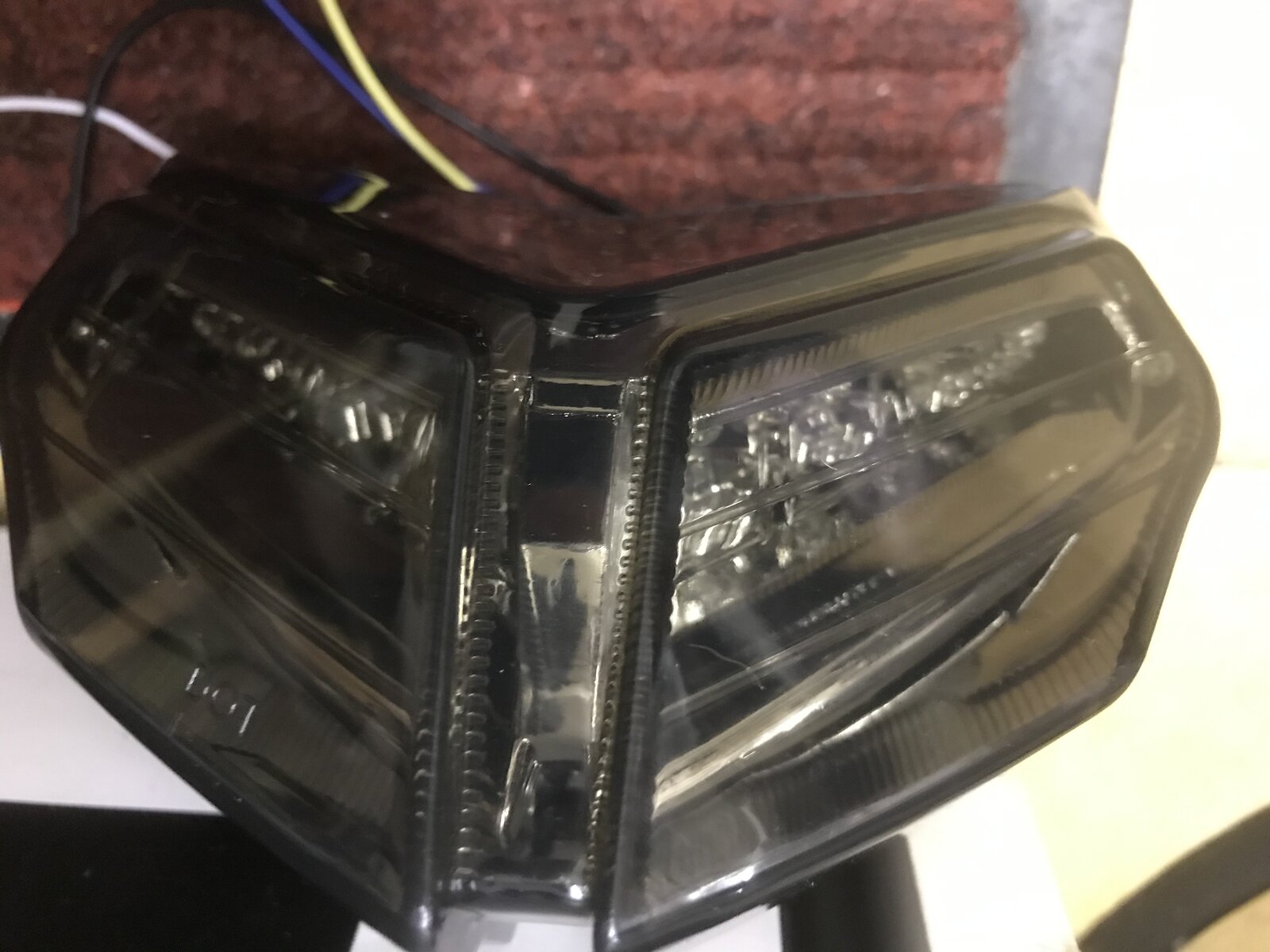

  1. Purchased off a certain internet auction site, Ducati 848 /1098/1198 integrated rear light / indicator unit

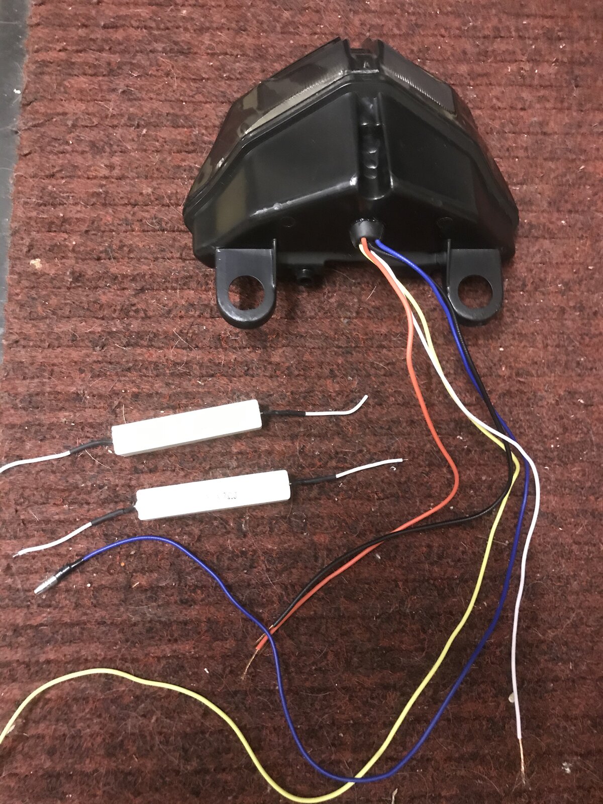

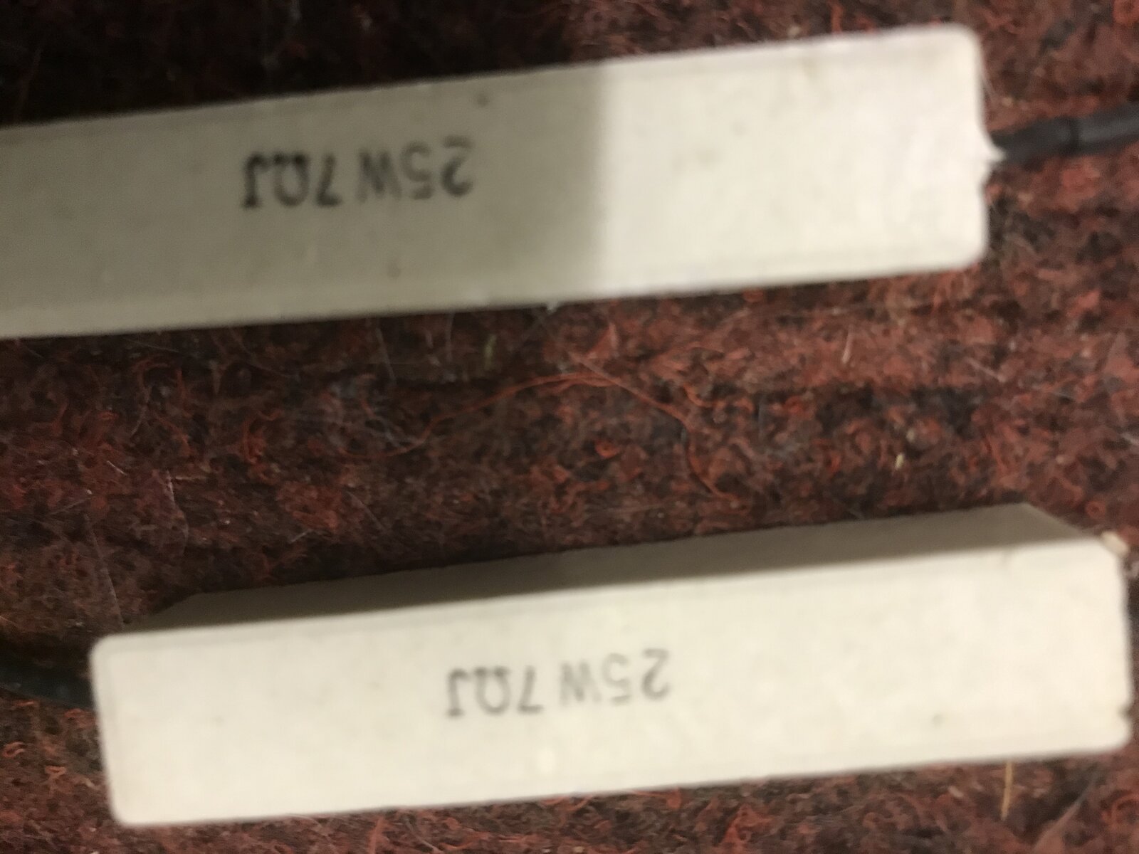

    Looks as if there are 2 resistors included for indicators to replicate bulb resistance ?
    No instructions of course!!
    anyone any idea which wires go where??
    Wasn’t expensive so if it’s junk I’ll bin it or get a refund

    EDIT resistor blocks need fitting in parallel with the indicators, as per post below. :upyeah:

  3. Resistors are fitted in parallel not series.

  5. Thanks for replies, got 12v battery and tried connecting a few wires , assuming the Black wire is earth?
    White to + bottom red led's light up, Red to + same led's light up, don't appear any brighter though? Try one of remaining wires to + nothing happens??
    Emailed seller for instructions,( how goods anyone's Chinese??????)

  7. ****UPDATE****
    It appears i was being a plonker by testing it on an old car battery that has been off charge for a while in the garage, it was only putting out 9volts!!!
    Tried it on a fully charged 12v battery and it does work, well all the LED's light up, the black wire is earth, red /white do the lights and brake lights (led's light red) the yellow or blue left /right indicators (led's light Yellow) obviously if fitted to the bike the resistors would have to be used control the rate of flashing.
