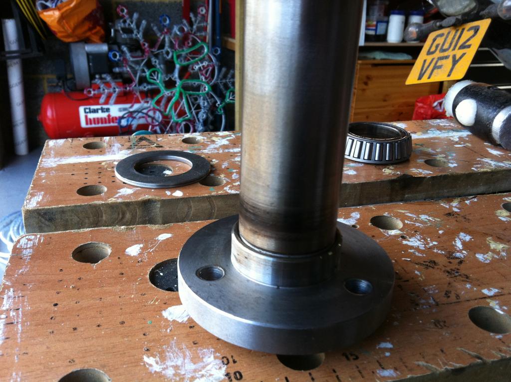

  1. I have decided to upgrade my new lathe with some SKF precision bearings as I cannot get rid of the -15" thou run-out from the headstock spindle. The front bearing is pressed on the spindle so need a press to remove/re-fit new bearings.
    Shaft diameter is 45 by 300mm long.?

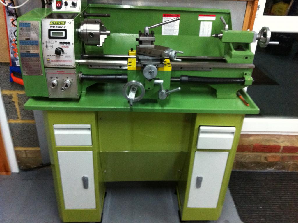

  3. Pics of the new lathe please Peter. Didn't realize that a 'young un' like yourself was bi-lingual with measurements! :biggrin:

  8. lathe 002.jpg Picture as promised John. I have already spent some 20 hours stripping and cleaning and adjusting it so that I might start using it soon, that is after I have made new gib strips, new bearings and some simple modifications.:upyeah:
  9. That looks great Peter, Know how to use it?

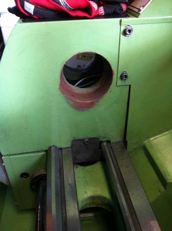

  10. Yes, my new SKF bearings arrived today so I am in the process of fitting them
