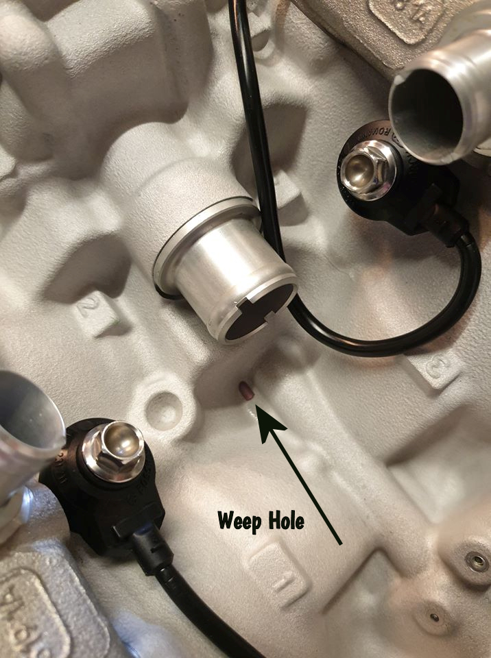

  2. I thought there was an issue with the old style one which was rectified with a new design. Clearly not. My understanding is the seal fails allowing oil to exit through the weep hole in the crankcase.

  3. Thank you for the info, I'm going to contact the dealer today about it.

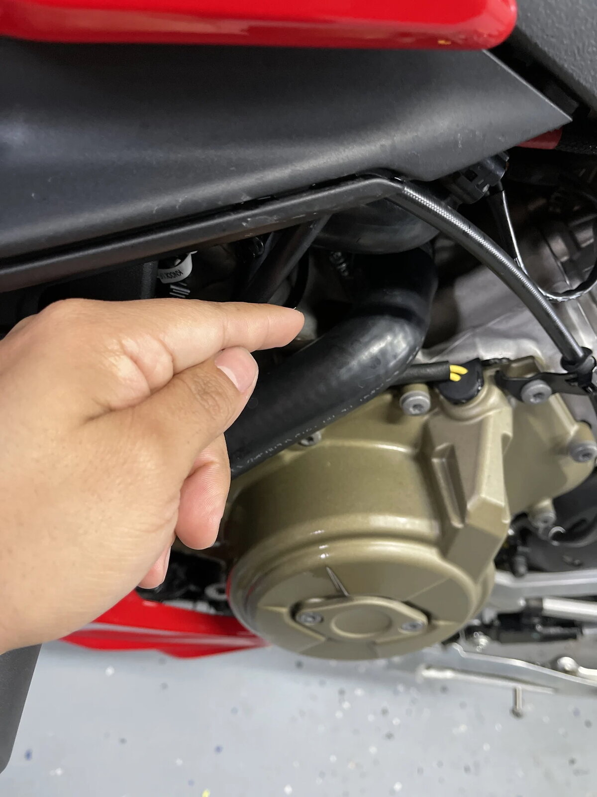

  4. Can you show us where to look on the bike ? Is it visible with the "bodywork" on ?
  5. These are photos I found on another forum. The one in these photos is much worse than mine or they never noticed and the V in the engine litterally filled with oil.
