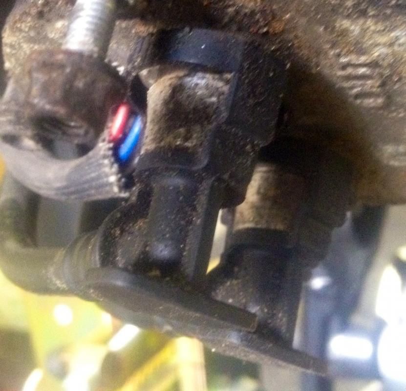

    Can anyone advise as to how these 796 fuel pipe clips undo? They are situated at the rear of the tank where the fuel pick is located..
    Many thanks

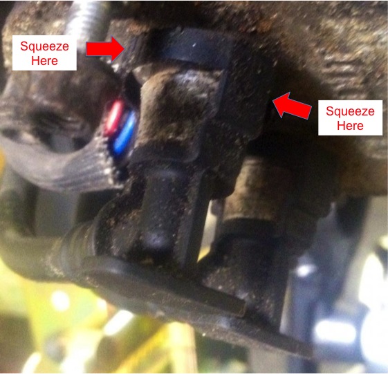

  2. Another view
  3. You see the serrated markings around the ring nearest to the tank? Squeeze them as bloody hard as you can...
  4. clean, lubricate then squeeze in between the two solid lugs, twist and pull.
  5. +1 on what Fig said.
  6. Pinch and twist. When they get released, expect some fuel to come with it. Paper towel at the ready :upyeah:
