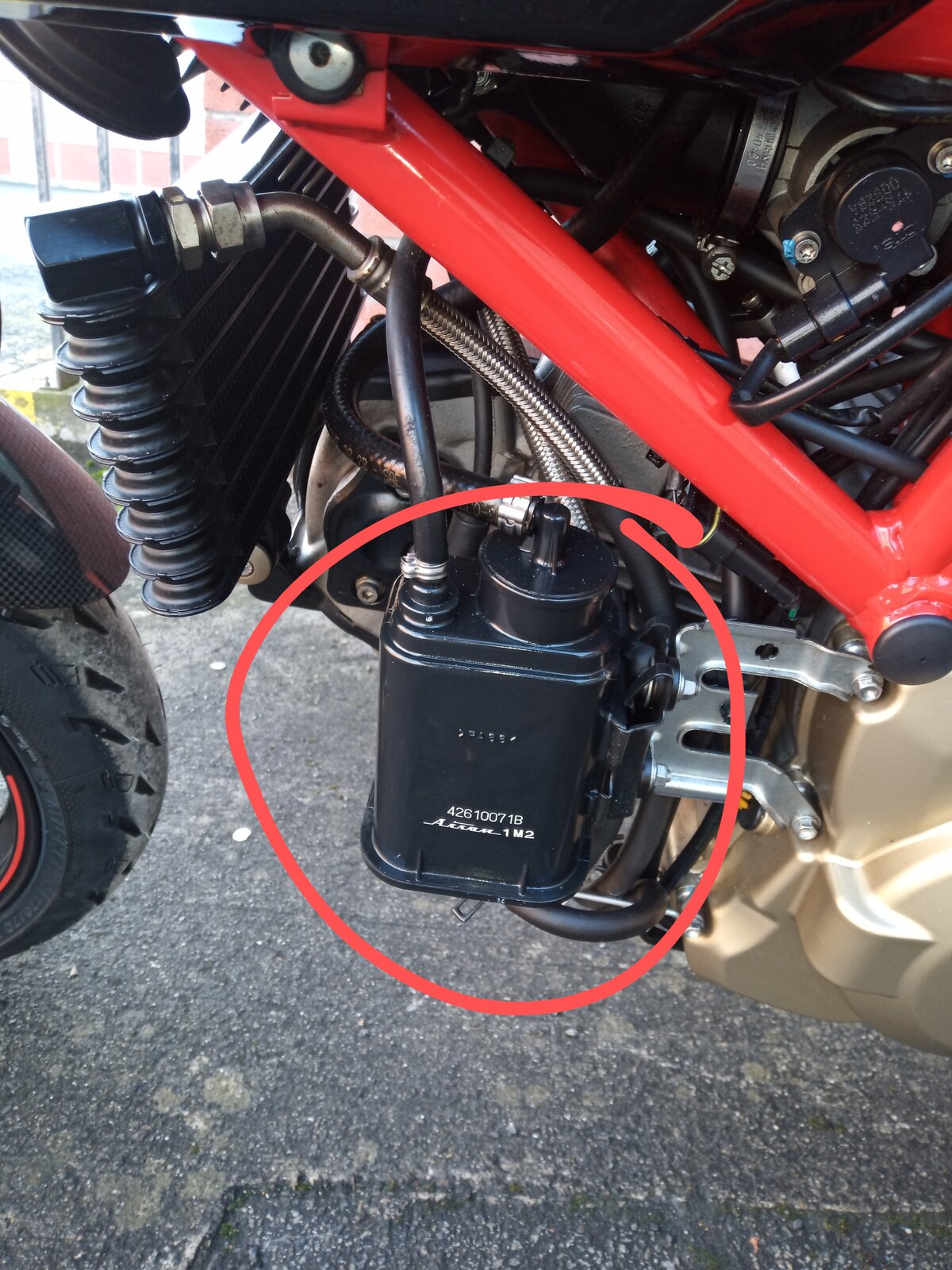

  1. I know it might be a stupid question but I don't see it on all models so just wondering!
  2. It is the Emissions Cannister Filter part number 42610071B
  3. Flux capacitor
  4. It's a thingymajig for the dodah and Ducati will charge you the earth and take your children as deposit!

  6. As said evap canister Favourite item to remove

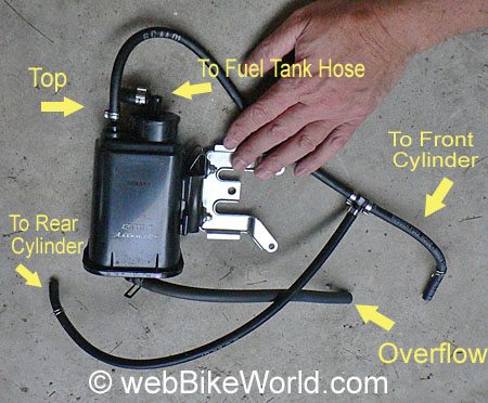

  8. I see that on the attached image, hose 4 is a vent from the tank and can go to the bottom of the motor
    Hose 6 can be plugged as it goes to the TB's
    What happens to hose 2 though ? Can that just joint to hose 4 or is it just removed altogether ?
