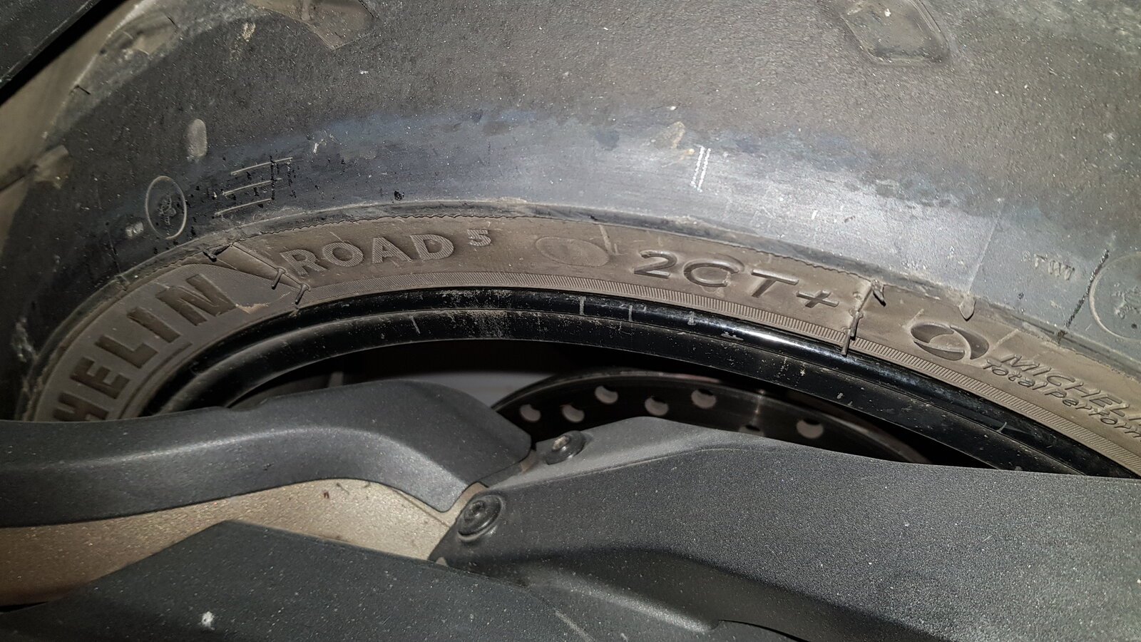

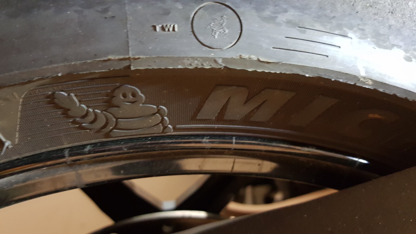

  4. I have PR5's on & the chain is close but still clears ok. 20181230_141447.jpg
  5. mine is the same distance too with Road 5 tyres on, my chain never hits the tyre

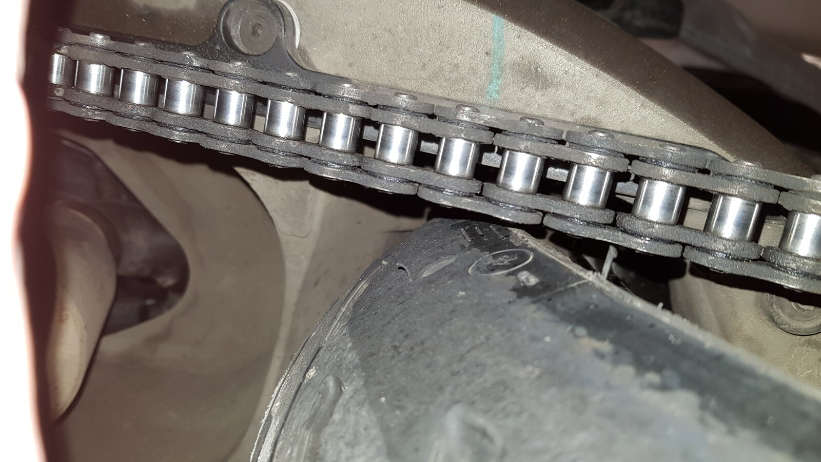

    What i don't understand is how you can have the same limited clearance as me but you don't have the chain eating the side of the tyre like I do
    From the wear marks on the chain I can tell the tyre is hitting the chain on the bottom return run ie the slack part of the chain and wondering if my bike is missing some sort of chain guide

  13. Yes yours is starting to mark as well, the harder you corner the more it will eat into it
  14. Ok so it's a 190x55x17. Using a sash clamp to get exact it is 195mm . Was wrong about catching. If I push chain hard sideways it does not touch. Looked at top & bottom run all ok. See pic. It still has new rib marks on edge.
