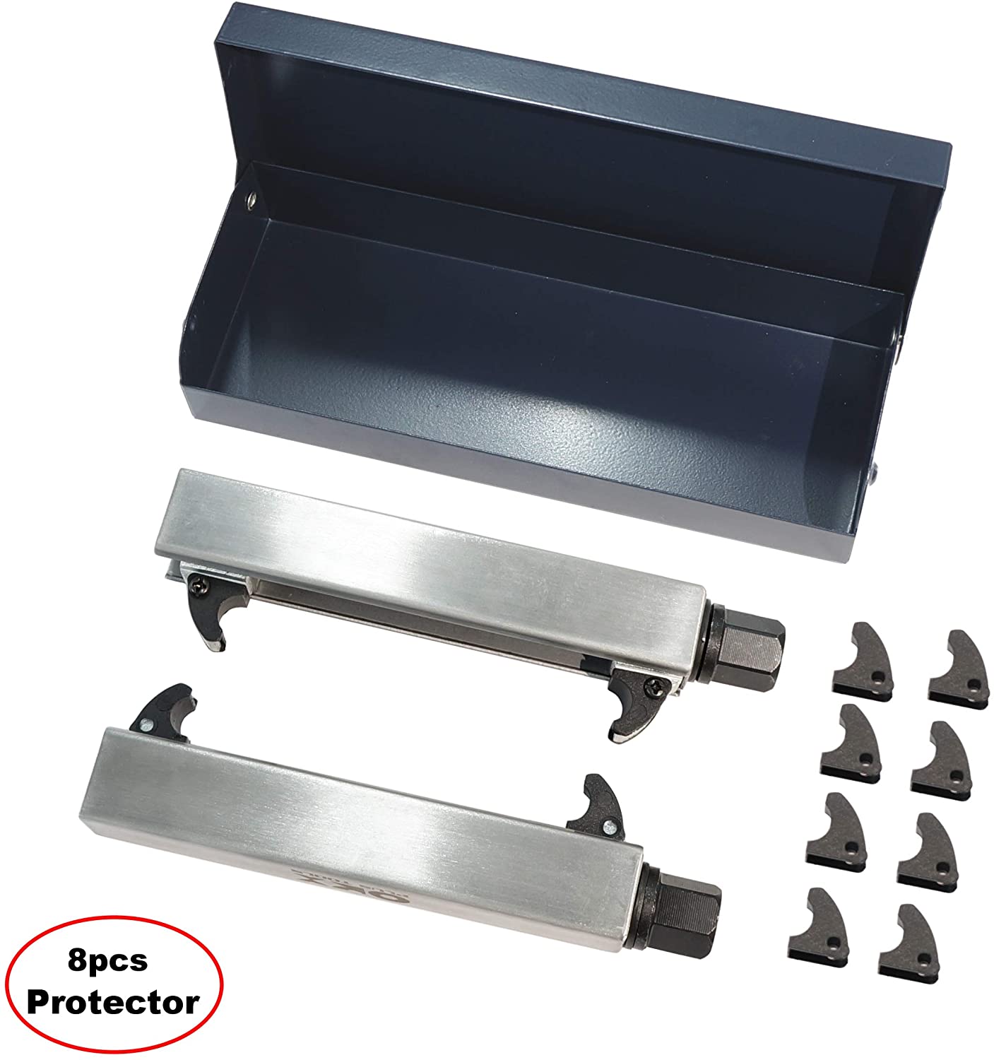

  1. I am planning to remove my rear shock this weekend. I also do not want to remove my exhaust or swingarm. From what I have read, the shock only needs to be compressed a few mm's in order for it to clear the frame cross member. Has anyone used these motorcycle spring compressors? They are 159mm long so it seems there is just enough space for me to fit them in the bike.
    https://www.amazon.com/ORXPLUS-Tool...7205&sprefix=motorcycle+spring,aps,214&sr=8-2

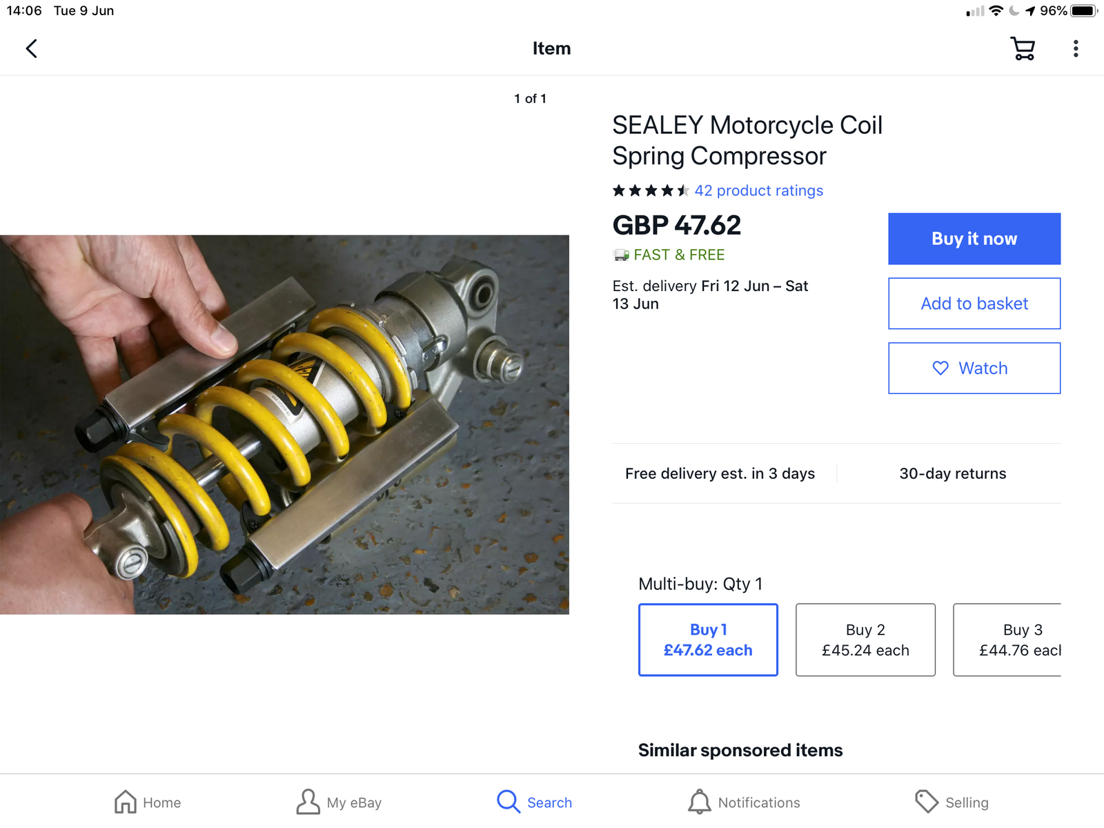

  2. If they’re anything like these Sealey jobbies, they’ll do the job. Word of warning, try to clamp them some how as those springs take some serious compressing!

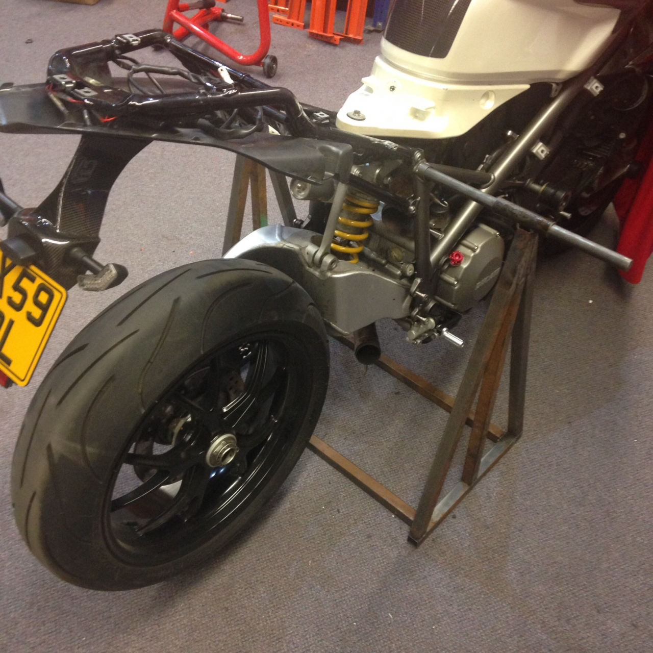

  14. When I changed my std shock for an Ohlins ttx, I made this stand to take the weight. I’m sure I had to remove the link pipe...
    Don’t envy you now looking back. It was a real pain in the arse to work on.
