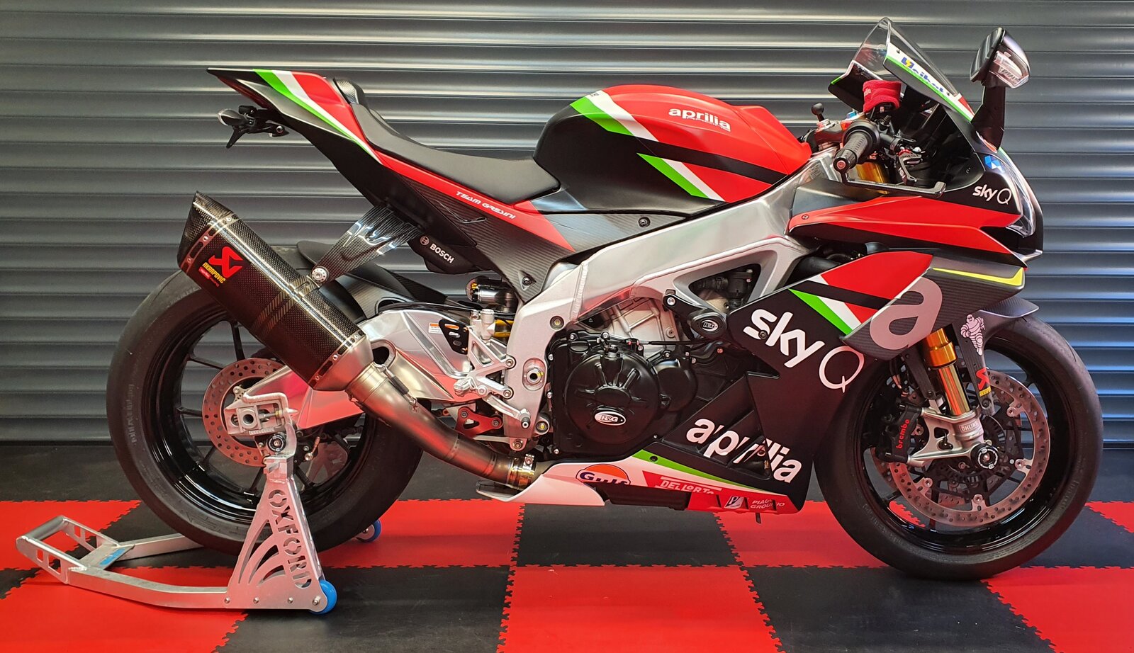

  1. I'm considering changing the colour of my wheels. Ideally I would like to change them to gold, similar to the OEM factory wheels of the RSV 1000.
    I was told (on good authority) that the RSV 1000 wheels were anodised so I'm looking for somewhere in the UK, ideally near to Lincoln (not an issue if not), where I can get my wheels stripped, prepped and anodised.
    Any suggestions/advice?
