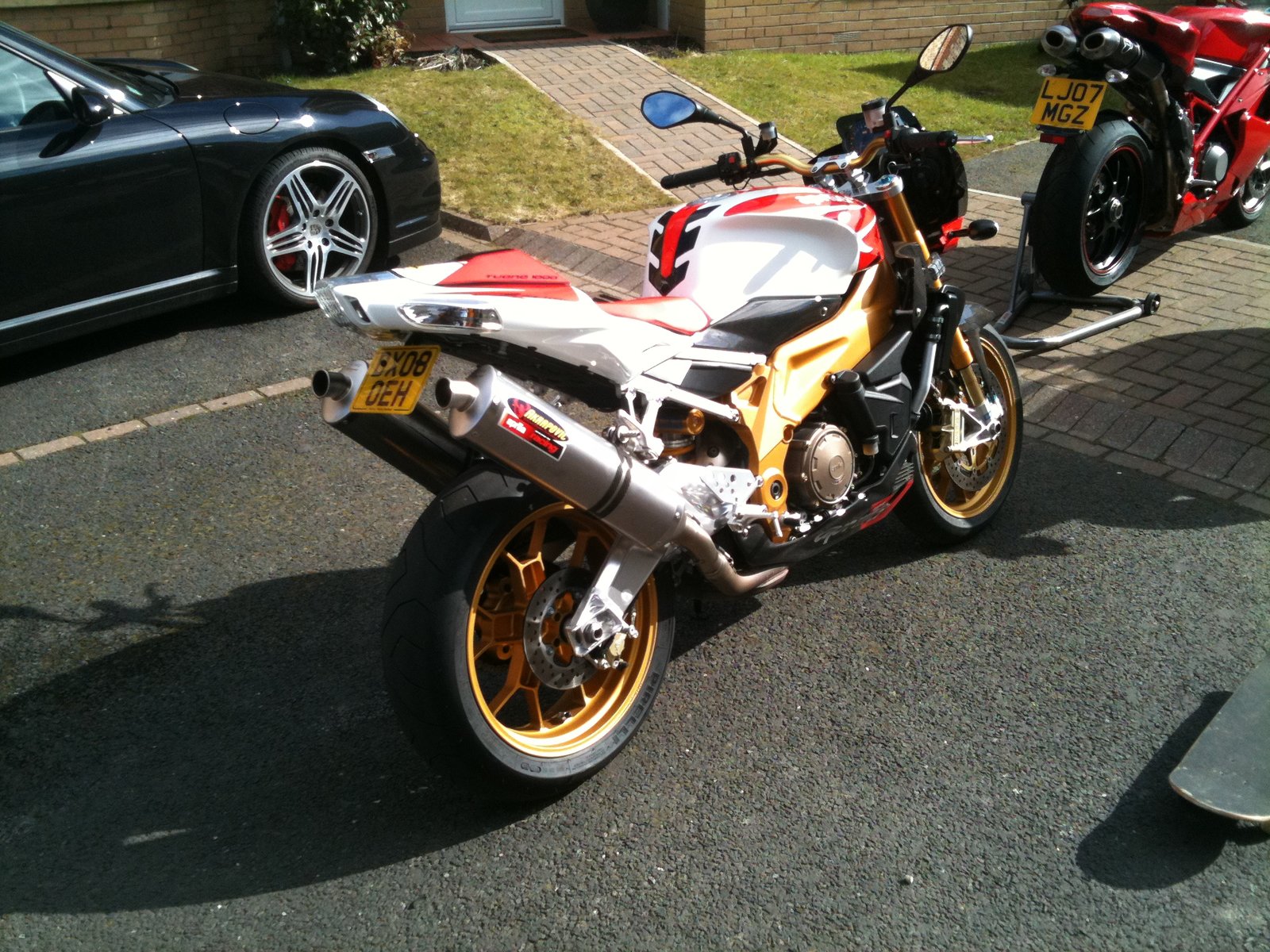

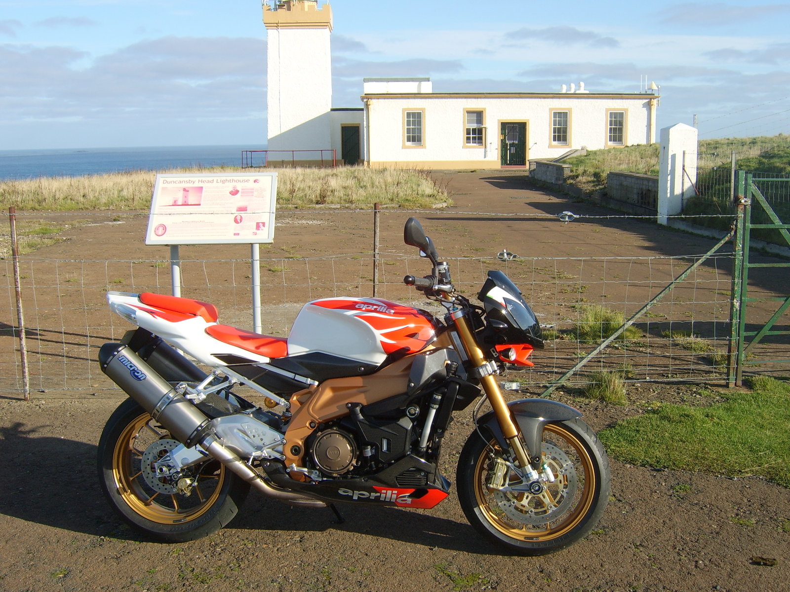

    I also had one of the older tuono's from new, Think these were some of the last cans micron ever made, Ide be leaning towards the superduke 1290 if you cant get hold of the sfs, Saying that the Tuono is something else

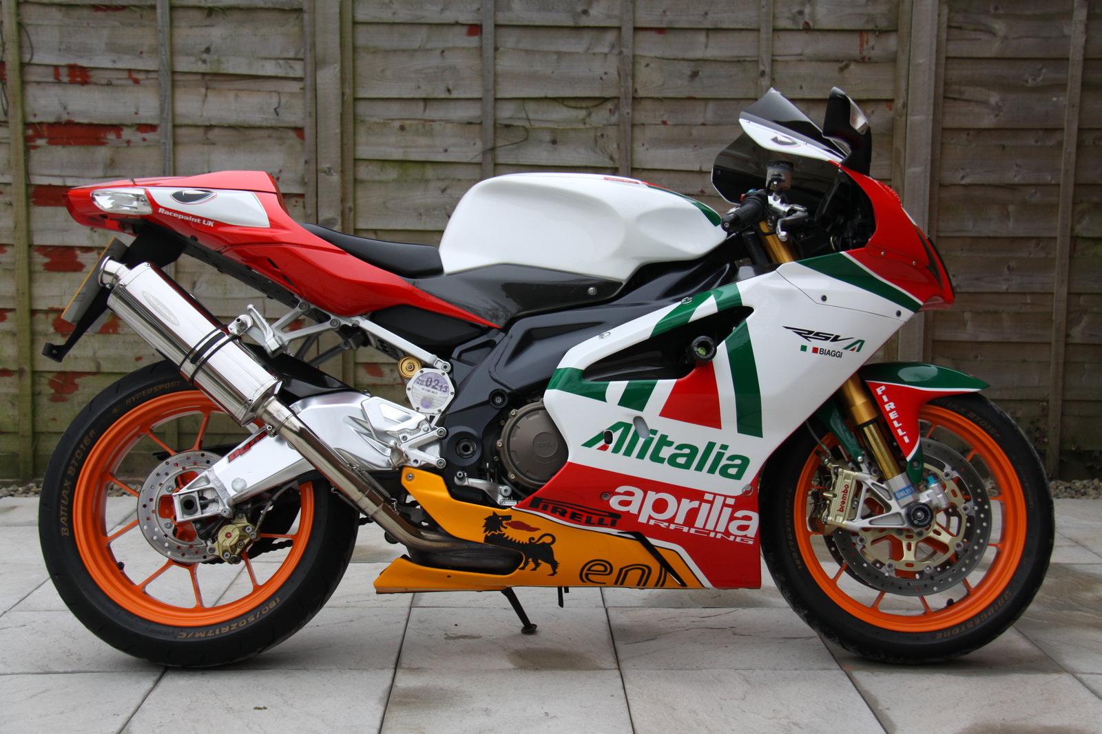

  11. He doesn't have enough wotsits for such a low mileage example - he want's the best deal selling and the best deal buying (a bit like me o_O) but no mine has not been considered for sale until he asked - my Aprilia RSV-R Factory could be for sale though...
  12. @Exige I know someone who may have your aprillia send us a pic mate:upyeah:

  14. You know I have enough Wotsits......& we both want the best deal whether that be buying & selling.....but I really wanted a bike with some mods......so although you bike is lovely......I feel that it's a tad too expensive taking into consideration that you want only a small amount less for it than a 1098R Bayliss that was recently purchased!!! Lol
  15. That must have been cheap!!! :eek: You have seen the price of SFS's in Germany, mine would be £5K more over there :thinkingface: only going North in Value and less than half the price of a 996SPS that sold recently :yum
  16. It was a 916SPS actually........& if I remember correctly....you were miles out on the value of that too!!! Lol
  17. @Exige ......RSV-R looks lovely!!
  18. yeah, always value too low (916SPS's are 996cc) :thinkingface:
  19. £20K o_O
