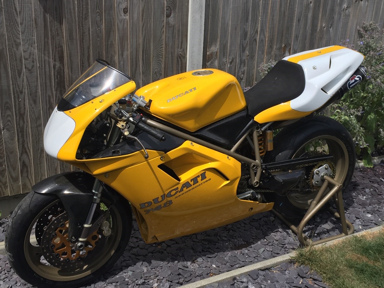

Not worth anything.... throw them in a box and send them my way. I'll send some wotsits over..... PS Here's my baby.
