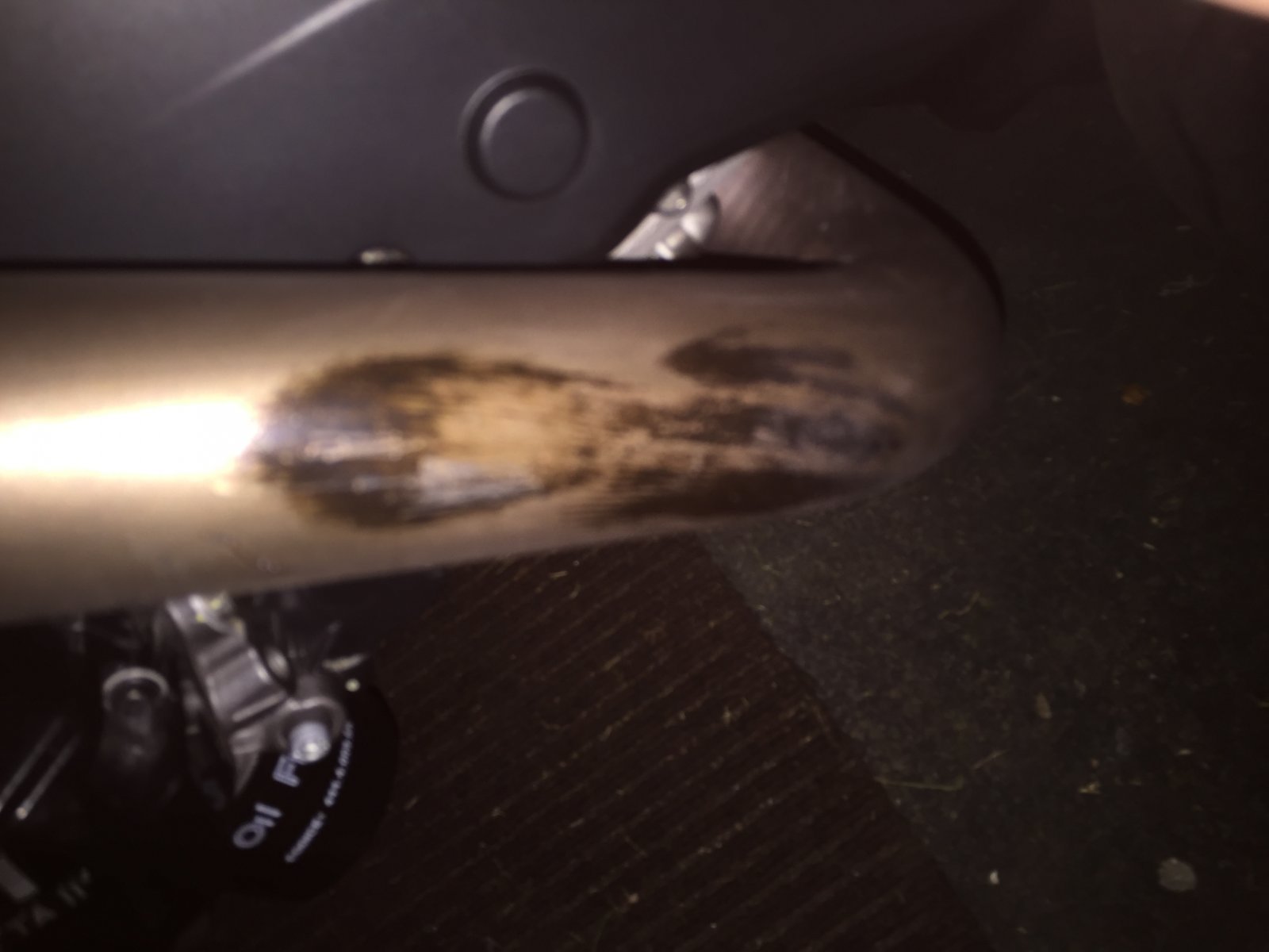

  1. warming up my hyper today and the fabric dust cover that I took off and hung on the shelf fell down and melted its self to the Exhuast headers,arghh!! I've tryed thinners and petrol with a light scourer but won't budge, does anyone have and solution on how to remove the melted on material from the pipe,any input would great

  3. why would anyone make up a story like that, anyway here's an image image.jpeg

  5. heat may be the answer
  6. You think it might burn off with use, or getting it hot and then try and remove it
  7. ;)

  8. burn off with use... trying to remove when hot may be painful! had a dust cover melt on my 900ss end can and it took ages (about a year) to burn of the marks but it eventually did. given its on ya header it should happen faster
  9. Have you tried acetone? I buy litre bottles but nick some of the wife's nail varnish remover and try that first as it is acetone, moves all sorts of stuff including nail varnish.

    I'd say ceramic coat the exhaust which will get all the external crud removed before been coated.
  15. Brake cleaner or upvc cleaner solvent, which is acetone based. Know any window fitters?

  17. Heat....when I picked up my hyper last month I burnt the boot heel of my Sidi's to the exhust (massively) I reckon I went through about a good half inch of rubber, leather and plastic...it looked like it was welded on there until it went to CJS and chris gave it a good caning...once it came off the dyno I literally scratched it with my finger and it all came off in one go...

  19. There was a mention of this in MCN this week. They came up with stainless cookware cleaning paste. Looked like they were using this stuff:
    Astonish Oven and Cookware Cleaner 500g: Amazon.co.uk: Kitchen & Home
    It is mildly abrasive. Whether that means you end up having to do the entire pipe I don't know. Worth a try in a discreet stop though.
