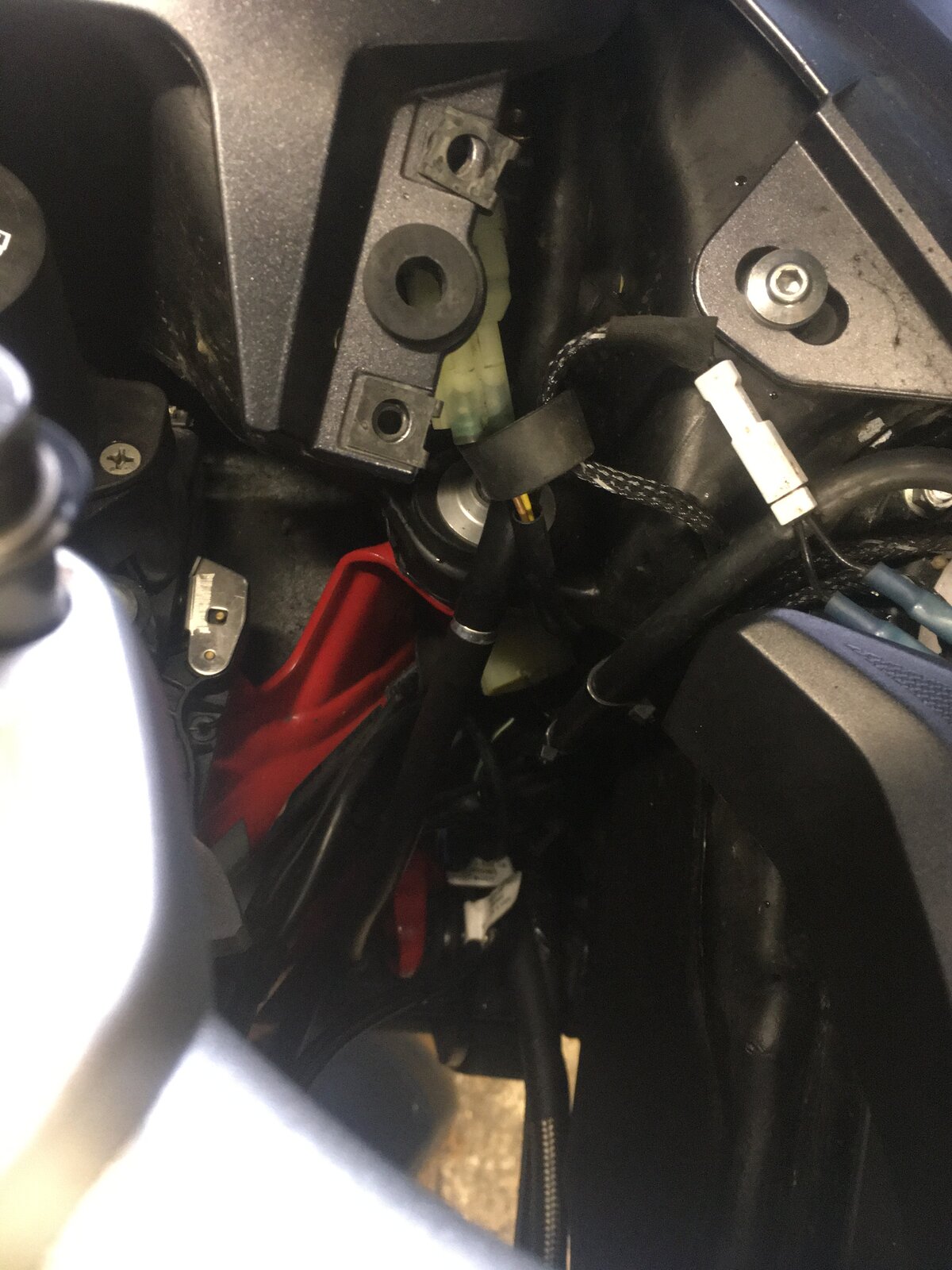

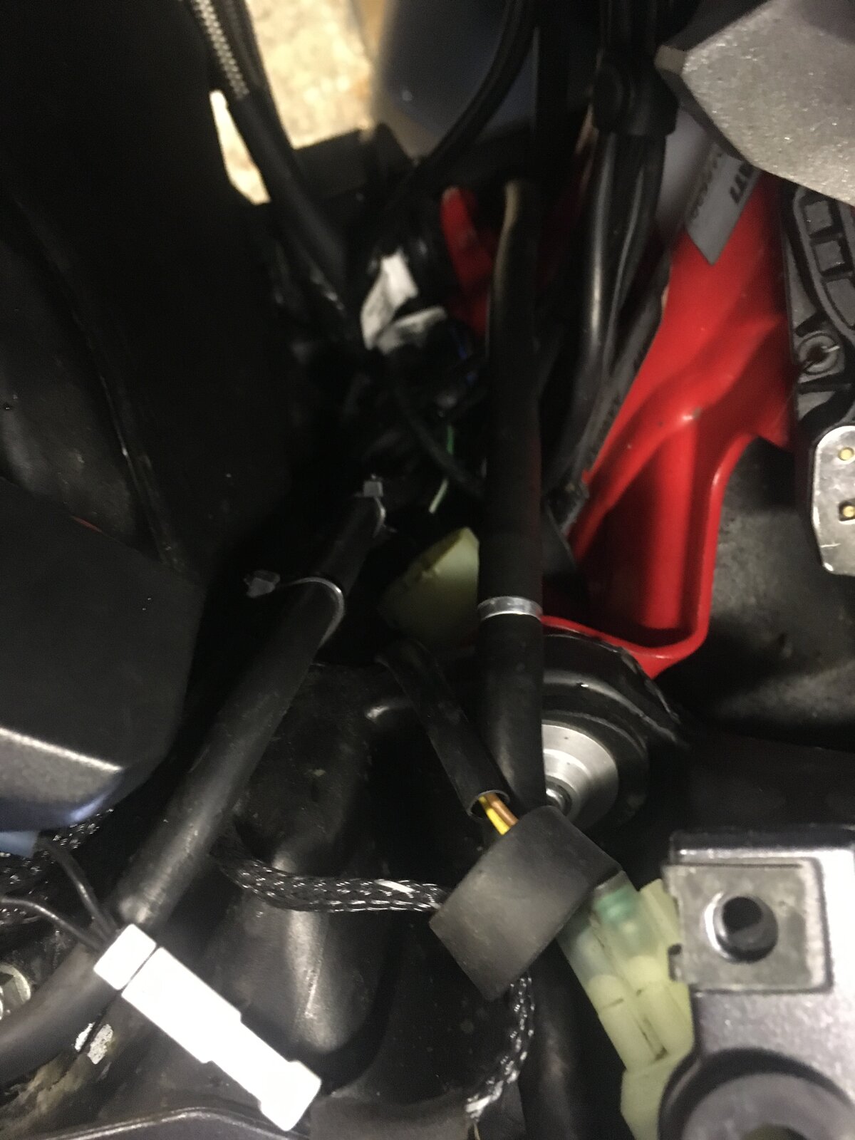

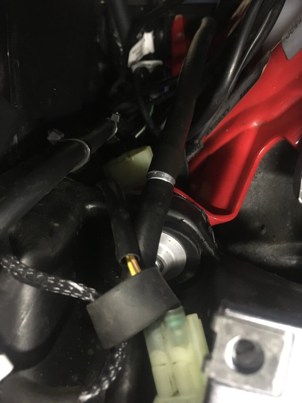

    Re fit mine from my 1200s to the 1260s this April. Did not remove tank or side panels, just the emergency start / key over run cover.
    Difficult connection block to find but as Kartman said left hand side ( sat on bike ) just below the radiator mount on my red frame bike is the 3 pinned white / cream connection block. Set in this 3 pinned connection, is a blank cover. This is difficult to separate from the connecting block.
    Persevere with loss of skin off your knuckles and a lot of swearing , you should find.
    Good luck.
  4. Thanks both, esp. Pete with those pictures. Very helpful :upyeah:
