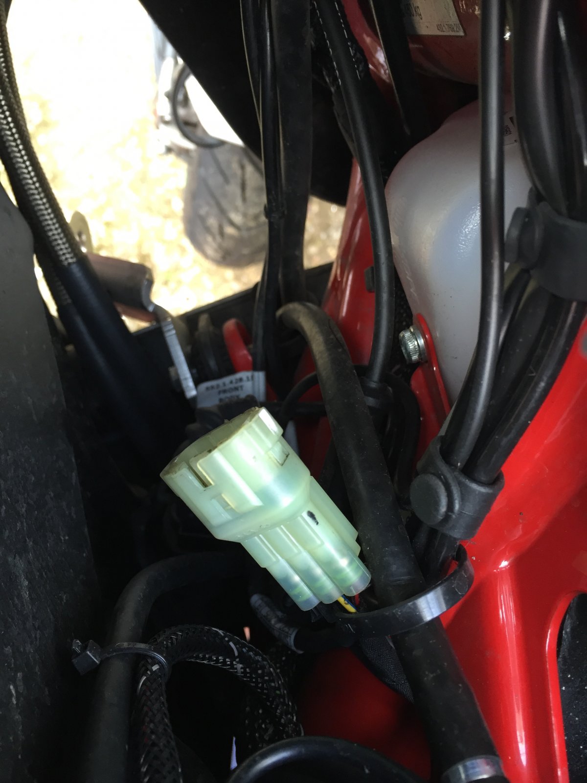

  3. I have just removed my leds and they plug into the yellowy looking plug below.

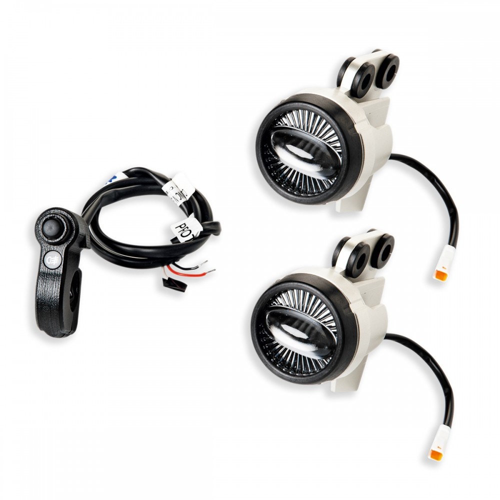

  7. Hi Kev,
    Pic of the switch in the kit mate
  8. If you have a DVT then you don't need the switch, there is a switch on the bike already?
    Pre DVT you need the switch, and the brackets are different so I'd check which ones you bought.

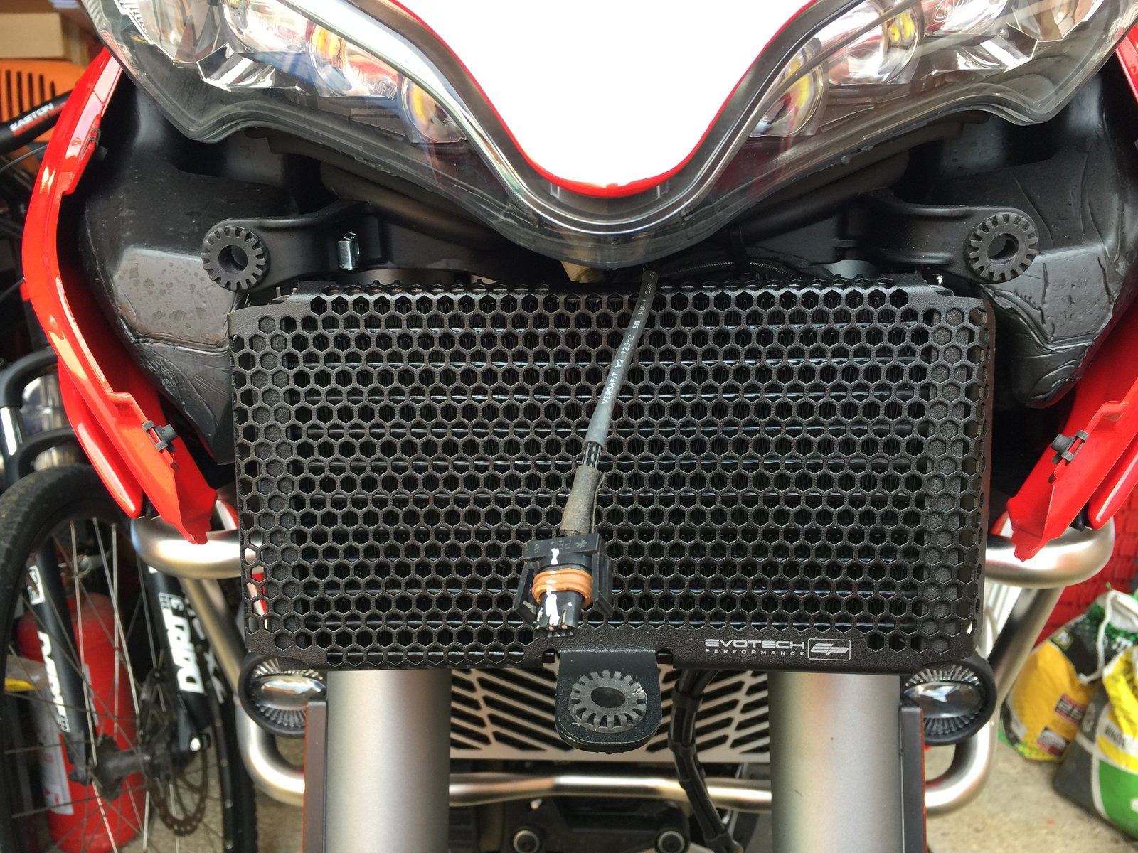

  9. Hi guys
    I've got a DVT and fitted Denali D4's instead . Light output is ... wow . But Denali were wrong , they won't work with the ecu / fog lamp switch .
  10. Did you try and get Ducati to activate them - because even Ducati ones need activating after fitment.
  11. Hi Simon : yes gt motorcycles in Plymouth spent ages trying ( great bunch there ) Riders Bridgewater fitted the D4's and they said the dash kept coming up with error messages . I suspect the drawn current is a little higher and the canbus system chips in . I'm looking for some tiny Cree lights that I can fasten to the engine guard .
    The denalis have 4 .
    If I get any joy I'll post it .
    Kind regards
    John

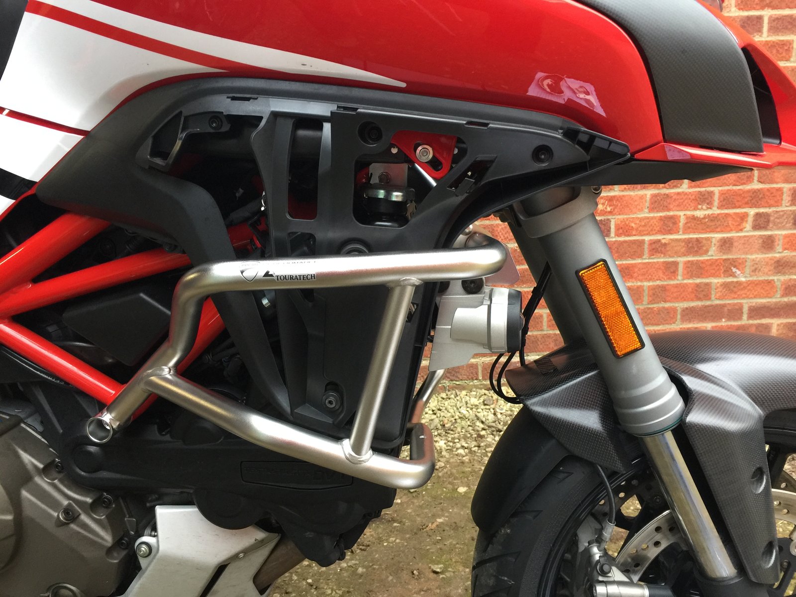

  12. If it's a DVT and unless you have really small fingers it's a gas tank removal job unfortunately
  13. I have big hands apparently and didn't take the tank off. I removed the air conveyors, beak and side panels and got in there okay.
  14. Sorry enduro I mean
  15. Hi Simon
    Looks like the current is little too high for the canbus system .
    Re: parking lights - riders in Bridgewater can't activate them either .
    I've e mailed Ducati Italy and will post the reply .
