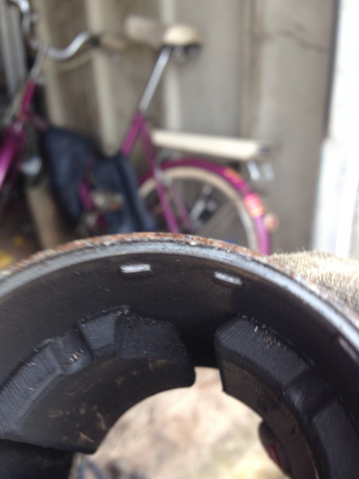

My starter packed up a couple of weeks ago. It's never been hit or in an accident but 2 of the magnets inside had broken up and were shorting out when i hit the starter button. You can see then pictures of it in the 748-998 section under the thread, SO, I'M AN IDIOT £99 replacement from WEMOTO.COM thanks to a tip from Louigi Moto and that problem sorted. Still wont start though as the sprag clutch is also buggered.

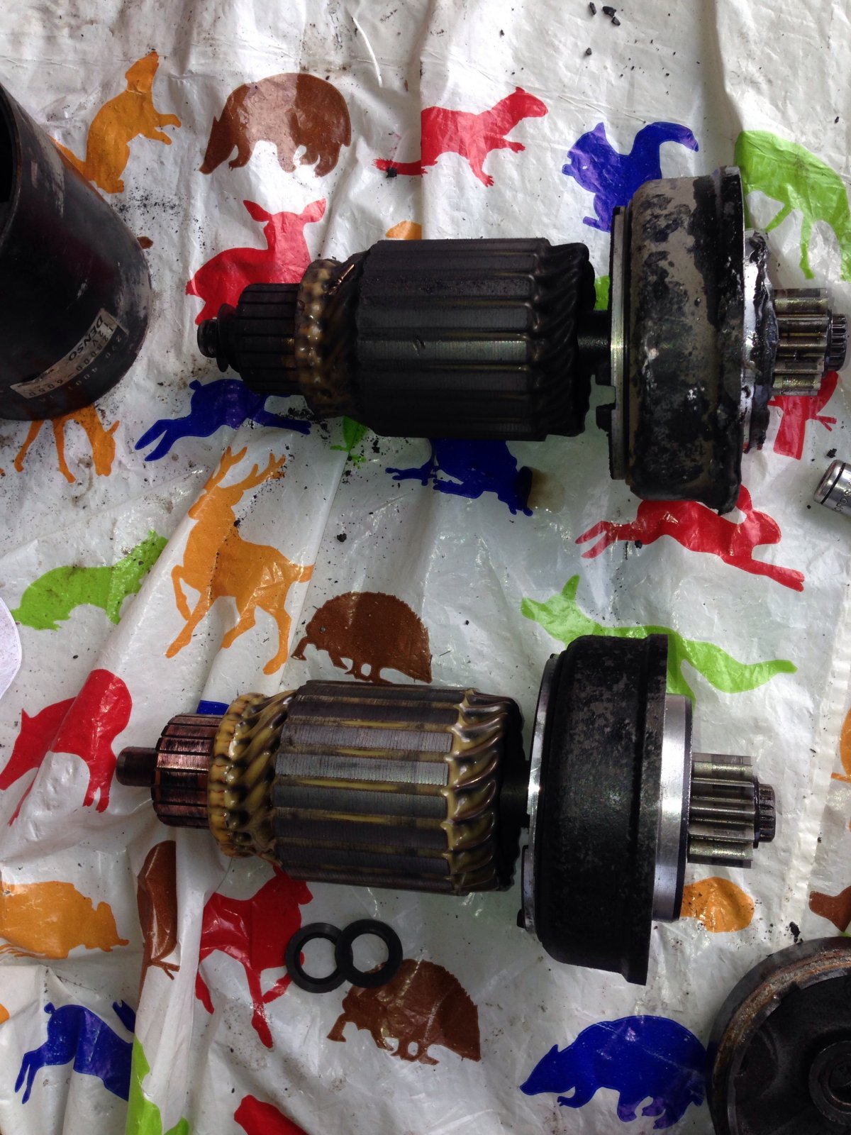

Yeah will strip starter. Have taken new one apart, but can't see how to get amature around sprung bushes!?? Tried to wire up new starter but didn't want want too go with not being earthed to anything. Will look at old one.

Well, I think I've done all of the above. I'm going to put the new starter on today so I'll tell you the outcome later( that is if I can get it back together!!

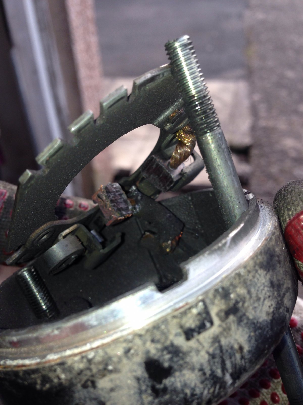

Could someone please tell me how to get the armature back into the casing and between the spring loaded brushes, otherwise all this information will be useless. Kind regards.
Got starter out and it doesn't feel bad. But haven't stripped it as I haven't been able to put the other one back together yet!!??? Got to go to work at 3 so won't be able to do it today, again. Could someone please get back to me with a solution for assy.

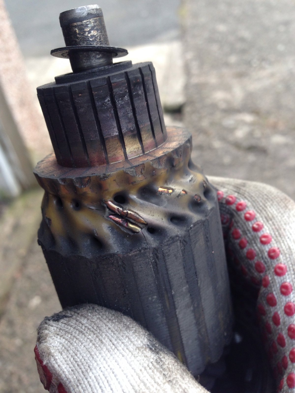

Sorted. Didn't realise that starter split into 3 pieces. Magnet on body chipped, windings burned, brushes worn out. Great news. Only found out that starter spit in three after dismantling old one. Happy days. Back on the road tomoz.
