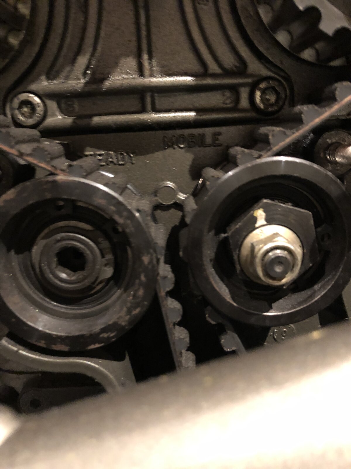

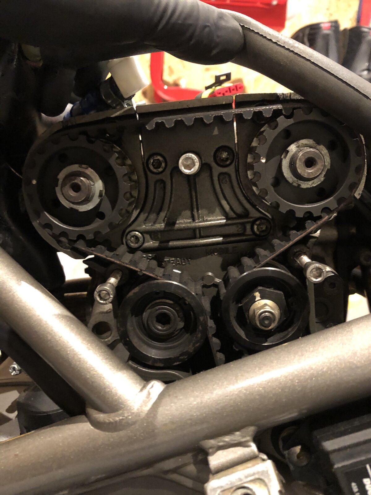

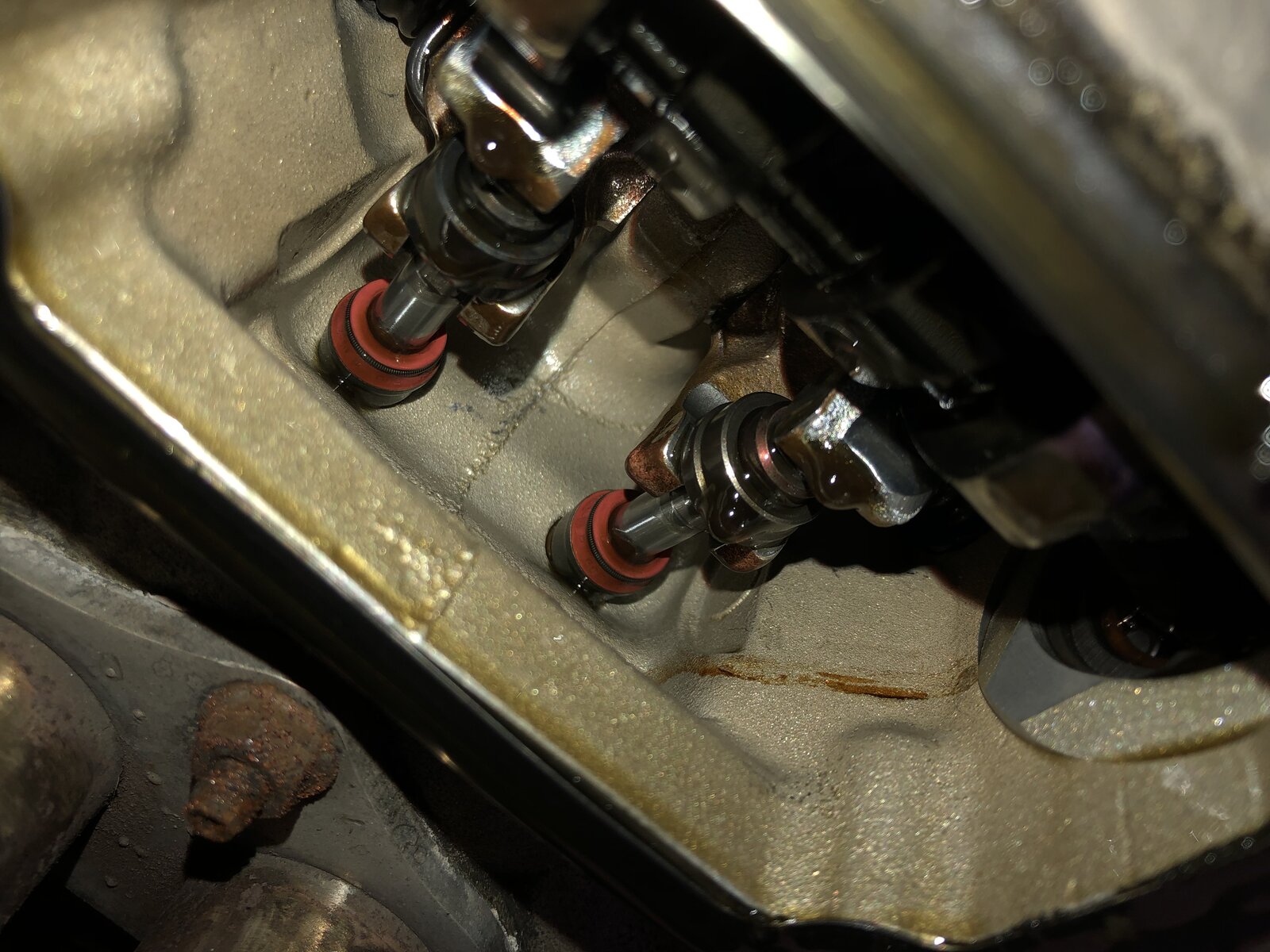

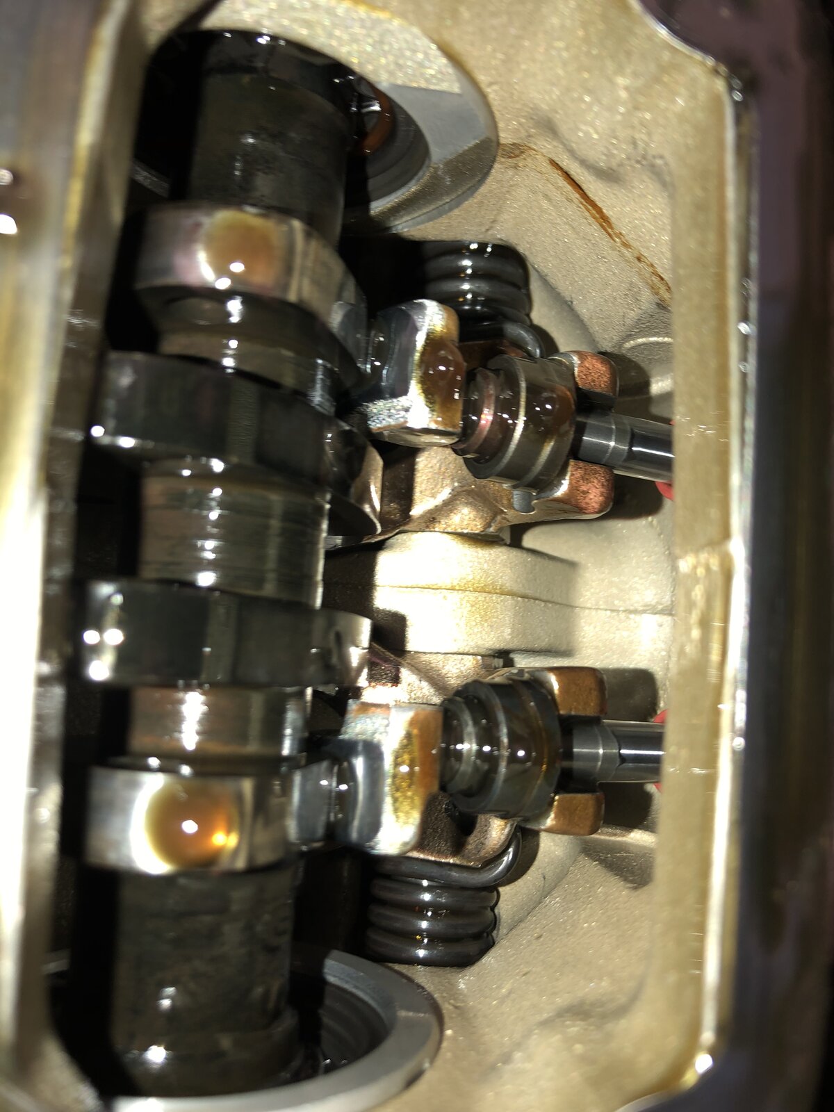

  17. So, while the little ‘un is having a nap, I got down the shed to have a bit more of a look.
    Good news is the vertical belt stayed on, but looks like the tensioner is turned in the wrong way with the belt almost touching?
    Then I took off the rocker inspection cover off of the horizontal and there doesn’t seem to be anything glaringly wrong in there, Which so far looks like good news! Luckily this happened at about 15mph as I pulled away from the lights and not on a good run!
    More strip down to come, when I get some spare time.
  18. The vertical belt adjuster is correct, they are turned anticlockwise to tighten.
    Steve
  19. Cheers Steve! Looks bloody close, so a wrongly adjusted one must be like a fag papers width
