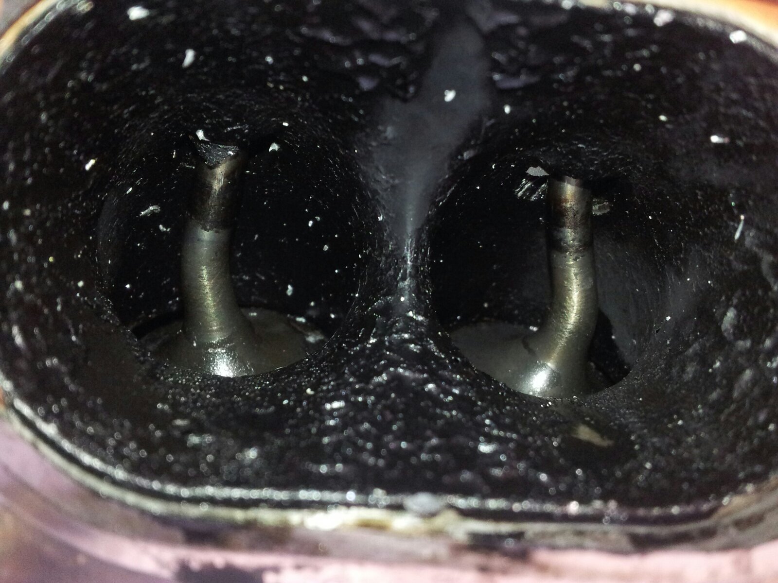

  3. I've fixed loads of engines that have dropped a valve or two, where there is a large bit of metal occupying the same space in the squish area....not a single one of them has had a big end gone or a bent rod etc.
  4. Only bent rod I have come across is a water ingestion, hydrologic lock.

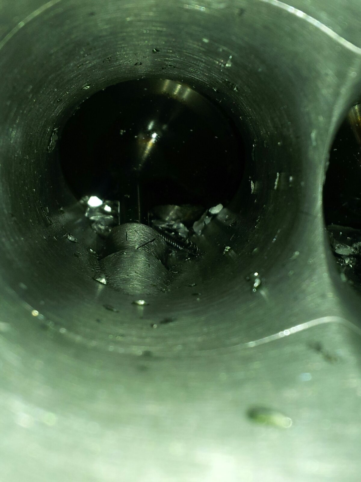

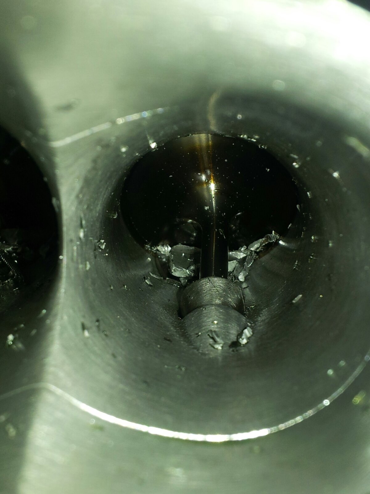

  5. I assume you have found the 2 broken bits of valves. ???
  6. The damage on the exh valve looks like historic erosion over time by heat. Probably by being around the spark plug area where the flame area is strongest and hottest.

    My thoughts exactly but the fact that the exhaust cam won't turn indicates contact.

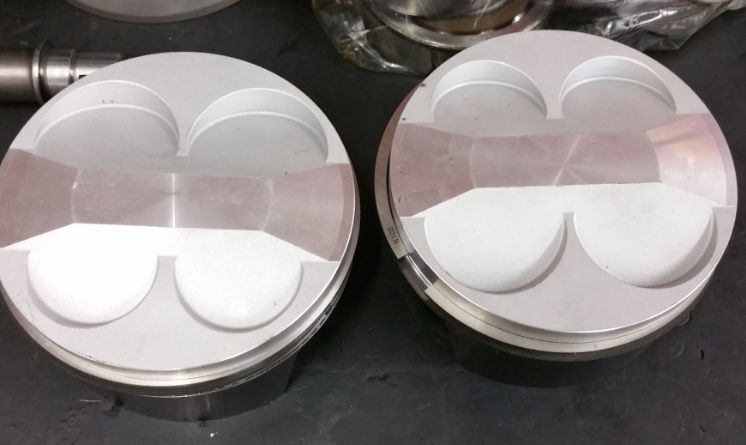

  8. This had a bent rod...

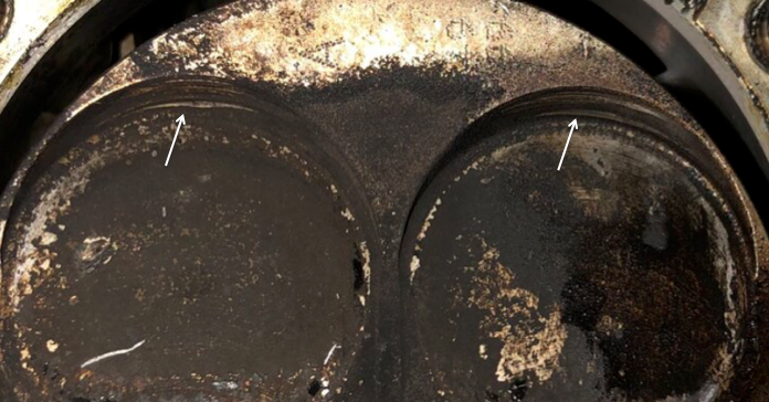

  9. You can see the contact (poss. ally) on the outer edge on the exh valves (furthest away from plug) along with a slight bright mark on the corresponding part of the piston pockets.
  10. my point is you cant just stick a couple of valves in it and put the head back on.. it wants stroke squish and CR checking and i would probably go with a bore polish/hone/clean up and new pistons..... maybe even a 853 opportunity? might even be cheaper
