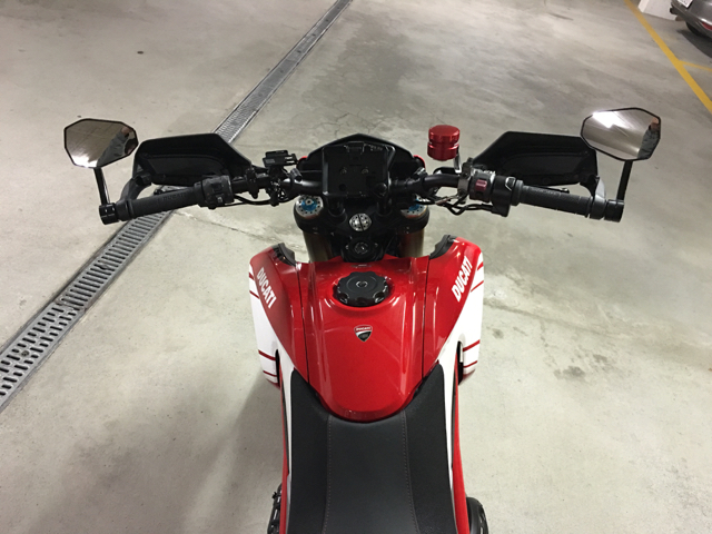

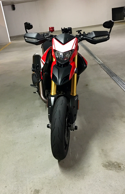

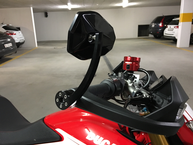

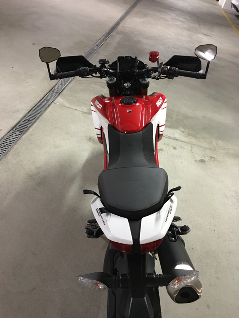

  3. Mounted bar end mirrors to my 939SP. Had the 821 and that is one thing I didn't changed but now finally made it. Did mount other mirrors on the normal position, and ended up not liking them. So I went for the Highsider Victory EVO bar end ones.
    If you do the pair you only need to invert one between the stem bar that holds the mirror and the adapter it is straight forward.
    What was not that straight forward is that these come with several rings and parts to suit all inner sizes of bars. So the 2nd smallest was the one for the hyper. Did tried it and was not sure it did held it into position right.
    Instead I took the OEM bolt and its two bushings that hold the bar end in place. It worked well and it holds it firmly into position.
    Now I am finally happy and feel it goes better with the bike.
    Here the pics:
    Highslider Bar end mirrors 2
    by Ampj8 on Ducati Forum
    Highslider Bar end mirrors 3
    Highslider Bar end mirrors 4
