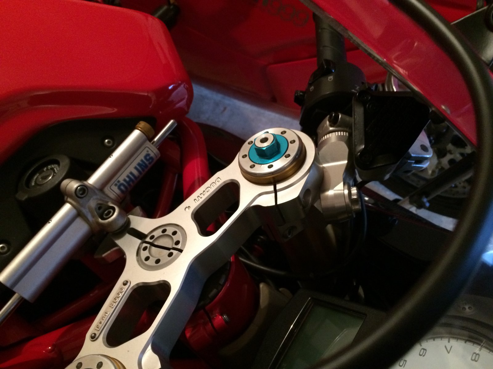

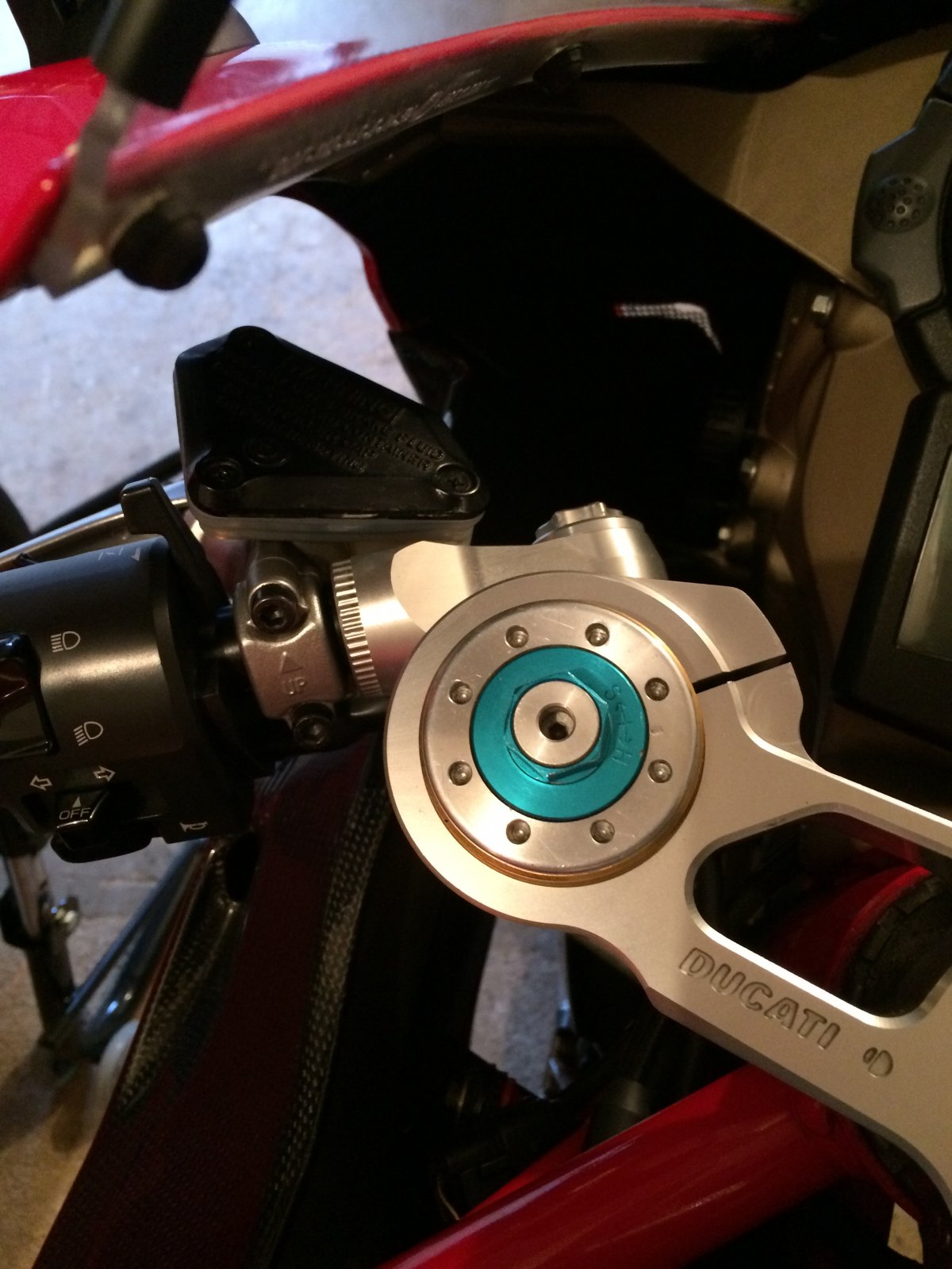

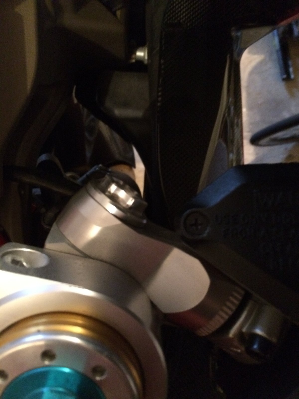

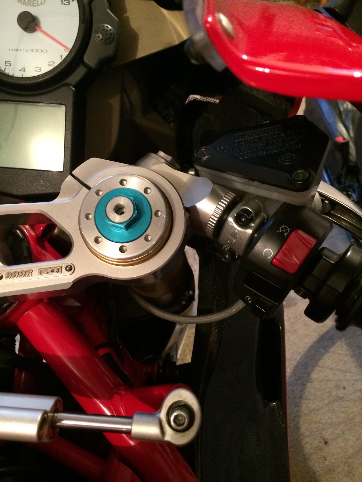

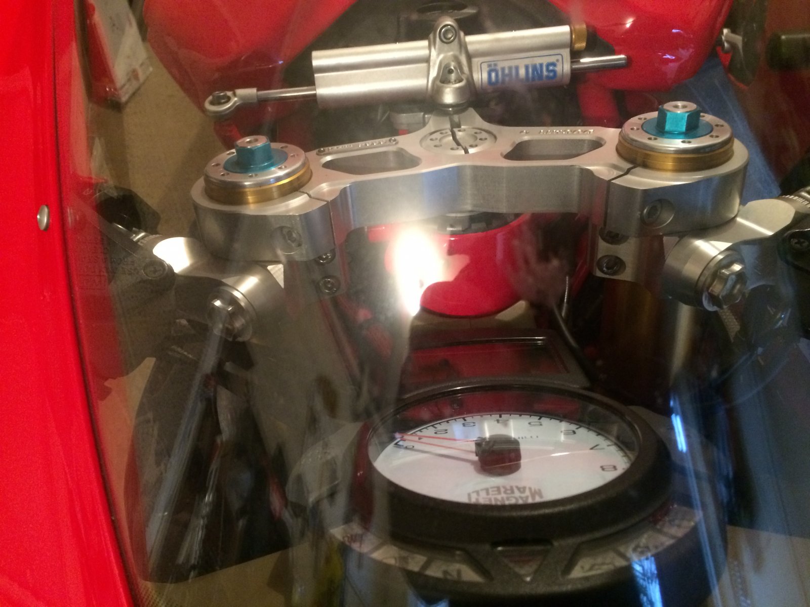

  17. View attachment 63593 View attachment 63594 View attachment 63593 View attachment 63594
    Hi H, As promised pic.s of bar's View attachment 63590 View attachment 63591 View attachment 63590 View attachment 63591 View attachment 63592
    Hi H. pic's of bars as promised

  18. Anybody got anything new on this?? My neck is not improving with age...
    The Gilles only lifts the bars by 10mm according to their site - not a lot of mm per pound...
    The Helibars offer more - 1 1/2" but still expensive for what they are - unless someone has some they'd like to sell me...
    This seems like much better value but how do you know exactly what you're getting??
    https://www.ebay.co.uk/str/tophome-global/CNC-Clip-ons/_i.html?_storecat=5147760012
    These seem more reasonable but for an 05 rather than 03 and 40mm sounds a little ambitious. They say you don't have to modify the fairing but what else might you need to do??
    http://www.emotouk.com/ducati/handlebars.htm
    Anybody tried something similar they could recommend??
