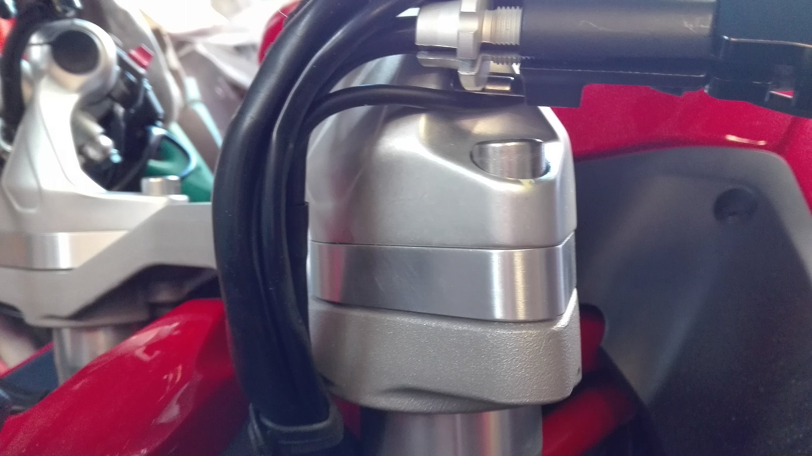

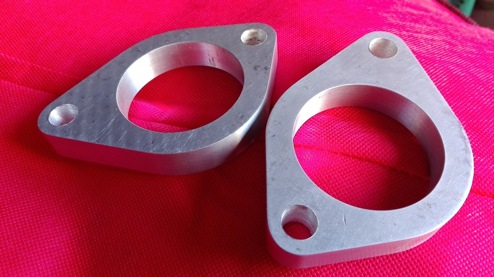

  1. I had fancied fitting bar risers to the Supersport to slightly improve the already very good ergonomics but was bit put off by the £80 price being asked for a couple of 15mm alloy plates with a few holes in them.
    So I drew up sketch and a friend made them for me for the price of a couple of pints.
    This is them fitted.

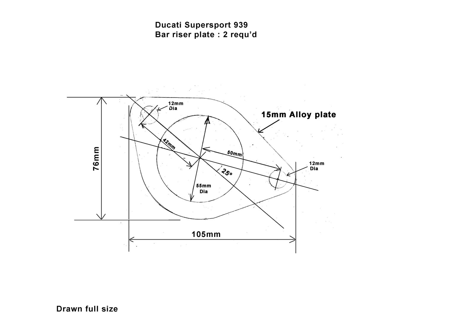

    And this is the sketch if it is any use to anybody.
    I'm not a draughtsman but it is near enough. I made the bolt holes 12mm to allow for a bit of alignment.

  3. Look very good, I'd be interested in how they feel once you're able to get out on the bike.
  4. What do you have to do to fit them?

  6. David?
  7. What's this? a 'Supersport' without clip-ons?? Hailwood will be spinning in his grave..... outrageous :D
