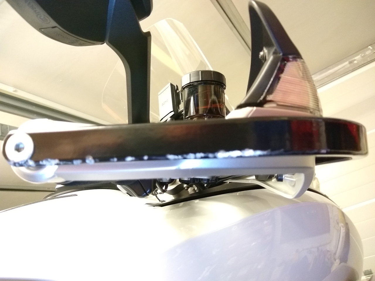

  1. I dropped the bike on Saturday, a zero speed topple over when trying to get of the bike when parking in a uneven, gravel lay-by. I manged to let the bike down reasonable gently. I'd removed the panniers and pillion foot peg hangers so the bike laid very flat to the ground. Luckily I was riding with two mates who got the bike upright for me. The good news is that the Barkbusters (handguard protectors) took the most of the impact

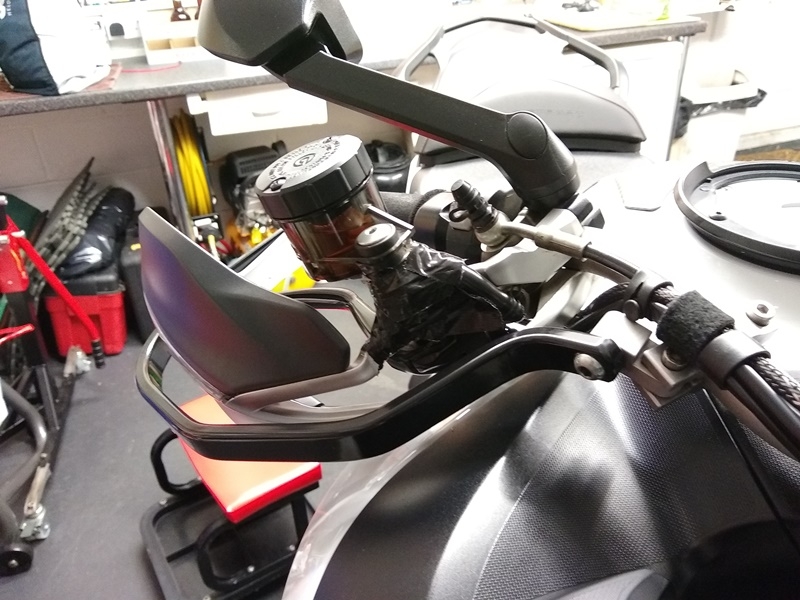

    Unfortunately the front brake reservoir mounting broke on the plastic handguard, probally from man handling rather than impact with the ground. I did a temporary repair using some duct tape, which I carry under the seat (wrapped around an old 35mm film container which contains spare fuses).

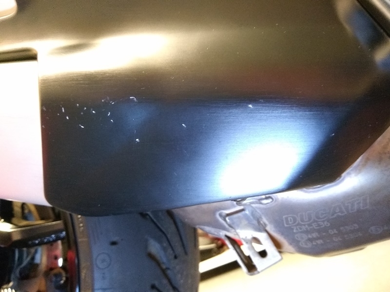

    The only other damage was a bit of gravel rash on the exhaust cover which will "polish out" as I'm not spending over £200 to replace. The foot peg and rear brake lever also touched down but into mud so weren't even marked let alone bent :)
    So my my investment in a set of Barkbusters has saved the day again. The last time was on a tour of Tuscany in 2014. The bike (MTS1200S MY2013) was fully loaded (panniers, top box and tank bag) with my wife on the back. Another zero speed topple on gravel on a small side turning. The Barkbusters saved the bars, lever, mirror etc. and the panniers got a dose of gravel rash. I found out when I got home that an internal, plastic, support for the rear pannier lug was broken which was the reason for a bit of movement of the pannier which I didn't bother investigating while on tour.

  8. If ever there was one obvious design change I would make to the otherwise excellent Multistrada is the mounting of front brake and clutch reservoirs.
    They should not be attached to the plastic handguard but on a metal bracket mounted to the brake and clutch lever assembly such as the Monster or other Brembo equipped Ducati.

  17. Peter - I still think it would be worth looking at alternative mounting for the brake and clutch master cylinders. There is a threaded bolt that could be used I would think. That's the weakest point of the design.
