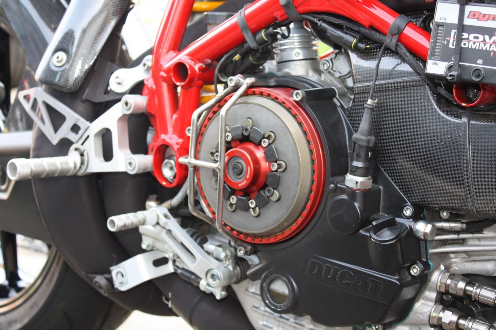

  7. I like the 48 tooth basket although the plates a lot more money and finding them isnt easy . Makes a different noise to the 12 tang one some like it some dont but it looks and works fantastic . IMG_1241.JPG
