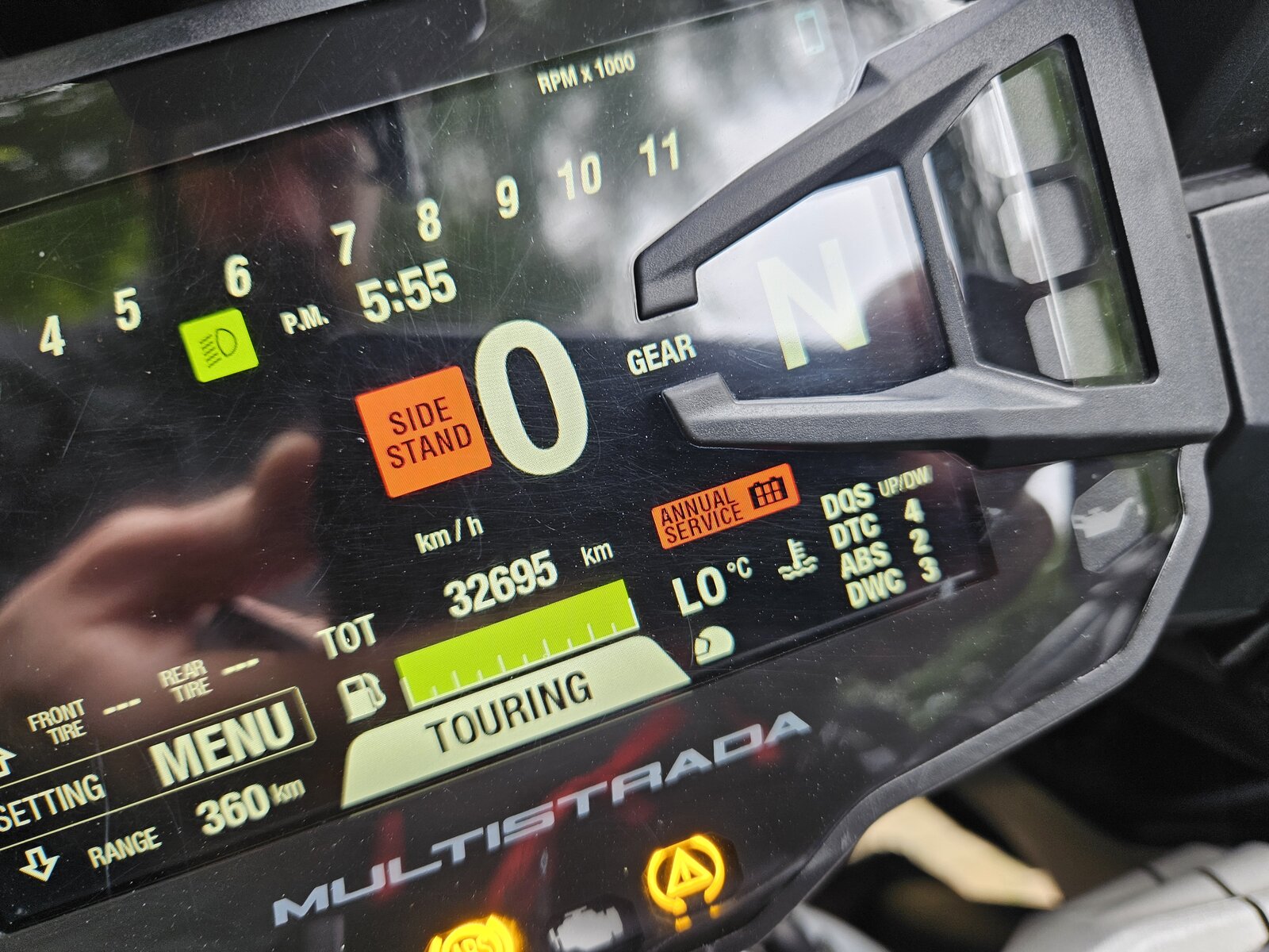

  1. I've just had the desmo done last week, yesterday I installed a JMT lithium battery and now I've got an annual service indicator as shown in the pic. Is this a call ducati up and pay to have it cleared jobbie?
  2. The date and time reset to 2001.... Problem solved. Leaving thread up for future questions :)
    #2 freshage, Jul 14, 2024
  3. That's annoying, OBDStar should be able to clear it, or any bike shop with Texa I believe.
    Or whoever did your Desmo?
  4. Oh ... :)
  5. Change date as above, works a treat
  6. Removing the battery will do that. Defaults to earlier date until reset.
