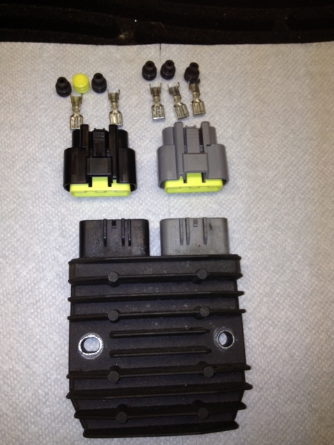

  5. see what the general consensus is, but it could be worth the extra effort of fitting a Shindengen FH012 or FH020 etc as they run cooler and are a good investment. Downside is matching up connectors and slightly different mounting. I will have a scan for articles re: SS fitment. They are so reliable that fitting s/hand is worth considering but bear in mind there is a copy of this as well.. In fairness to the copies, I don't know if they are good or bad.

  8. My first replacement was an Electrex the light flickered a couple of times about 9 month's after purchase, e-mailed Electrex and got no reply it completely failed soon after the 12 month warranty, e-mailed again with no reply. Fitted a Shindengen Mosfet FH020 8 years ago with no problems since.
    The wiring is straight forward.
    Steve
