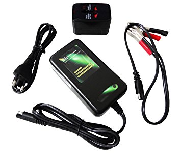

  2. The only current charger recommended is the Skyrich one which strangely is a lot cheaper bought from Ducati than from Skyrich themselves. Fore warned though, the charger does not come with the DDA plug lead which you have to order separately. Andy
  3. That looks identical to the one I bought, the benefit is that it is a LiFePO battery maintainer so you can leave it plugged in to manage the drain caused by the tracker. Just need to get yourself either the lead to hard wire to the battery terminals or the lead to plug into the DDA socket which I think is under the seat. Andy

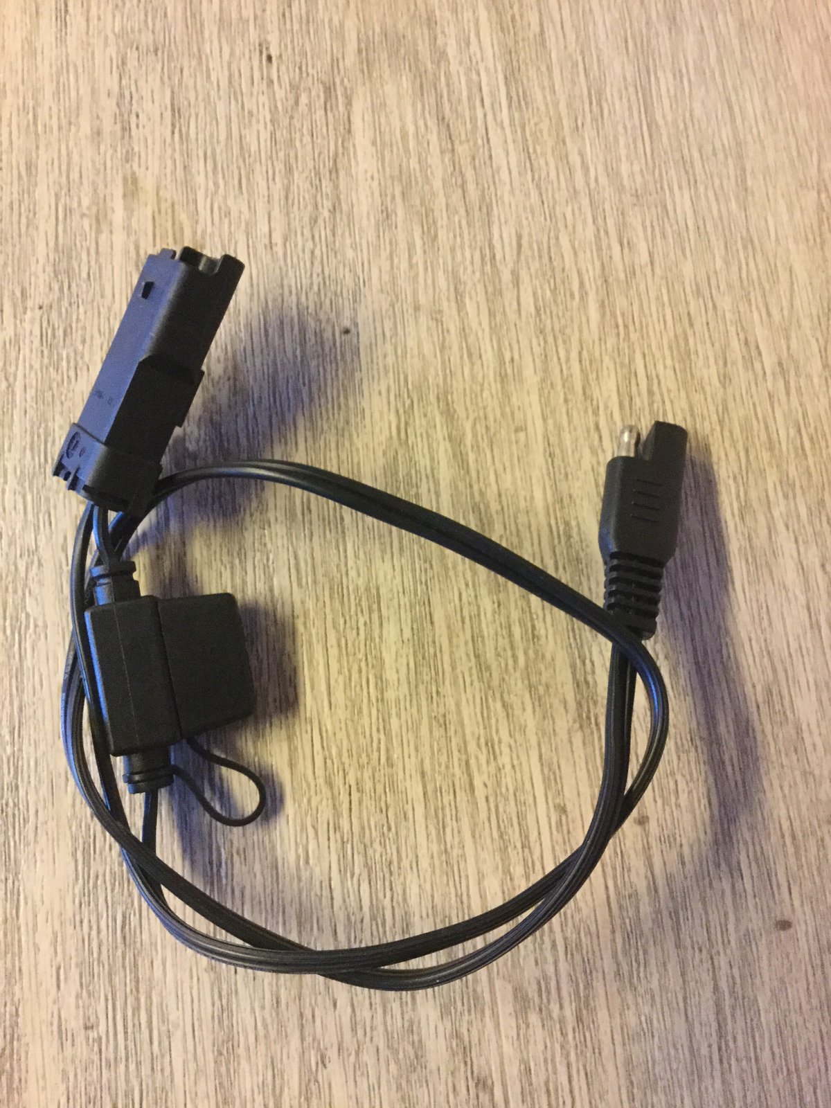

  5. Never mind, I guess I can use this from my old Ducati charger on the new V4S?
  6. Oops, my 1299S has been on my twin optimate 3 with no trubbs
  7. Yep although I would check the two ends of the leads to make sure you have the right polarity. I only mention it because whilst hard wiring a sat nav, the plug lead I have on the bike is opposite to what I needed. Andy
  8. A recent technical note issued by Ducati to UK authorised dealers (and I guess workshops) states that the Skyrich battery charger is the only one recommended for the Panigale V4S and Speciale. The Ducati workshop battery charger part number is the Skyrich charger. Andy

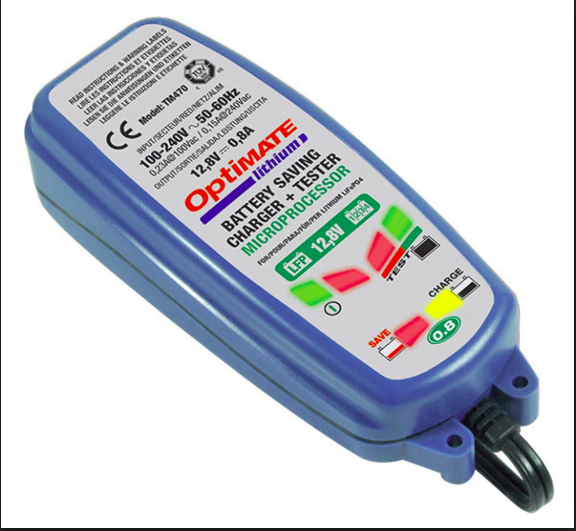

  15. And the regular V4 (non S)? Does that have a plug under the seat already to charge with an Optimate for example?
    Connected to the battery direct (fused).
