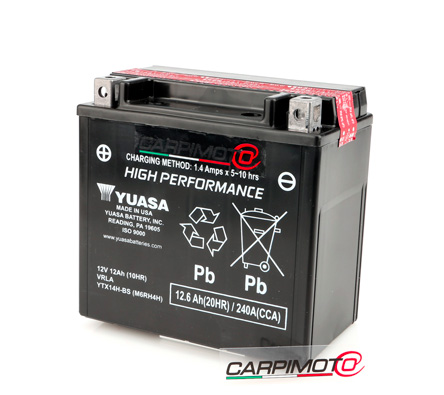

  4. Use these High Performance Yuasa's - buy from Halfords with the Trade Card...
  5. That is useful to know because I did look on eBay and there is a lot of cheaper stuff but you'd stick to the well known stuff.

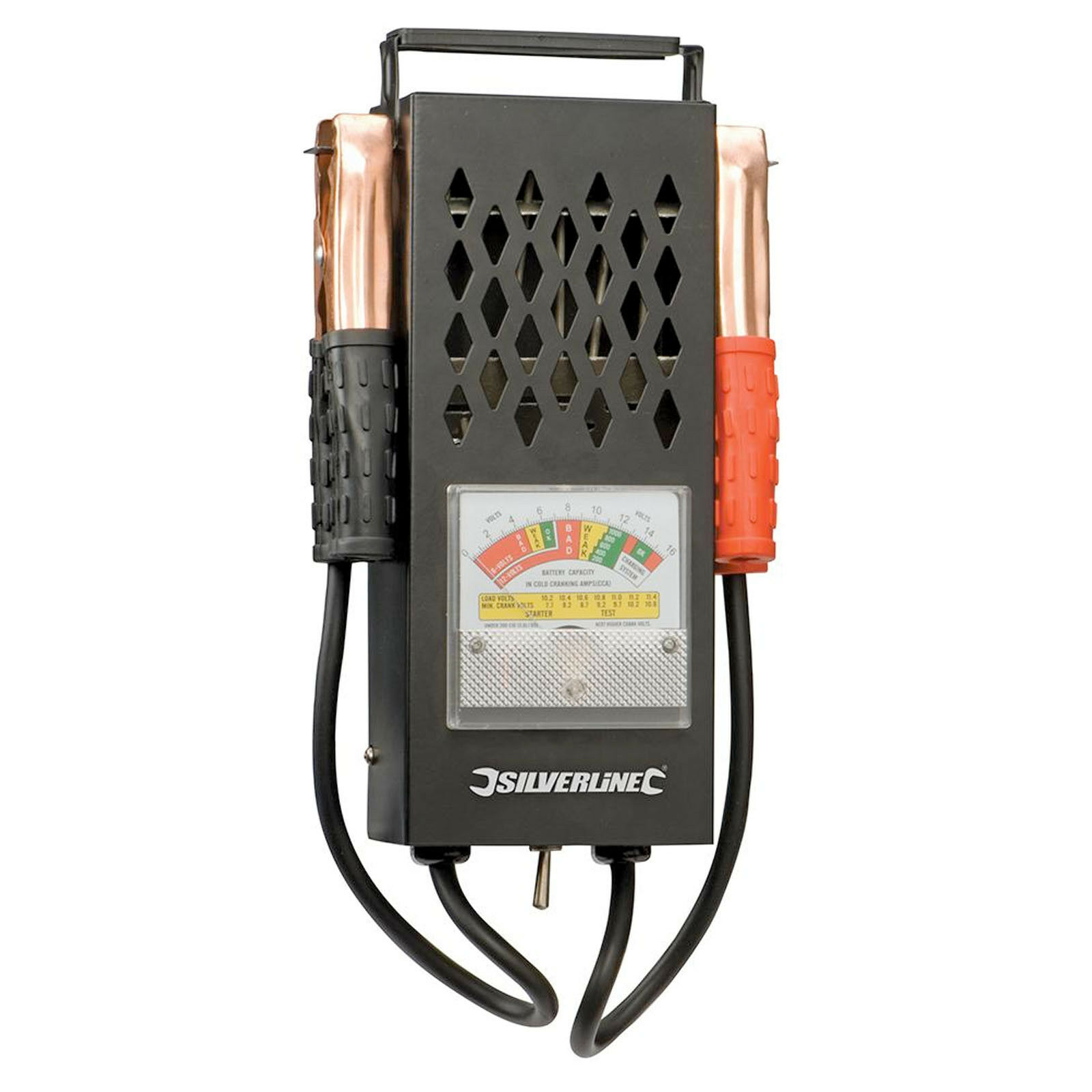

  13. Sorry Dudes.... it's all smoke and mirrors without something like this...
    £16'ish
    Silverline Car Battery & Alternator Charging System Tester for 6V/12V Batteries https://ebay.us/wd6qc8

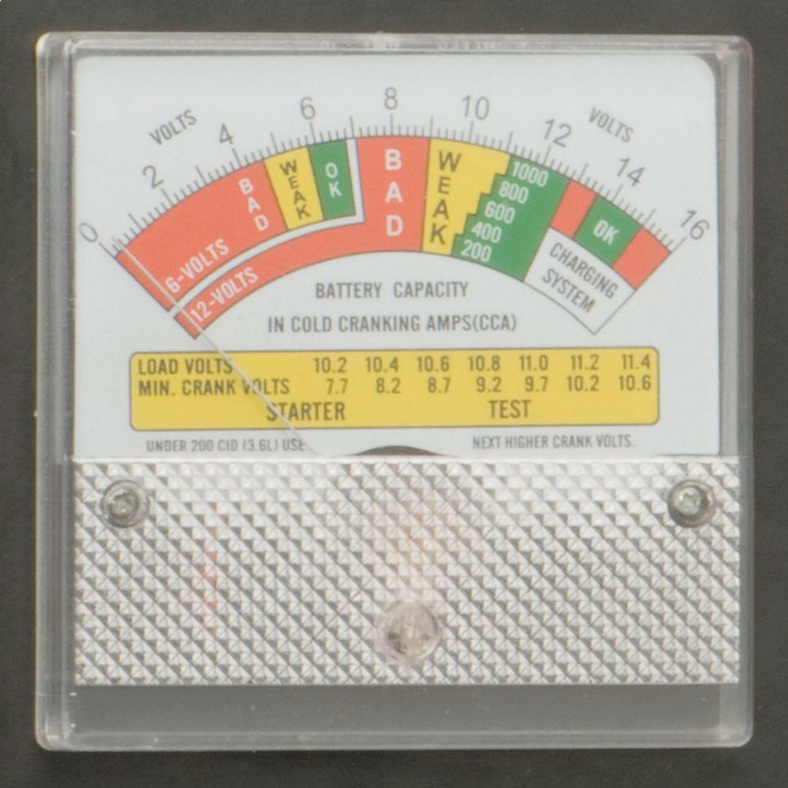

  16. Sounds good....
    I've always wondered about these sorts of testers. Being an electronics engineer I was concerned that they don't present a decent heavy load to the battery... just look at the leads. That said I've never tested one against the old fashioned one pictured above.
    So that's just a feeling, not anything I could prove or want to argue about.
