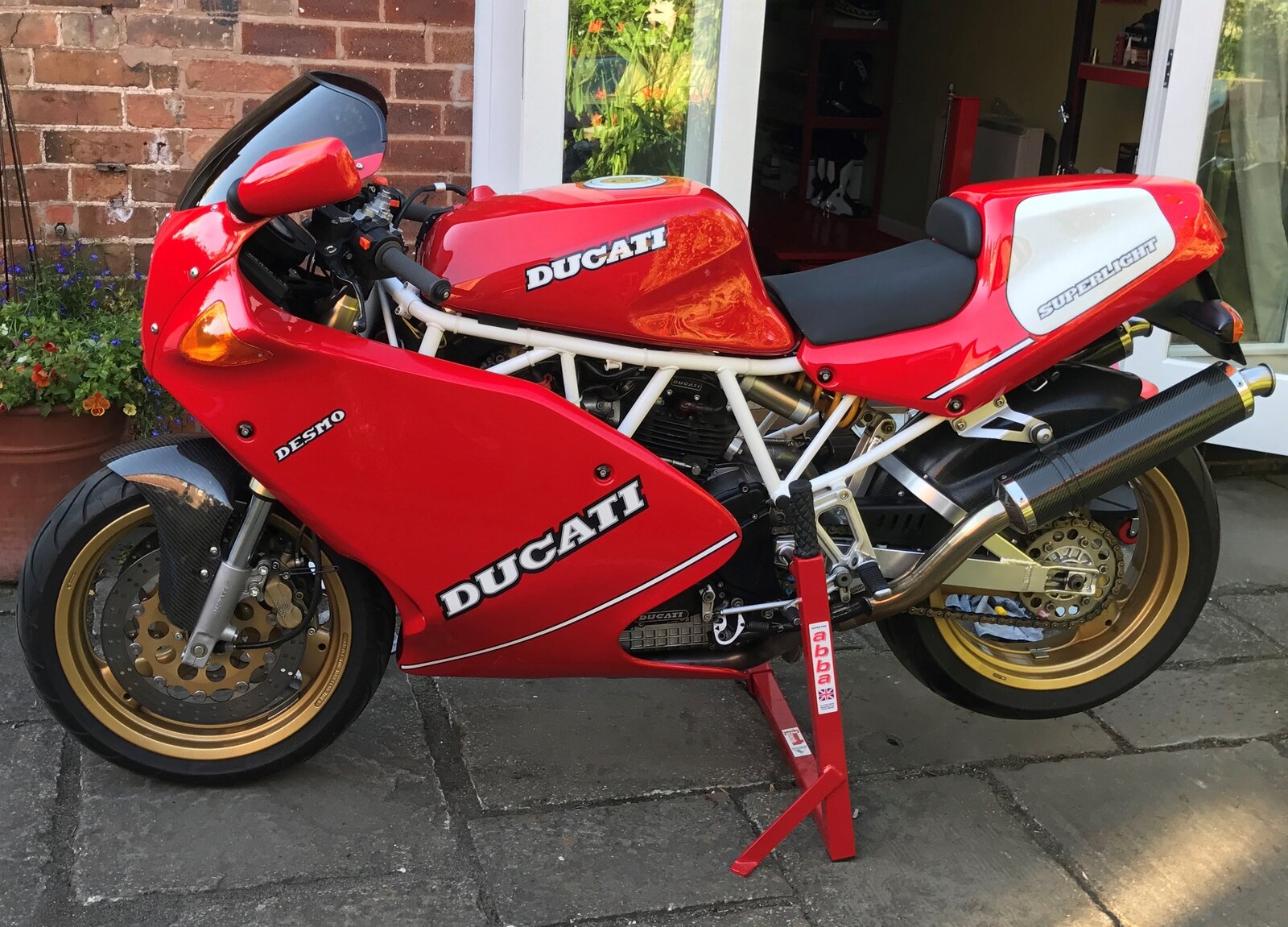

  1. hi all. just bought this 900SL which is gorgeous and was featured in Practical Sportsbikes a few years back when it was restored. However don't think the battery has been changed since and starting is an issue. Wondering if anyone had any recommendations for a bike that obviously isn't a daily rider :) superlight 1.jpg

  15. Real nice looking bike there mate.. more pics wouldn't be frowned upon!!
  16. What a beautiful bike :heart_eyes:
