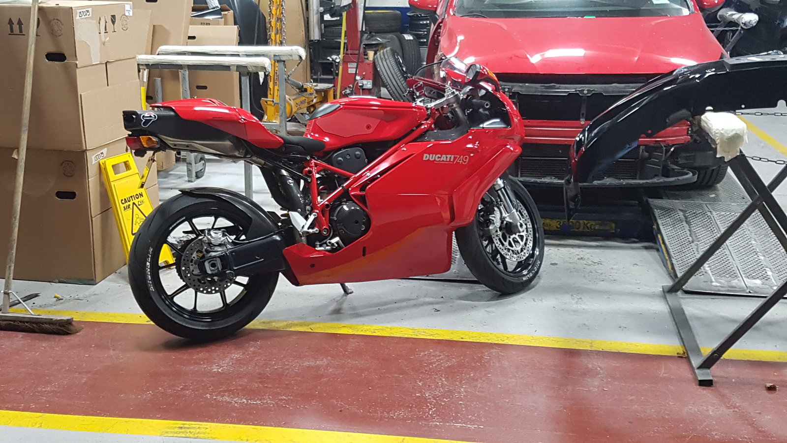

  1. Hi all, I've had my 2006 749 for just over a year (brought from a forum member) the bike has been faultless, but on Friday I took the bike into work, it started perfectly in the morning (I fitted exact start cables when I got the bike).
    10 hours later I got to the bike turned it on and it wouldn't fire up, the voltage was reading low, it started up fine with a booster pack though.
    I assume the battery is at fault but don't want to put a new one on and have that fail aswell.
    Could someone explain how I can check the reg, rectifier etc.
    Thanks all

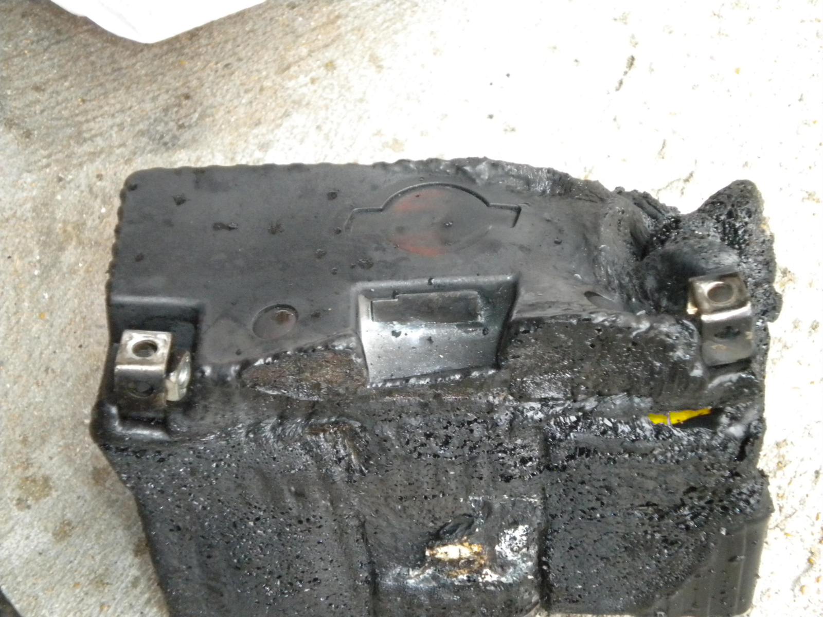

    this a 'top quality' Lithium Battery from a Ducati 1198S but they do seem to burn more 848/1098/1198's than 749/999's to be fair :)
