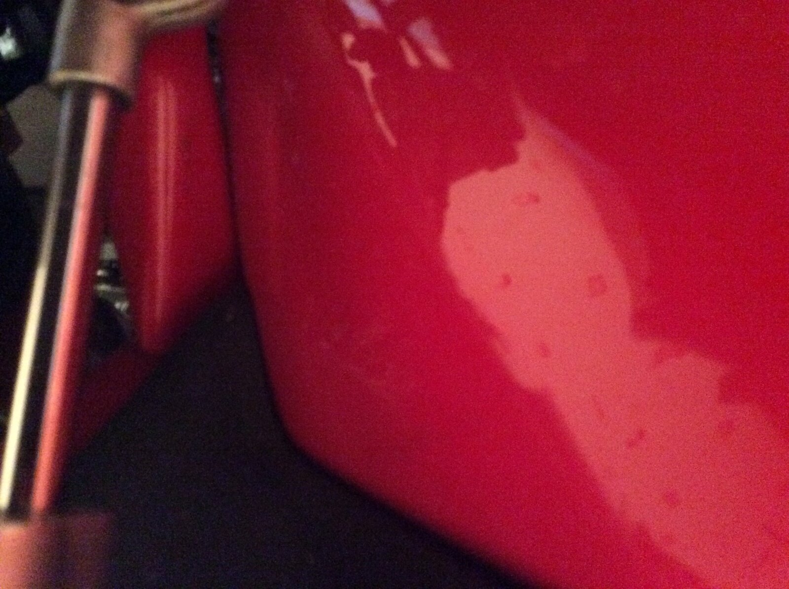

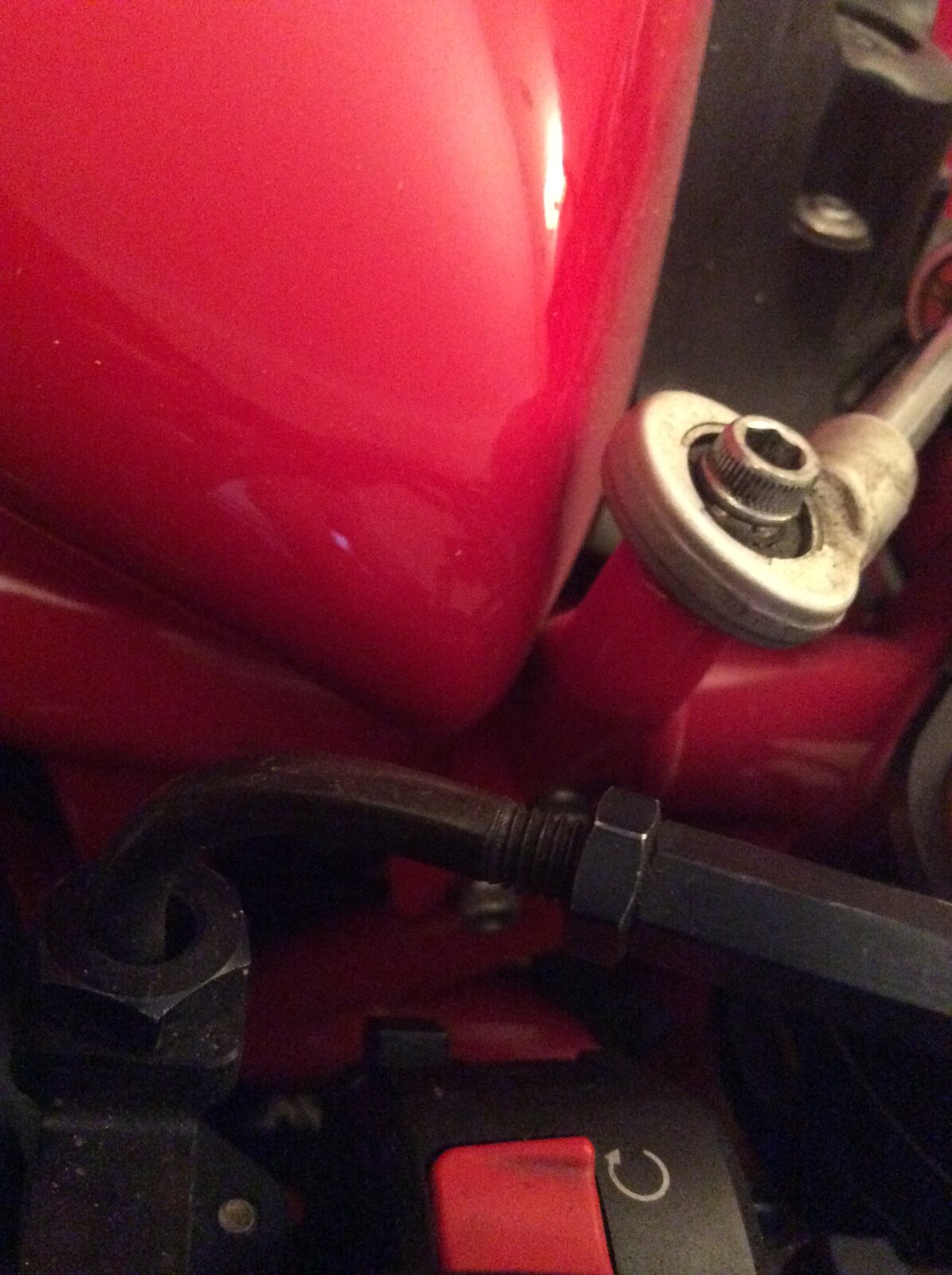

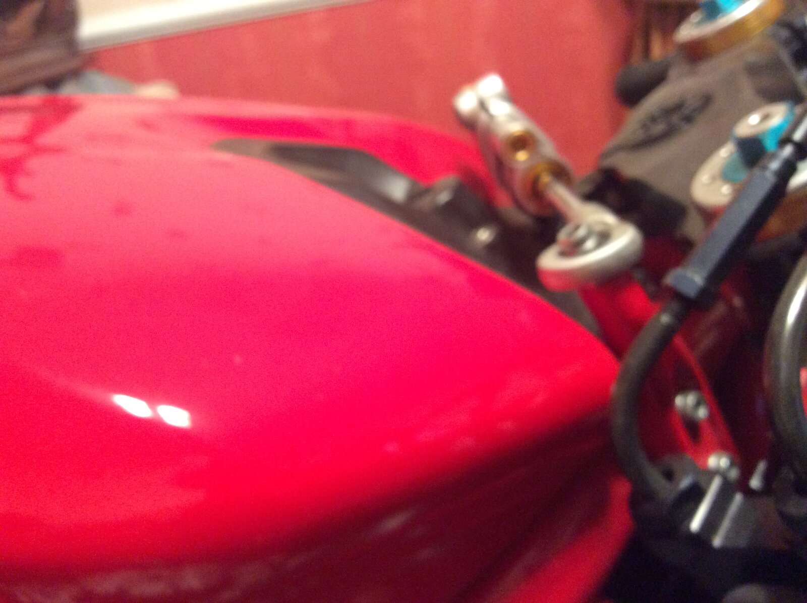

  7. As far as I have seen reported, the swelling is not detrimental to the safety of the tank. The tank eventually rubs against the steering damper bracket. This is my track tank and the steering damper bracket has a 1mm washer behind each bolt. If I remember correctly, the gap should be at least 3mm maybe 4mm. Andy
    84DB517A-6810-4AB4-80ED-6834647A76AC.jpeg DF78E731-2E34-4E14-8823-06D9CCCC1A07.jpeg 68D132AD-4D13-4354-A05C-E19CAC756D11.jpeg
  8. Nearly all plastic tank bikes suffer the same fate, not just Ducatis.
    Something to do with the composition of the plastic and its willingness to absorb moisture from the ethanol in the fuel which absorbs moisture from the air.
    Not dangerous unless it's an extreme case. Just wait until it's all E10 fuel:mad:
