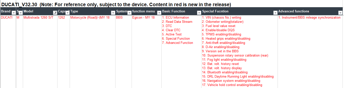

  4. OBDStar can perform some functions on the BBS. The most recent update I've downloaded, late May '24, shows the following for my Multi. These are new functions in that release. If you want me to check another model then let me know.
    If you have multiple Ducatis then the £345 iScan version would work with all of them.
  5. that looks like what I’m after with the BBS synchronisation
