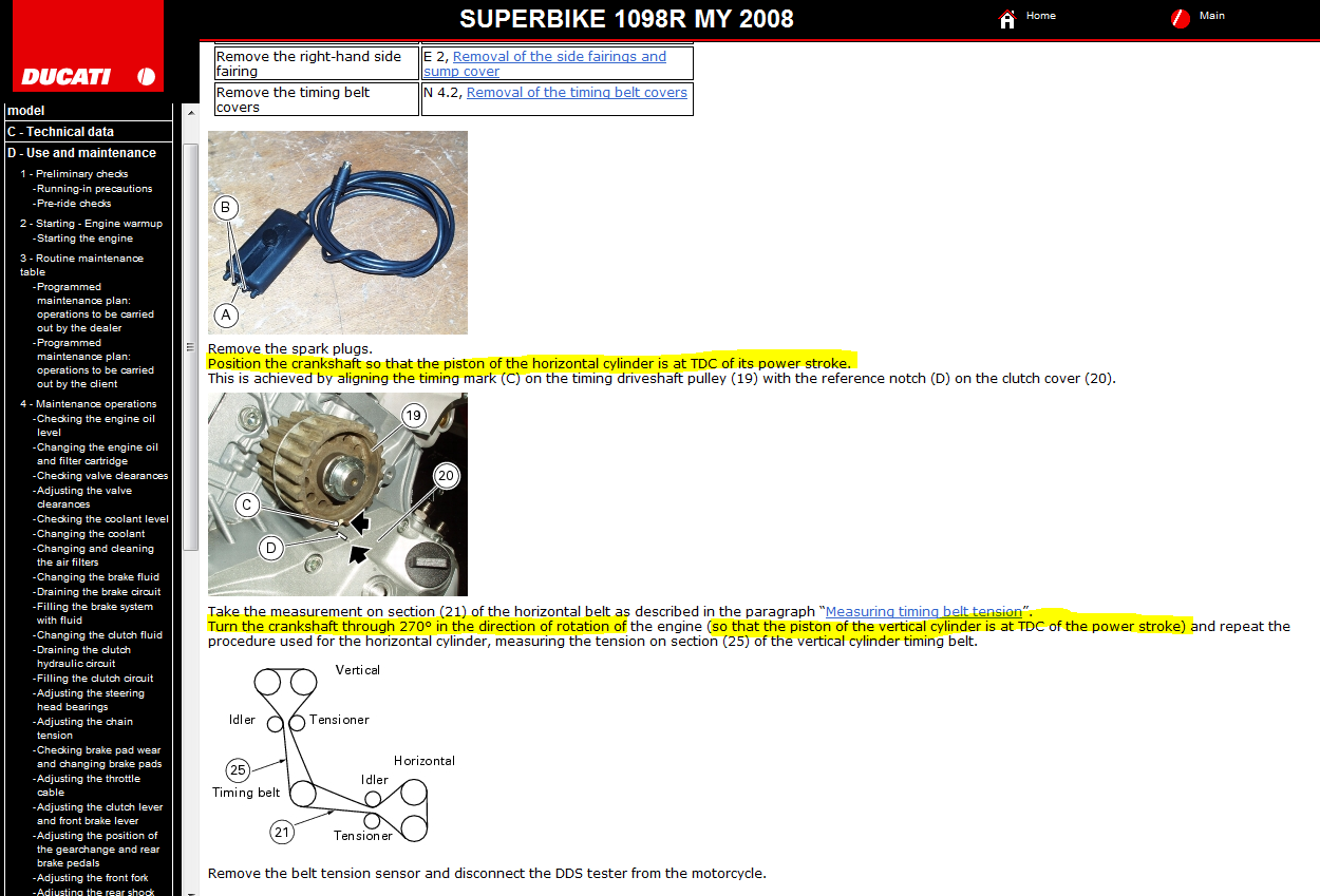

  10. The error relates to the setting of the position of the Vertical Cylinder for setting the tension.
    Basic gist:
    Set Horizontal Cylinder to TDC on firing (compression) stroke.
    Mark positions etc and trake off old belts.
    Put on new belts.
    Adjust/set Horizontal belt tension with Horizontal TDC on compression stroke.
    The error in the video comes next: video says "Turn crank 90deg backwards" and then do the tensioning...
    This does put the Vertical Cylinder to TDC BUT...Not on the compression stroke!
    It should instruct to turn crank 270deg forward to put the Vertical at TDC on compression stroke.
    See extract from 1098R Workshop manual:
    Not sure what the effect of turning 90deg backwards has on the tension however I thought I would do what the Ducati Manual says rather than the video.
    R

  13. I agree, that is why I stated "Not sure what the effect of turning 90deg backwards has on the tension however I thought I would do what the Ducati Manual says rather than the video" at the bottom of my post.
    CR: anticlockwise rotation of the crank using the crank turning tool turns the engine in the normal direction of operation. This is "Forward".
    Turn the tool "backwards" means turn it clockwise i.e. opposite to the normal rotation of the engine.
