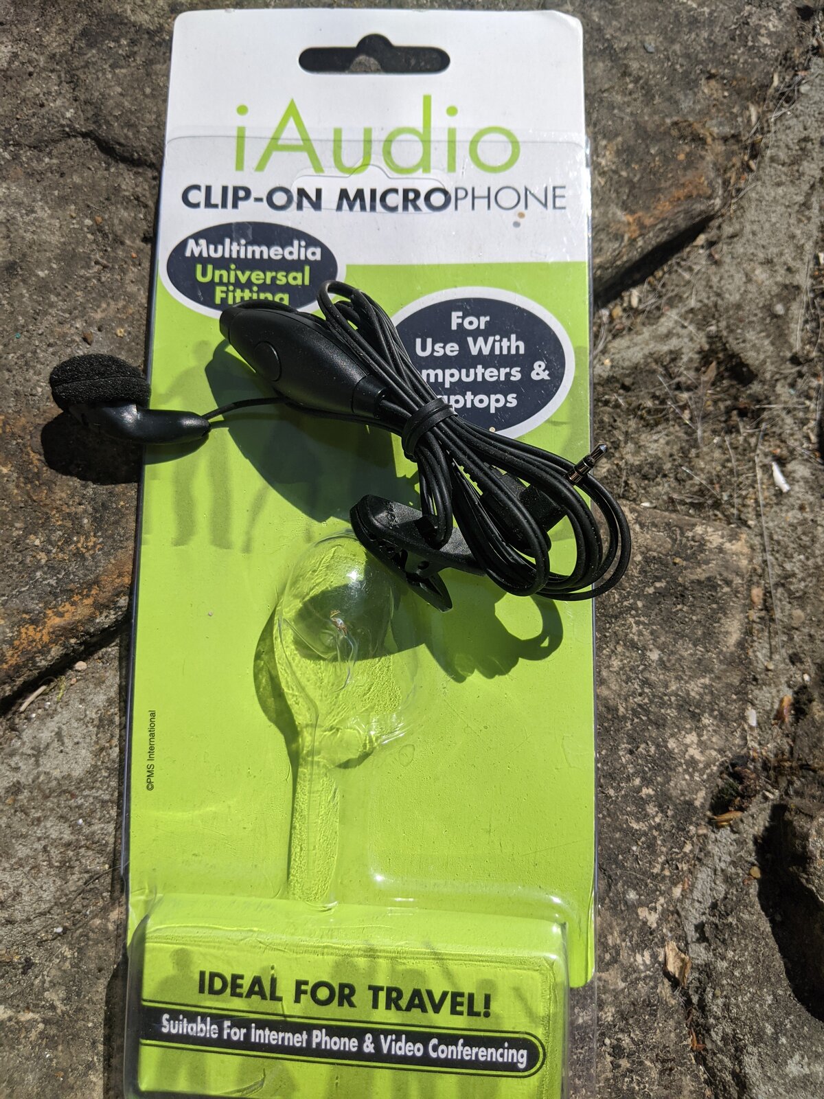

@Nasher I recommend a clip on type microphone for your purpose. Enables clipping to part of the engine casting to enable positioning of the microphone very close to the belt for perfect 'twanging' I got mine from eBay for 99p Inc p&p. Works a treat!
Yep Crystaljohn, I think that's my issue. I've now discovered that I can get the n-track 'needle' option to work with a longer sound, and Carbon drive is the same, so it must be the Mic on my phone not reacting quick enough, although that could carry through to an external Mic. On the plus side, I've discovered I can Humm at 99Hz Nasher.
