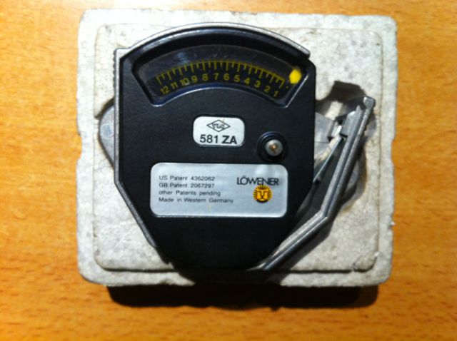

  1. can anyone tell me if this belt gauge be used on the streetfighter engines? what kind of money they worth? cheers

  2. That's the original tool for desmo Quattro motors...748, 916 996 etc. won't fit on the later motors but a very good tool nonetheless.
  3. cheers mate, I take it theres not enough room to use it between cams?
  4. No, and the later belts are all frequency measured. It's a great tool though. Still use mine every week in the workshop. Quick, easy and really accurate. It was spec'd for use on the two valve motors as well at some point, but you can't do the rear with the engine in the frame........
