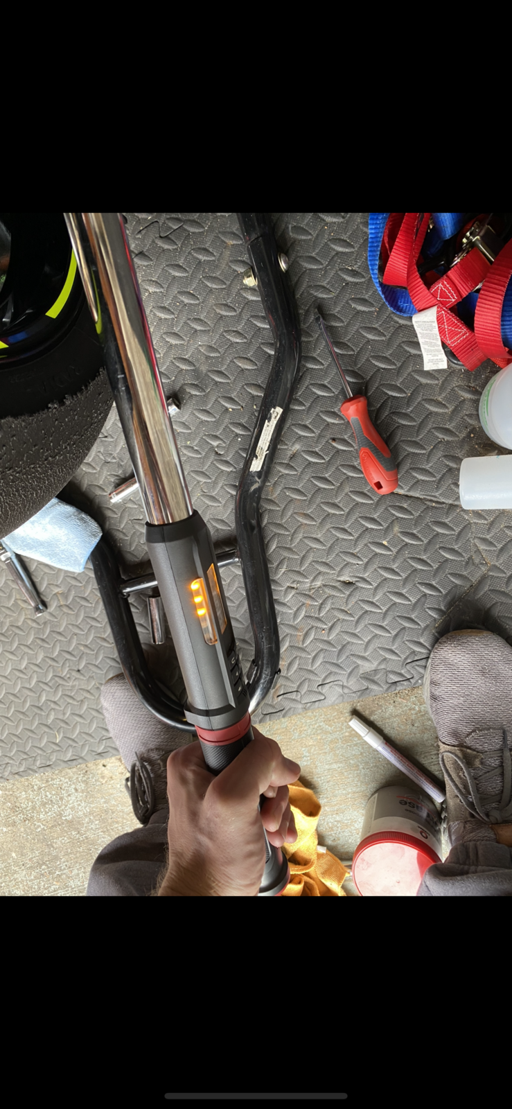

  9. I can’t comment as I’m like a magpie and have a digital snap on wrench :joy:
