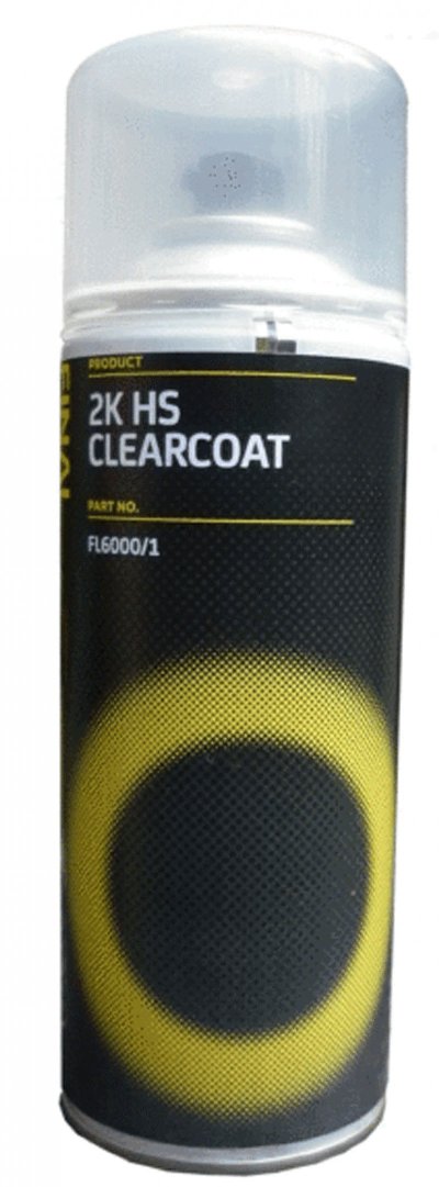

  6. This is the best aerosol lacquer I've used and got good results on CF :upyeah:
  7. Available from? Or is it trade only Toby?
  8. It should be available to anyone, I get it from a local supplier I used to be next door to - Home
