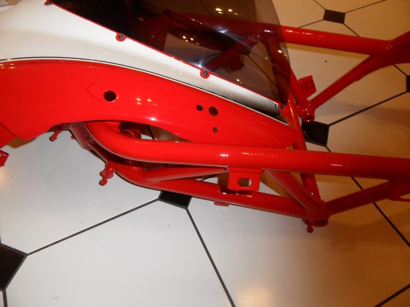

  15. I have had 2 frames powder coated and on both occasions they ended up to orange, to get an exact match they need to be painted.
    Powder coated
    Painted
    And this was a 916 frame that I had coated, different Powdercoasters but same orangey look. And that after using RAL colour cards to get as close as possible
    #16 Mr C, Feb 6, 2014
  16. ^^^ Unfortunately very true, most colour cards are not quite as accurate as you might hope. I went for what I would call the only true red using the RAL chart and it is a shade or two out, but it is Red and not Orange. Most RAL Red's seen to be very Orange in nature.
  17. The painted frame has lasted well, we just keyed powder coating and then painted straight over so the odd chip only shows the orange underneath
