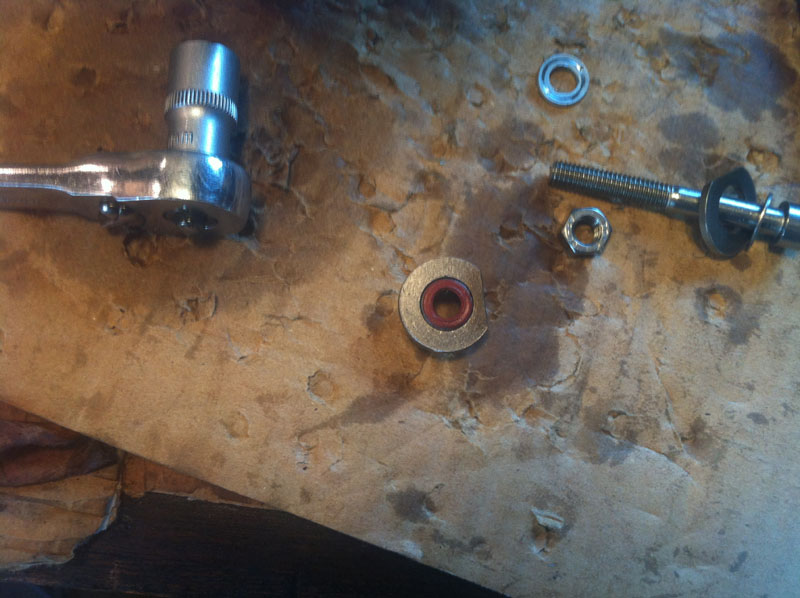

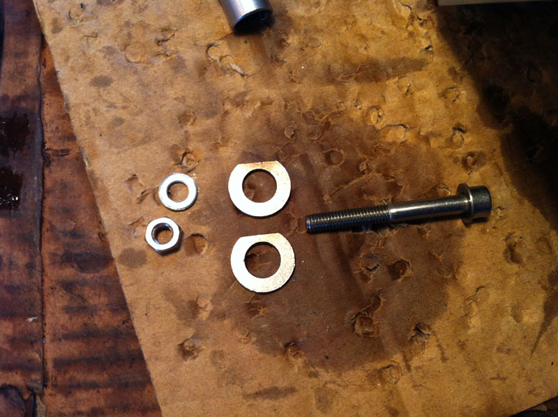

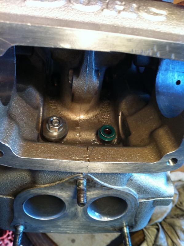

  11. I recently changed mine on the 916. I used a 6mm bolt with a 10mm washer to pull the seal down onto the guide as hitting them on with a suitably sized socket isn't always good enough (which is why I had to change them :frown: ).
    Fit the bolt through the guide with the washer locating on the seal (I had to grind a small flat on one side of the washer to clear the head) and then tighten the bolt until the seal locates fully, I used some oil to lube it whilst seating.
    Pics should give you the idea;
  12. praise indeed from the man in the corner. There would be a need to visually check when you get near to fully seating stem seal as apart from slight increase in effort to turn nut there wouldn't be much other indication? The ability to fully crush the seal is easily available here. My comment comes from a similar approach when fitting guides as I really hate that last half mm before it's fully seated.
