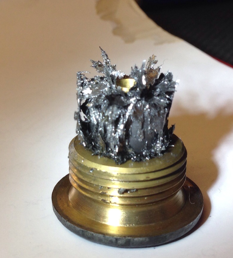

  6. image.jpg One way of telling !!!!!
    My sump plug on my 749 when the big end went a few years ago

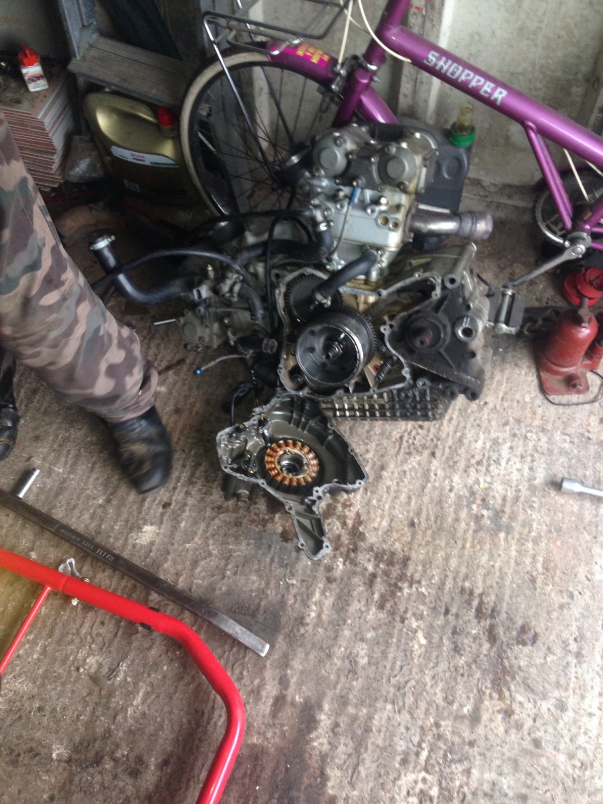

  7. My mains and big ends have home. It cracked my alt cover and I had spikey shards as above, but also creamy sludge on sump plug. Also had vibes. Also had oil pressure light come on. At least it lasted a track day at Donny before it cracked!!
  8. Sounds like it was pretty bad but typical of when mains and big ends go. The annoying part is having to buy a new alternator case into the bargain, I have had three go over the years like this. It gets pretty expensive.
  9. The backing material for the bearings will be steel, that is almost certainly what is on the magnet, that plus crank debris.

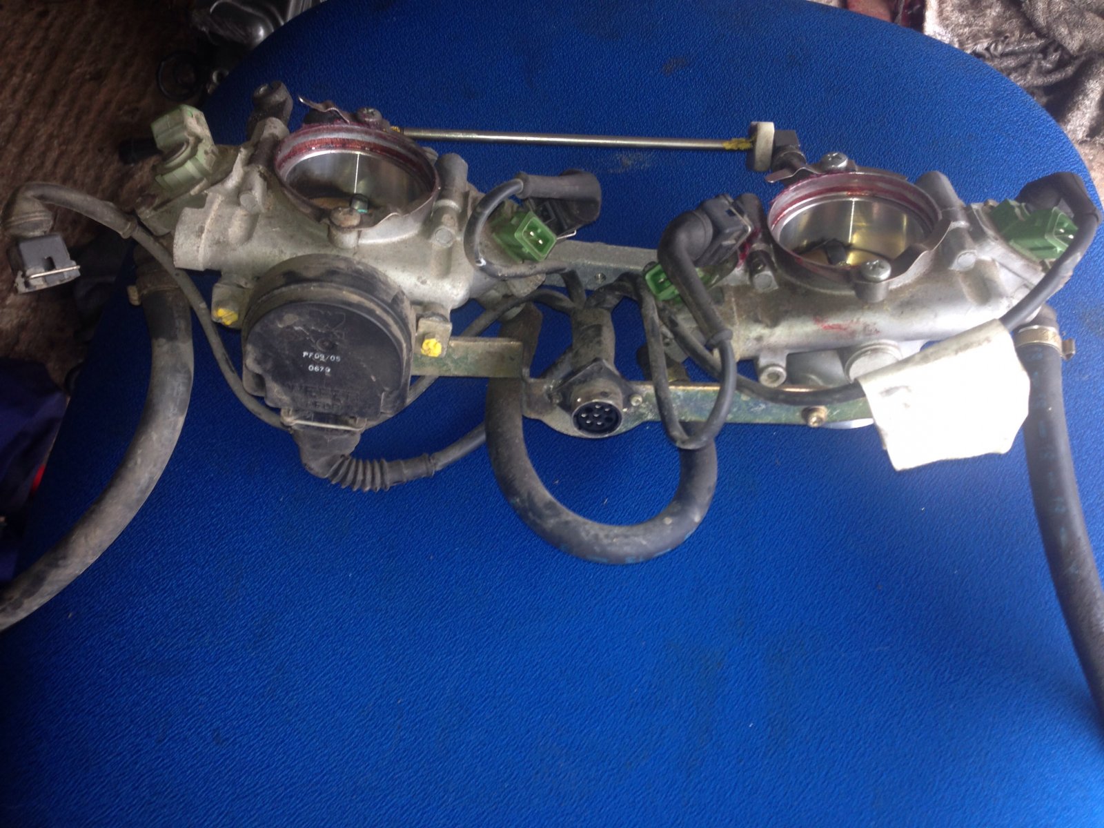

  11. Yeah. I've got a 996 with the bid and mains gone. It didn't sound bad when I des covered it had cracked the alt cover. I have a new cover for it, but it still needs bearings. It has Nichols nuts, no clutch, bit I can supply you with a loom and oil cooler if you fancy a conversion. Be quick though. The throttle bodies are on eBay as we speak, so give me a pm if your interested.
