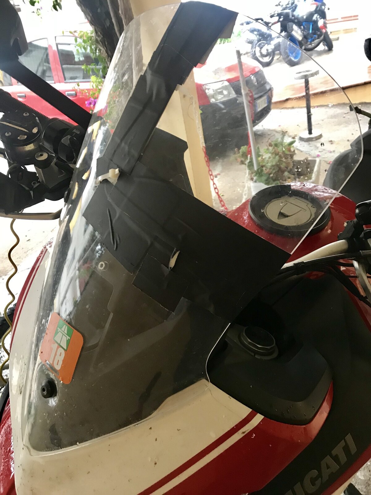

    This was when the bike tipped over and broke the screen on a stone wall, I borrowed a drill and used cable ties and gaffa tape it made it all the way back from Corsica

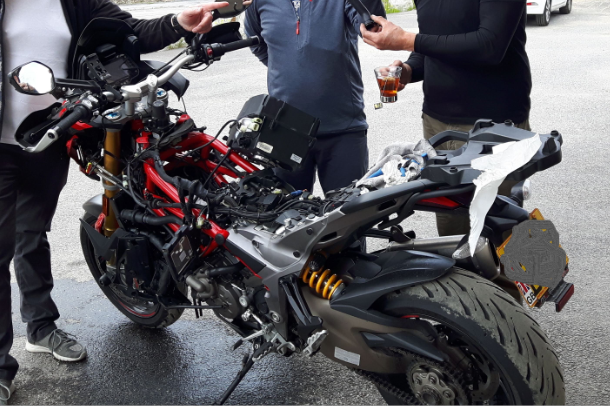

    With the aid of a workshop manual on an Ipad you can do almost anything ....
    Putting it back together was a piece of cake :p
  18. Goodness sake HO, have you ever ridden that bike? It looks absolutely flawless. You haven't had Coman cleaning it for you have you, by chance!!
  19. It was actually a fun day and really good to get to fix it for Jules, and even better when it started up again!
    The workshop manual made all the difference, those throttle bodies were a right b*stard.
