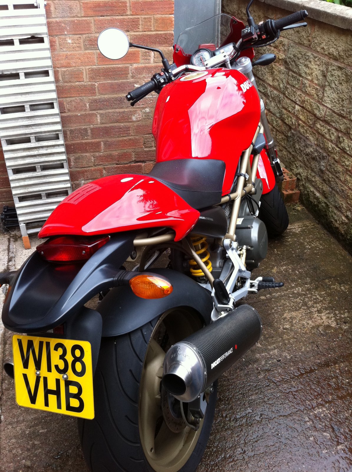

  6. I used gold class on my bike
    Wheels I cleaned with WD40 on a rag
    Degreaser can't remember it was in a red bottle
    Polished with caranuba wax
