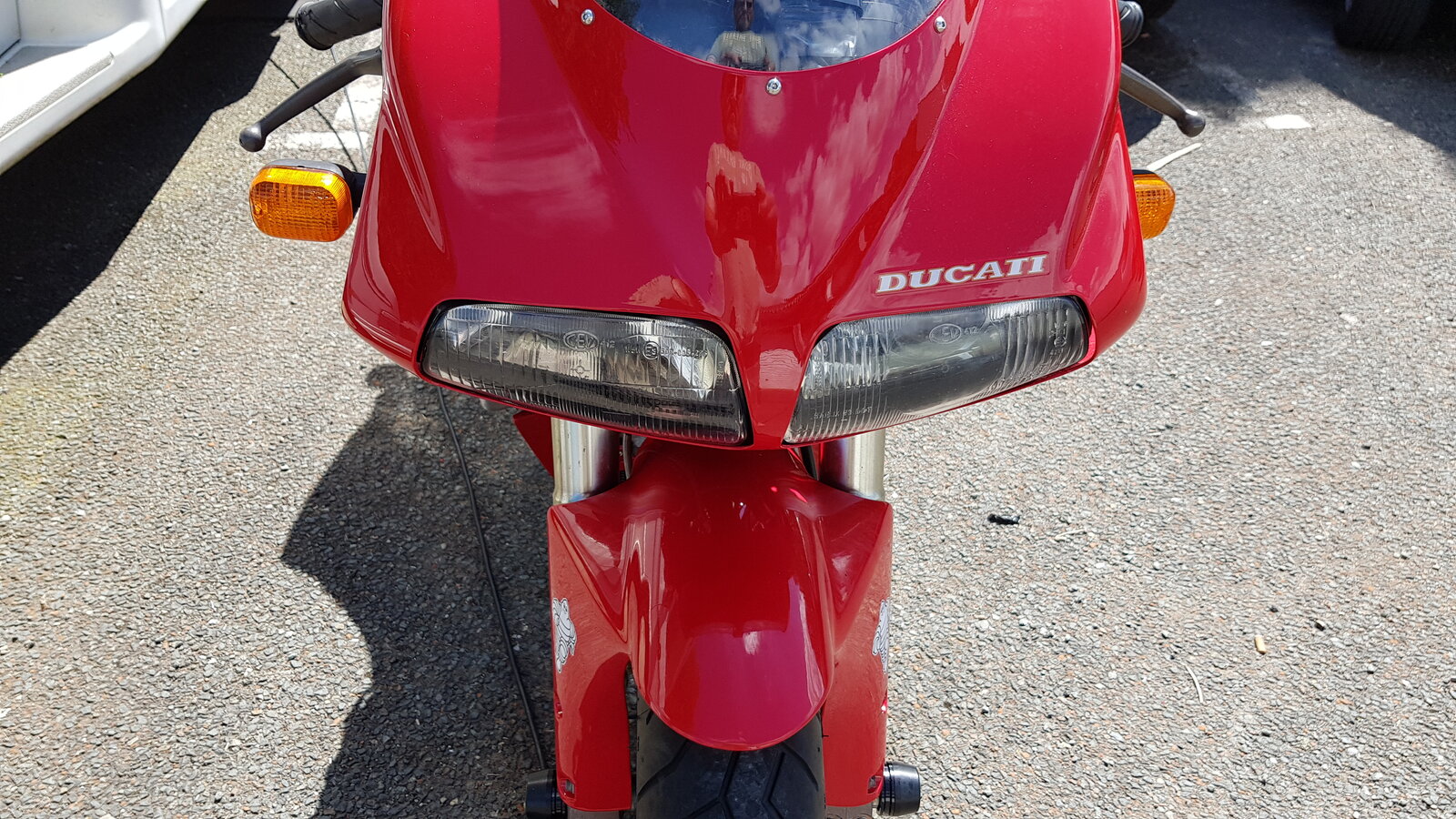

  1. I am sure someone was talking about the paint around the head lamps before but i can not find it .
    My head lamps have lossed a lot of the black surround giving the bike a slight squint eyed look .
    anyone got a idea on how to renew the black..... is it just matt black paint or what .........
  2. Black electrical insulation tape.
  3. Oh yes, that was the answer. :upyeah:
  4. Thank you for your reply. I worry that the tape would just come off after a while ?
  5. Mine’s still good after 3 or 4 years
  6. All righty then we will give it a whirl.......cheers.
  7. and even if it does it’s no biggie to replace. Just make sure the glass is really clean first, either alcohol wipes or meths on some tissue. The tape will stick better.
  8. yes yes yes it works boys, bloody marvelous the tape trick does the business .
  9. Good to know, had my head lights out yesterday and noticed the issue, will do mine.
