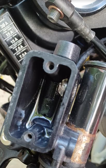

    I then extracted all the fluid from the coffin so I could try and see what's going on behind the two tiny holes in the base of the coffin, when the lever is pulled. I can see movement - presumably the piston inside?

  3. If the master is full of fluid, it should produce bubbles from one of the holes when it is pumped, as the air in the line is replaced by fluid. I would close the bleed at the oberon initially to see if that helps get a bit of fluid going down the line.
    If it doesn't produce bubbles at all, your seals may need replacing, and I would imagine it's a PS13 master and you can get the parts for this still. You are seeing the piston through those holes. That's where the bubbles of air should come out. I suspect, if its an old master, that it needs a service kit. Not hard to replace and gives piece of mind, but try the above first.

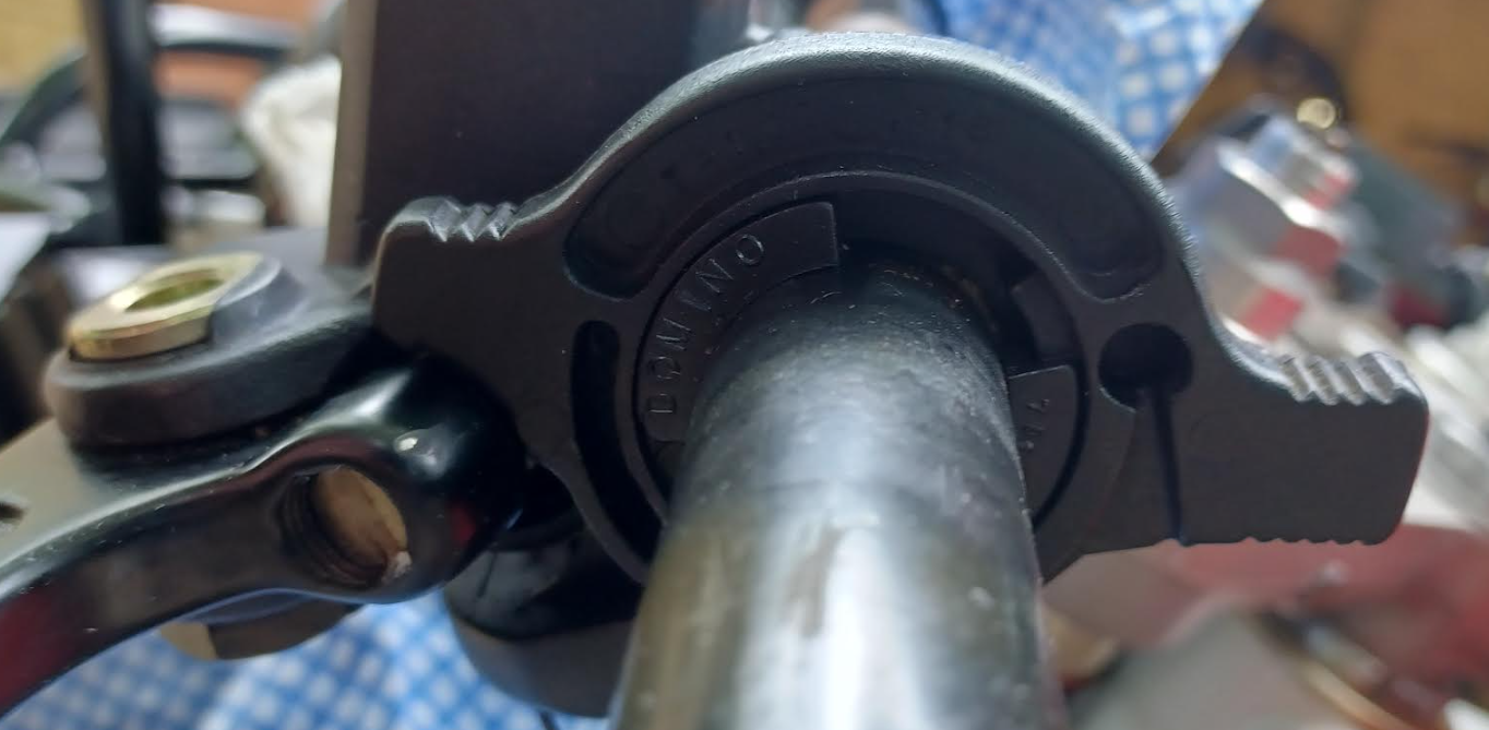

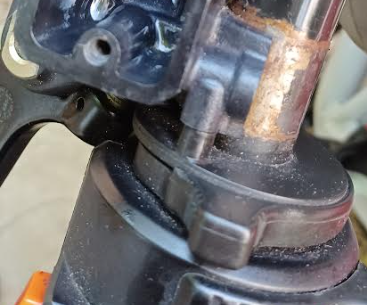

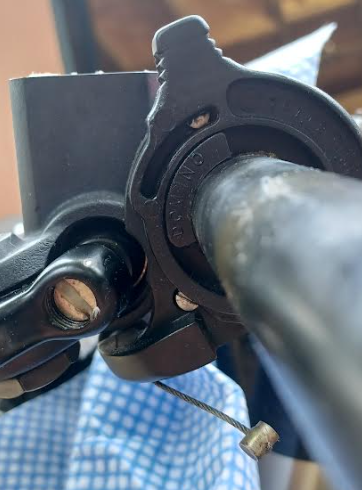

  11. The efforts continued. I primed the slave, which already seemed to be full of fluid anyway, but this didn't make any difference. Finally, in conclusion that the MC will need a service kit, I began the process of attempting to remove the lever and master assembly from the bars.
    Got the switchgear off and pulled the grip, which needs replacing anyway.
    I was then able to see the screws attaching the choke housing to the master. I was only able to unscrew one of these; the other just seems impossible to get at regardless of how far round the choke adjuster is moved. It seems like the adjuster part should possibly detach upon full rotation; maybe that is the key. But whatever I try, I can't access the other screw to remove the unit.

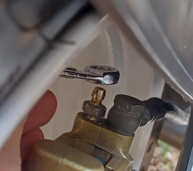

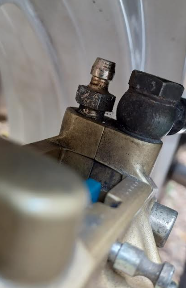

    Oh no you don't. The bleed nipple is 11mm but the open end of my 11mm spanner won't fit, and although the ring end would (having checked on a front brake nipple), the proximity of the hydraulic line doesn't allow space for a ring spanner. It doesn't seem like a brilliant design. Perhaps I have a bad spanner. Or perhaps I am just being thick.
  12. Most 11mm sockets with 1/4 drive are thin wall enough to fit and are a safer bet than an open ender regards rounding. But if you only have that combi 11mm and the open ender won’t fit maybe a brass wire brush of the nipple will help.
  13. If you’re going to bleed the system, why not undo the banjo, thus gaining full access to the bleed nipple? Tightening it up once bleeding is finished should be manageable with an open ended spanner
  14. And re-anneal (copper) or replace (steel) the banjo washers.
  15. Thinking back for access to screws the choke lever rotates and comes off, but possibly you might have to remove the clutch lever to get it to rotate enough.
