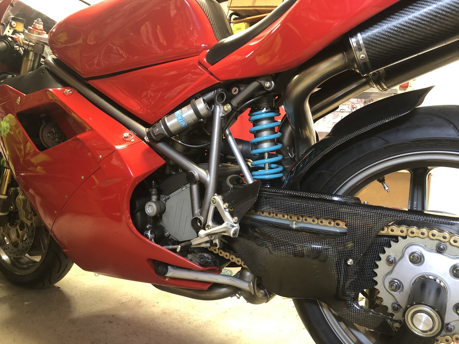

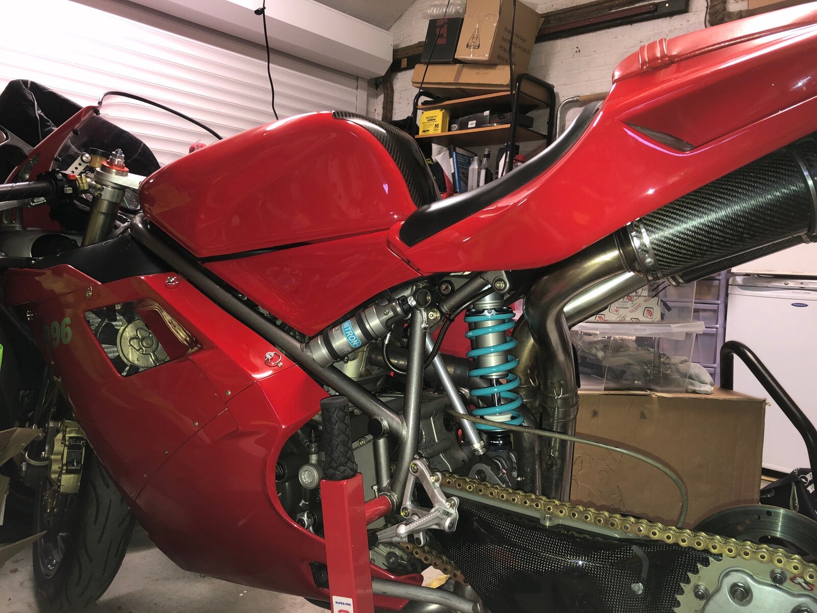

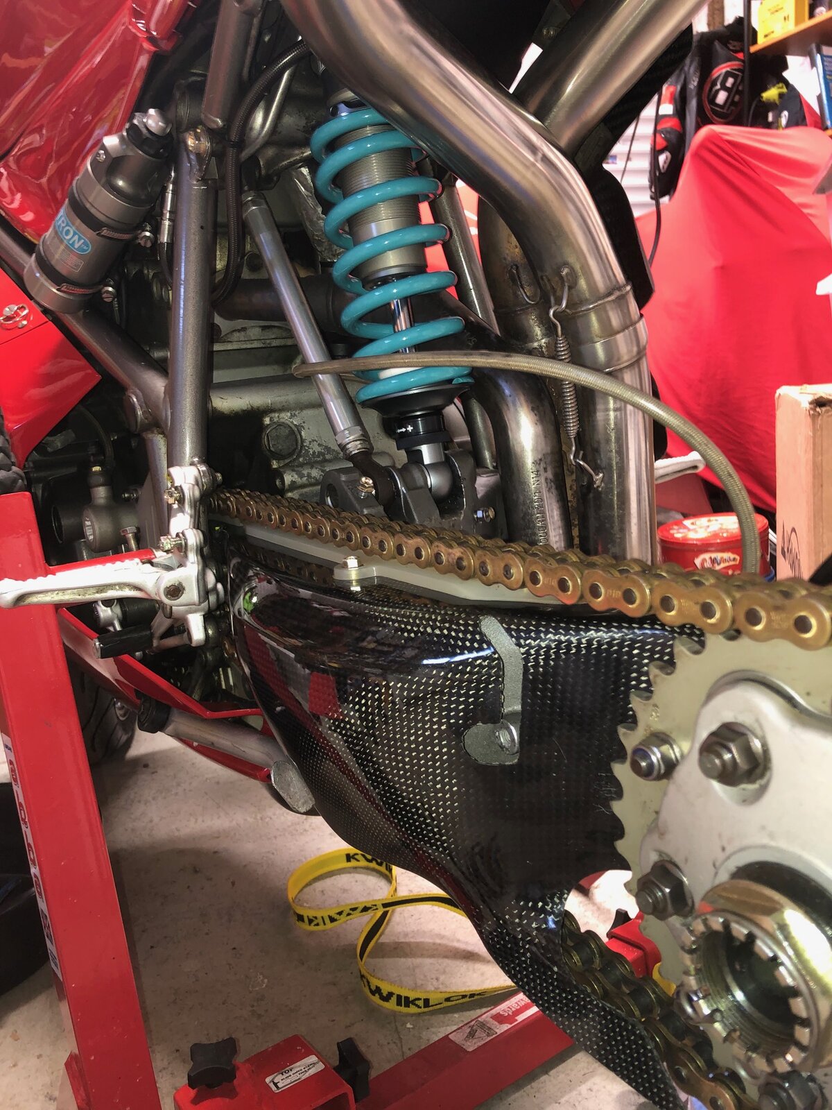

  1. Thought that the old rat bike needed a bit of TLC after its hard life, so scored a very cheap DP racing swing arm cover from eBay which, after a bit of work, has come up very nicely indeed (I think it might actually be a cover for the mag arm as it has previously been cut to fit the chainguard?). Will look nice and spangly once I get the back end all reassembled again with the CF hugger.
    Also, and much more importantly, fitted a new shock in anticipation of getting the bike on the track sometime this year (hopefully).
    Its a Nitron R3 which I ordered direct from Nitorn just over three weeks ago. Good to know that British industry is still functioning in these surreal times.
    Be very interested to hear from anyone who has fitted one of these before as I am considering mounting the remote reservoir under the seat? It is currently mounted where Nitron recommend.

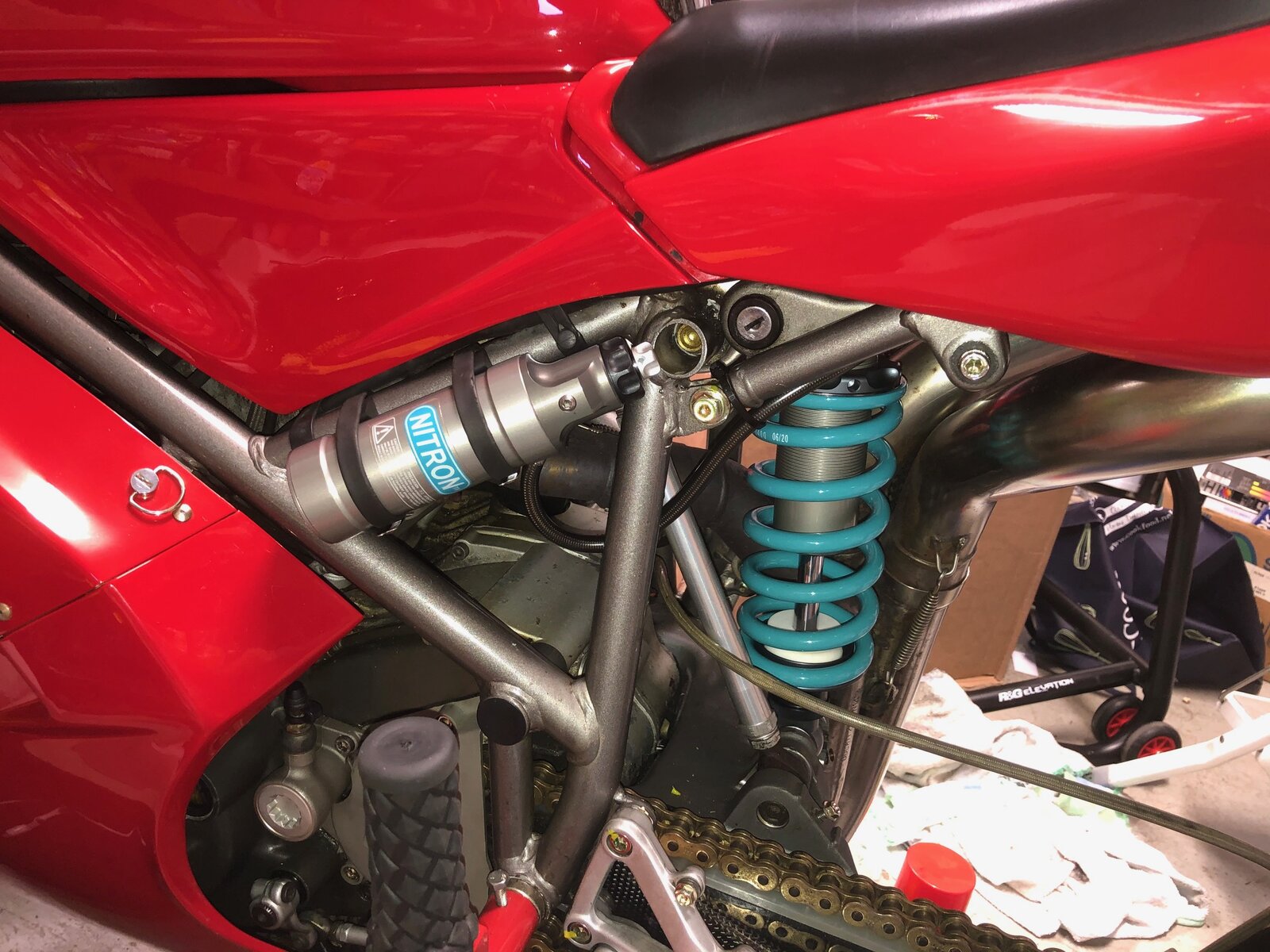

  5. Nice upgrade!
    I would leave it accessible until you have got the shock setup right for you on track at least.

  12. Back together again.
    Turned reservoir through 180 degrees as easier to adjust and less unnecessary cable slack.
    I’ve now also read the manual. The shock comes built with Nitron’s recommended preload, rebound, low and high speed compression for your weight and riding use. I checked the static sag and it’s pretty much bang on what they say it should be so that seems to check out. Just need to press gang a daughter for rider sag check.
    The canister position is growing on me and I also like the fact that the spring is fully exposed.
    CF now all back on. Bike ready for action which is frustrating as I’ve only ridden it once in freezing January. Might get it taxed and insured soon to start to test it out gently.
