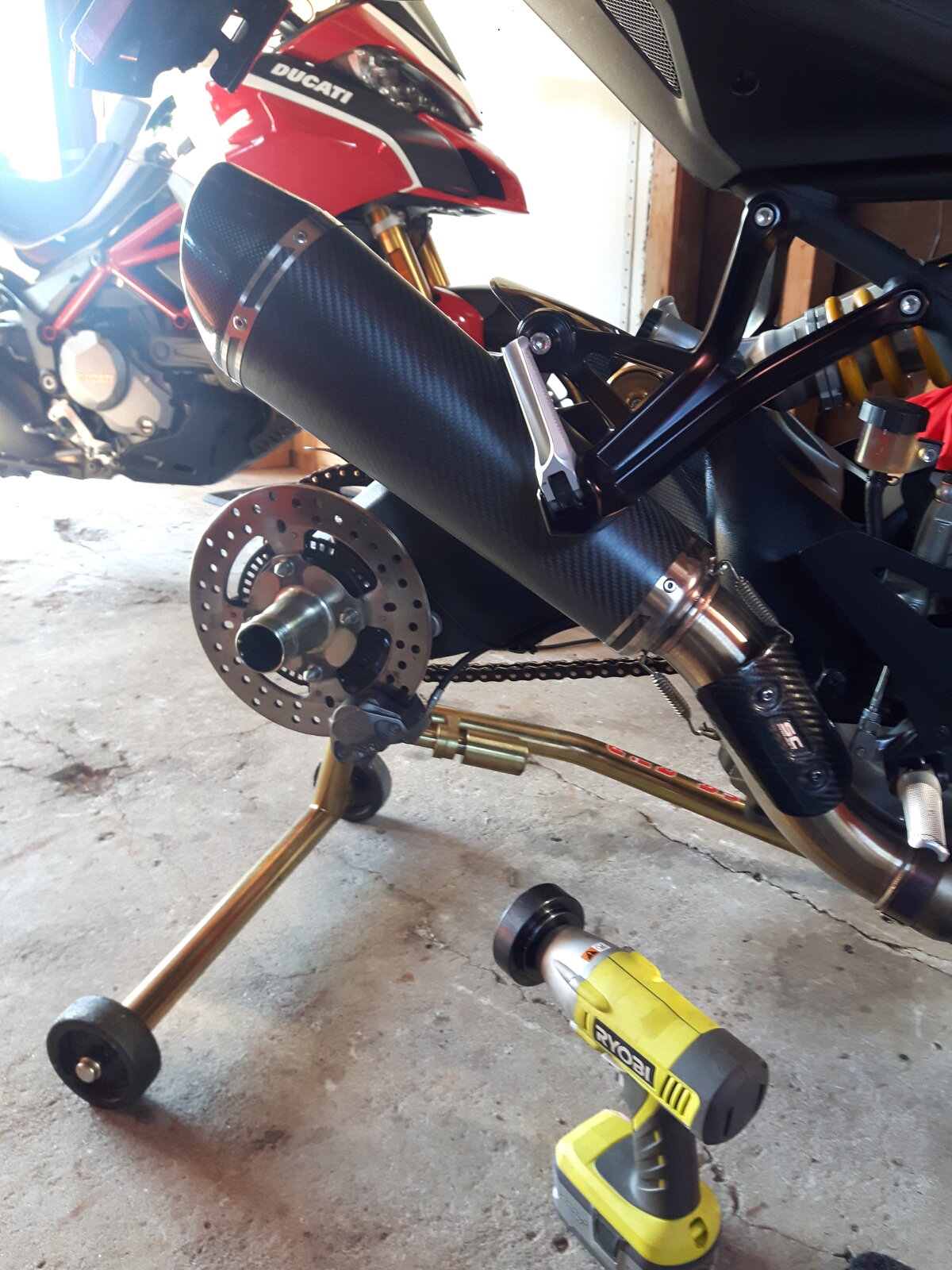

  5. My Ryobi impact wrench does the job at 230Nm but it takes it a minute or so. However, just a breaker bar should break it loose.
    Make sure the threads are clean and greased when you re-install.

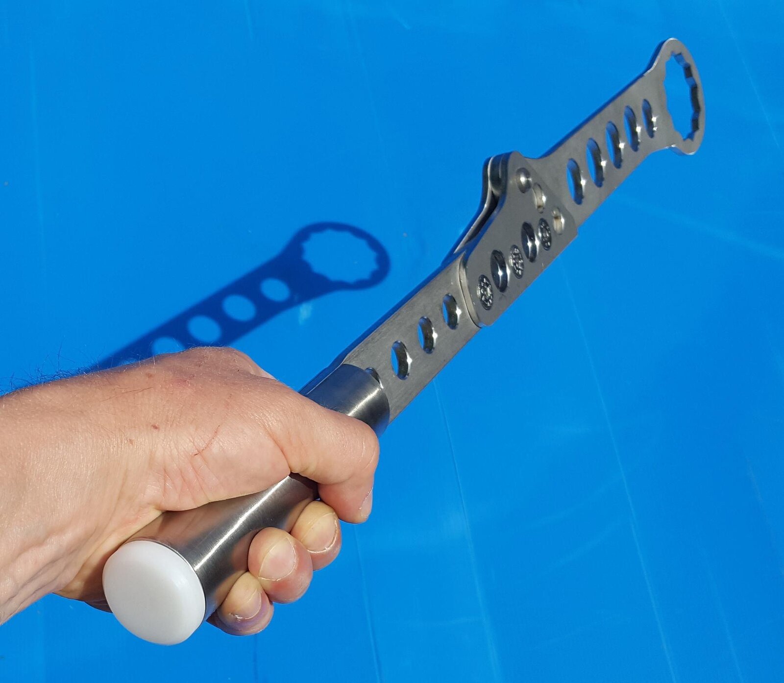

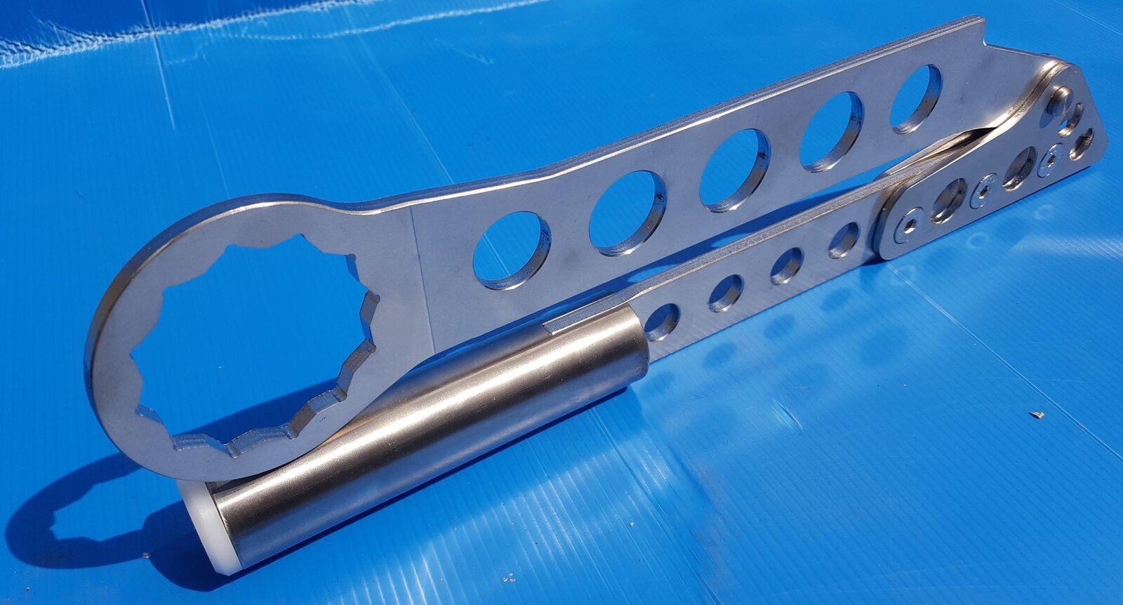

  6. The manual approach using my custom Uhr Tec wrench is yet to be defeated.:)
    ADF8AA04-7349-41A3-8449-E4FC04E30996.jpeg D47E585B-F0E4-49B7-B6E3-A161FE9C4DA7.jpeg

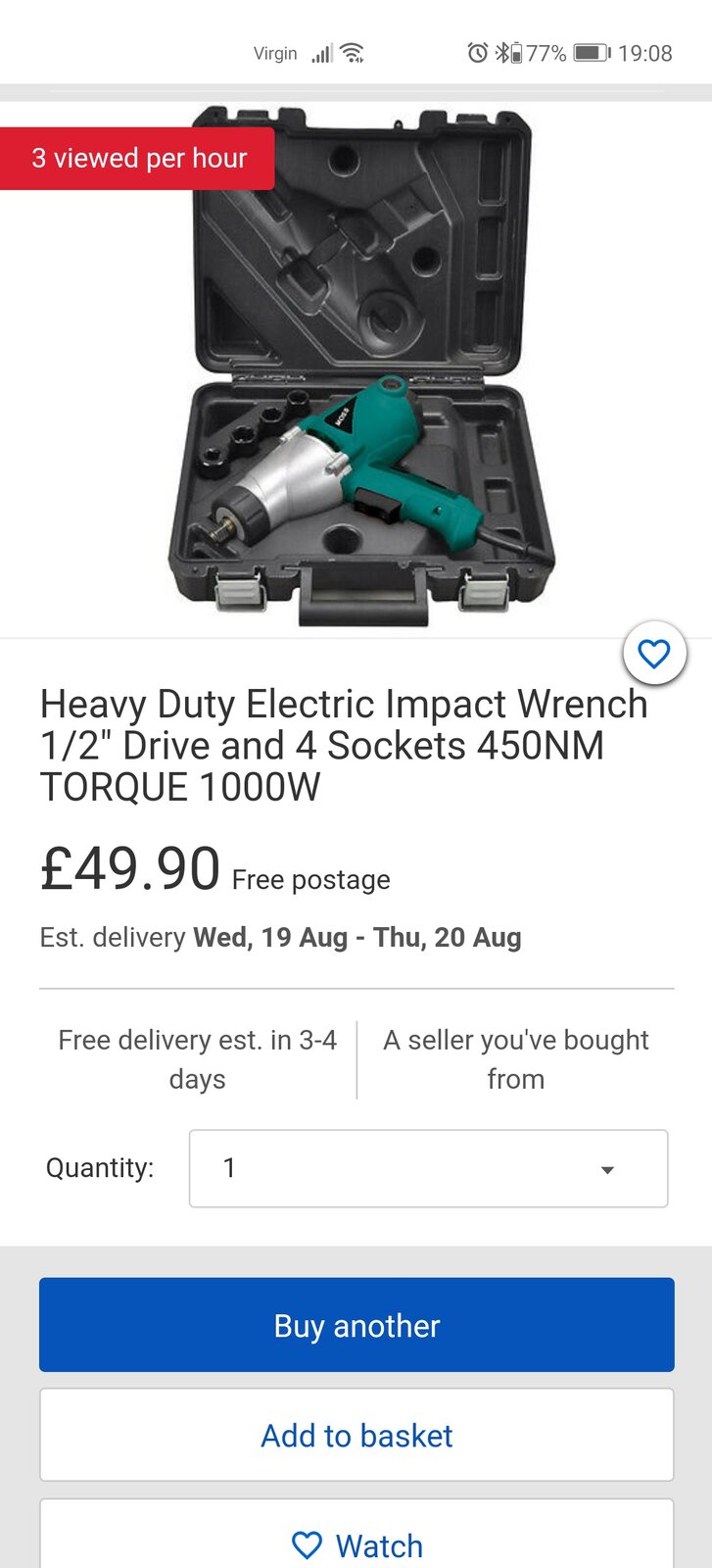

  11. Mine arrived about an hour ago. I made sure it works but haven't rattled off the big nut yet, as the thought occurs - I will then need to tighten it back up again lol. Gonna see a buddy of mine with a bike shop and check if he has a big feck-off torque wrench I can borrow :D
    ALTHOUGH, its not going back up to 230Nm ... It'll be tight and it'll be locked in place, but just not hernia tight ;)
